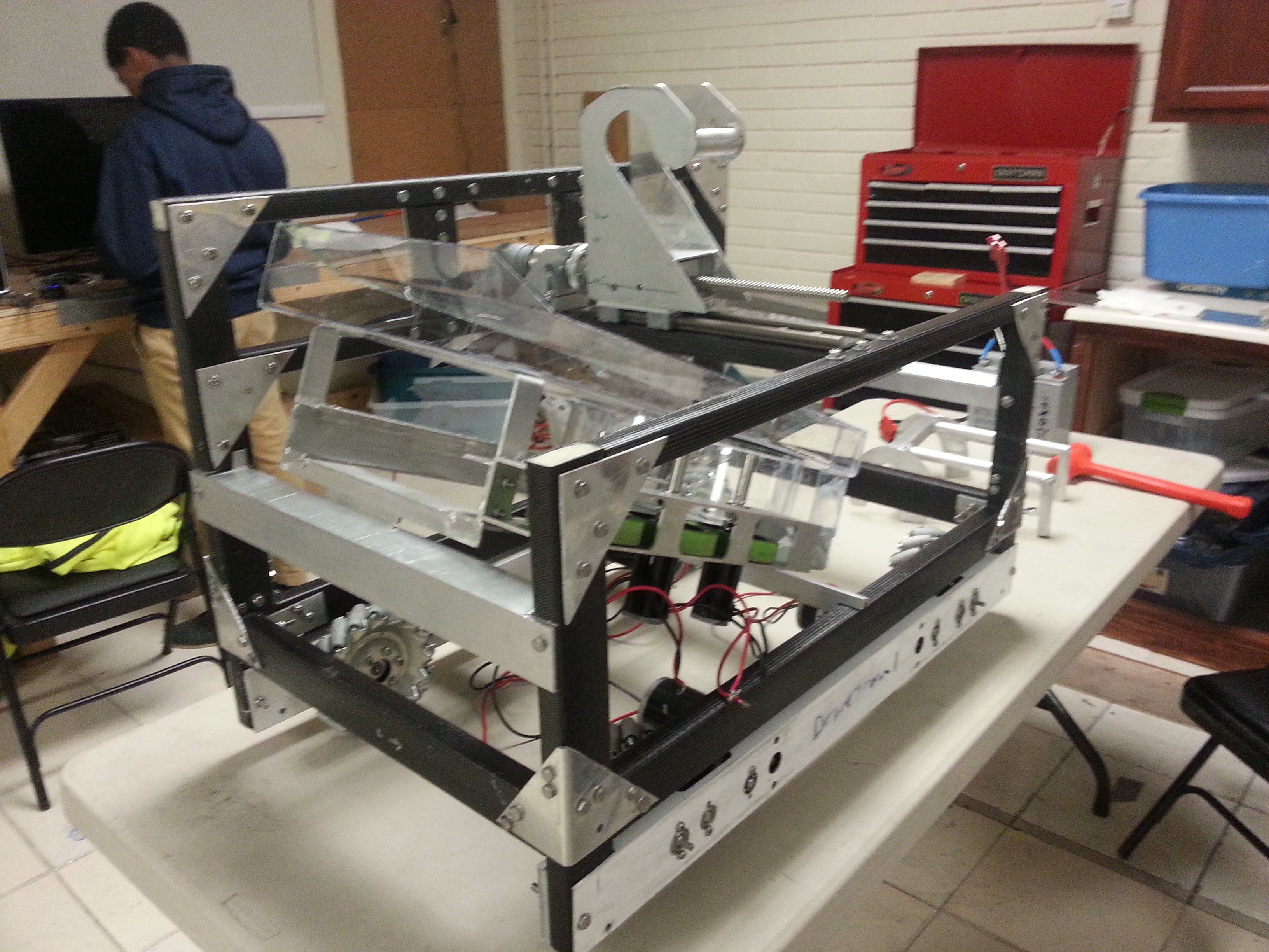

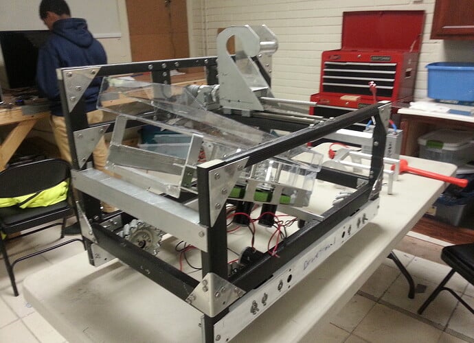

pic: Teamdrift 4091 carbon fiber chassis final build day 2
Electronic missing, 30 point (hopefully) climber on its way 49.99 pounds so far.
Hmm what’s that I see in there? :wink:
sorry but I dont understand, our shooter is not like yours. We are nort usng cims and you are not using our wheels so uhmmm
It appears you’re using 3 green banebots wheels. Maybe they’re different wheels, but the idea of using 3 is still present.
It would also appear, at least to me, that you’re using some CIM family motors in your shooter.
