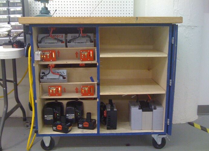

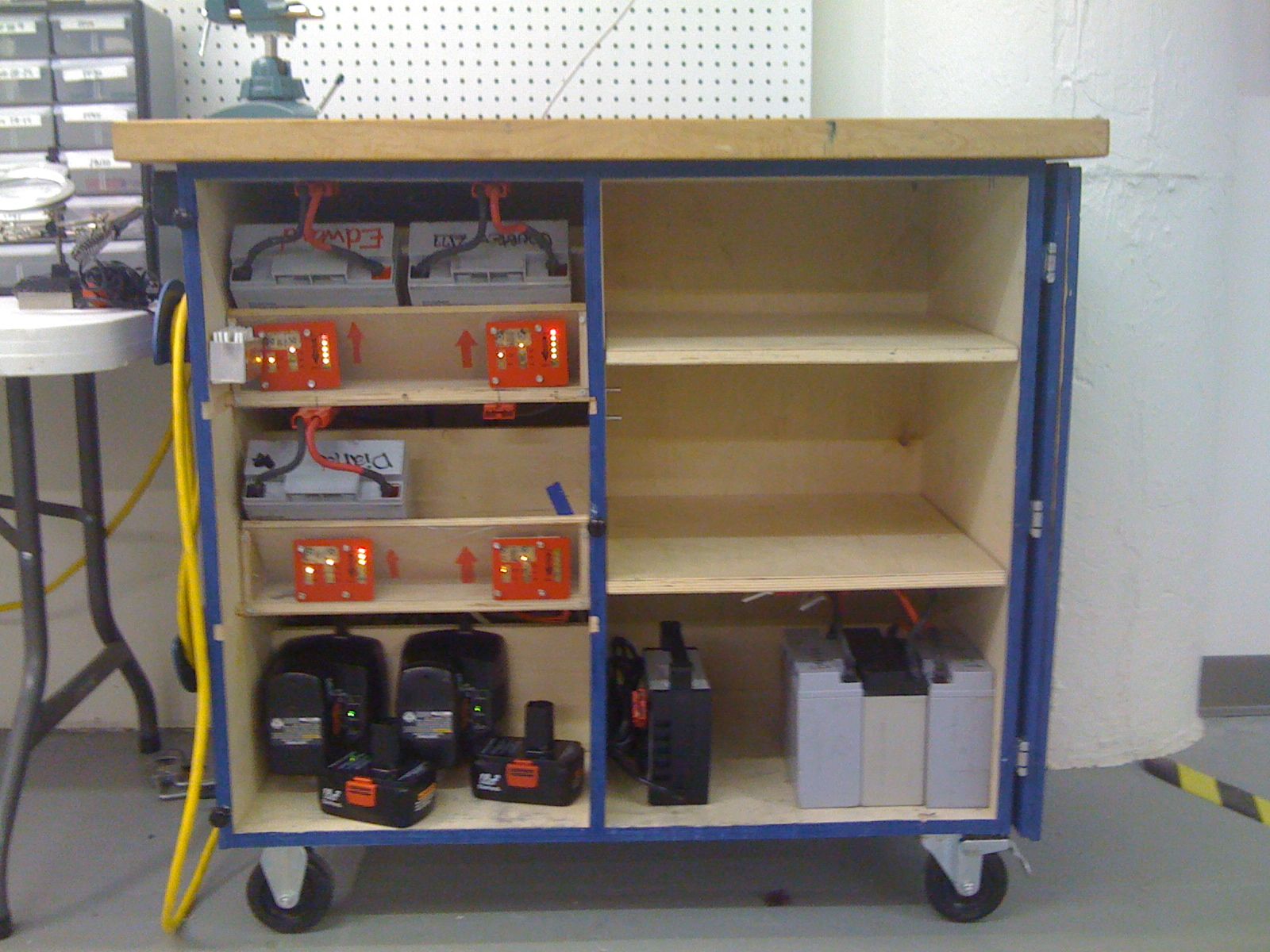

This is the battery charging station the team built last summer. It can charge 4 robot batteries at once, as well as two drill batteries. The shelves on the right are adjustable/removable, and provide general storage in the pits. The top is an old butcher’s block, with built in mounts for a vise. It’s built solidly enough to wail on if need be, with lockable caster wheels on the bottom that can easily survive most parking lots while being loaded/unloaded. The hinged door on the right closes to hold everything in while traveling.

Those don’t appear to be the exact kit chargers - can you provide a specific manufacturer and part number?
They look to me like they’re the front panels from the newer Shumacher chargers, just mounted upside down.
Nice :smiley:
actuality they are the kit chargers just dissembled
As Alan said, they are the newer kit chargers, by Schumacher. We found a set of 4 chargers on ebay pretty cheaply. Once opened up, there are two circuit boards connected by a (i think) 5 pin ribbon cable. One board does all of the “work”, while the other handles all of the control (switching between 2, 4, and 6 amp, and switching between 6 and 12 volts). We simply took the whole thing apart, added some extra wire to the ribbon cable, and mounted the front where you can see in this picture, and the back in a section behind the batteries - see http://www.chiefdelphi.com/media/photos/35787 for details.

can you add more information about the size of this cart?
I don’t have any spec’s here (and likely won’t be in the build space to measure for another month or two), but some general estimations:
  • Each side is approximately the same width as two batteries, making the total width about that of 5 batteries (when you include the wood and the overhang from the work surface)
  • Its depth is probably about two battery widths - as you can see from the picture, it’s about the same width as the table next to it.
  • Its height is about a foot higher than the standard folding table next to it - about waist height to provide a good working surface while standing in the pit.
Overall, the footprint is a little bigger than half a standard folding table, while being a little higher for comfort while standing.
Keep in mind that we more or less eyeballed it while building. The work surface came first (an old butchers block), and the rest was designed as we went around that and the requirements for the batteries.
