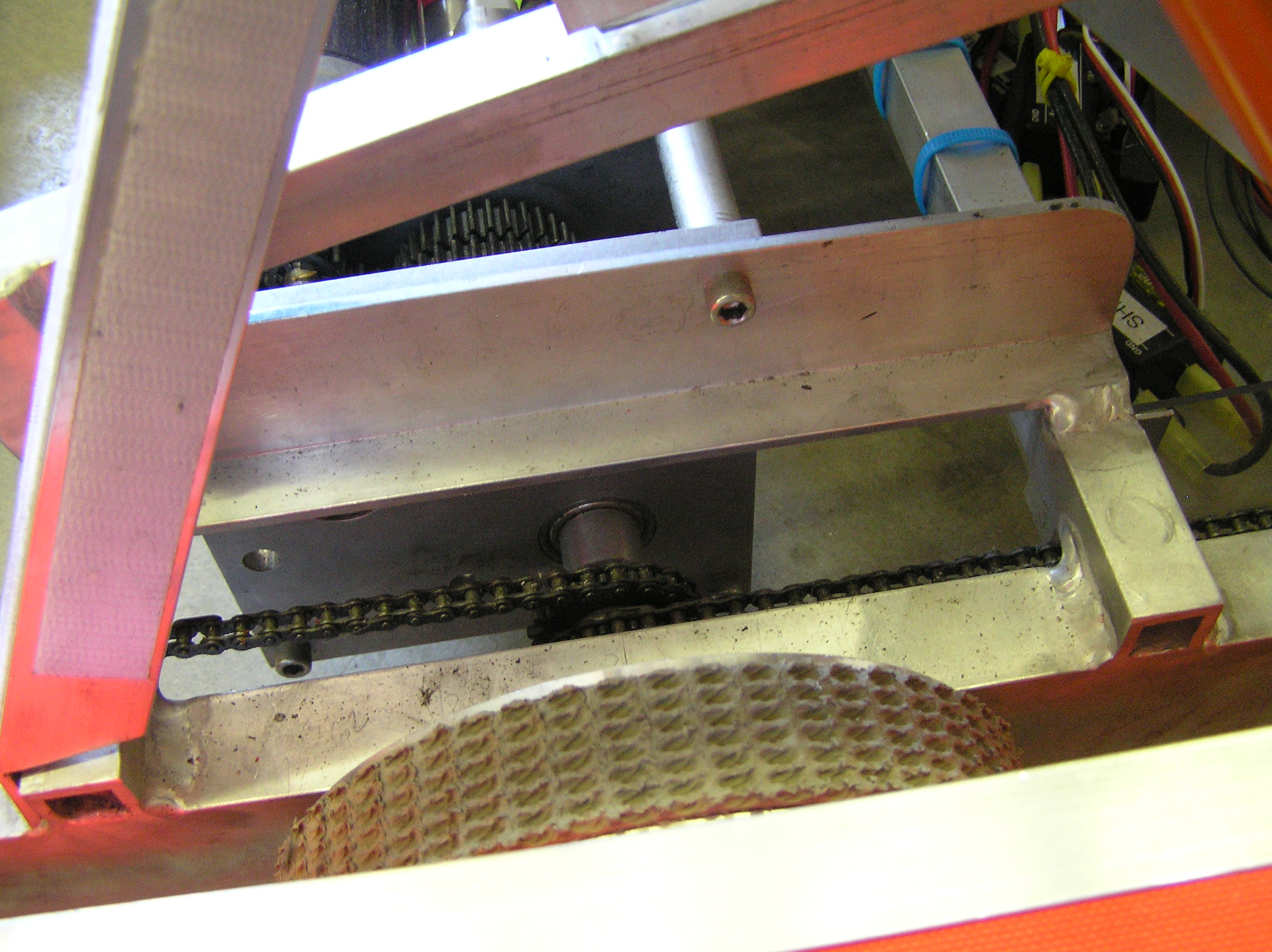

pic: West Coast SS mounting 2
Two 3/4" cross members were welded to the top of the 2x1, and a piece of angle with a hole pattern for the AM SS was welded on top of that.
