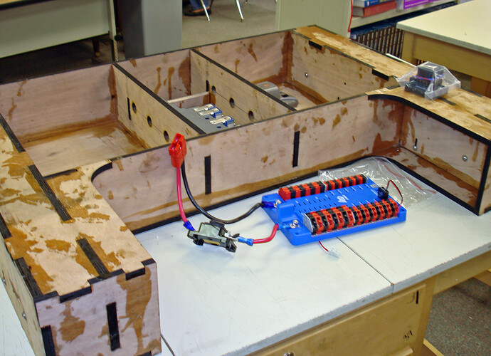

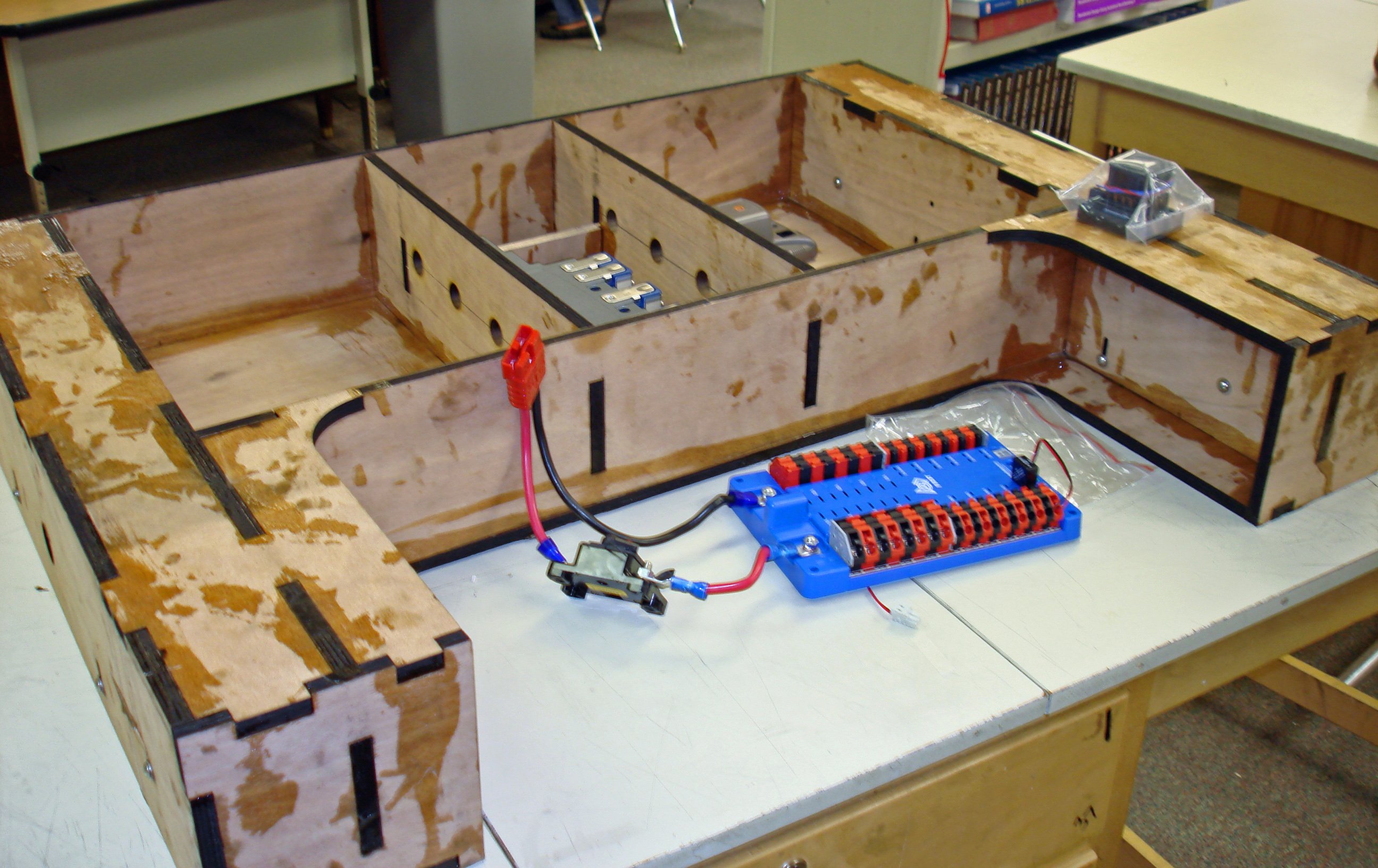

pic: What are we up to? FRC1771
This is what we have been up to for this year. The base is entirely constructed of 12mm okoume plywood that has been laser cut. The entire frame with axles weighs 18lbs.

Thanks everyone. I kinda left off the specs so here goes:
-6wd with a dropped center wheel and the center wheel is directly driven off of highly modified tough boxes
-The frame was designed so that everything was aligned by tabs for easy assembly and boat building epoxy was used
-This frame is much stiffer than our custom 1/4" thick aluminum frame last year for an approximately 10lb weight savings.
As for whats going on top, it is eerily similar to what you guys have already posted up with a few differences. Mainly we will be able to shoot downwards at a 40 degree angle without reducing the speed of our shooter. Hopefully everything comes together

That is very nice! I really like how it’s self tabbing. Got a team full of model airplane builders or welding guys?
Haha it would seem like that wouldn’t it. No actually I came up with the idea and I have been refining it this past offseason, but I never thought we would actually build a wood frame since it is kinda unconventional. However, the team really embraced the idea and I think it will pay off big time.

What’s the glue you’re using? Those spots remind me too much of cyanoacrylite (CA)… Then again, I’ve been helping build an R/C airplane.
We are using MAS brand epoxy. It is a very strong slow cure epoxy used in boat building. One of our students got a bit carried away with the epoxy on the top. i kinda think it looks cool though. Other than the smell, this epoxy is incredible.

It would definitely float. We have built it very similarly to the way you would build a wooden boat. We use no screws or nails and only the epoxy to hold it together.

As a wood worker I was wondering how you made those cuts until I read the caption. A laser almost seems like cheating, but thats just myjealousy of not having one:D .
Believe me…sometimes having the laser I feel like we are cheating too. We were the first people to try lasercutting okoume so it was a bit of a mystery as to how it would work. Luckily it came out beautifully and everything fits together like a puzzle. I really don’t see much reason for a wood frame after building this one. It is stronger in every way except for gouging resistance but thats not an issue with bumpers.
