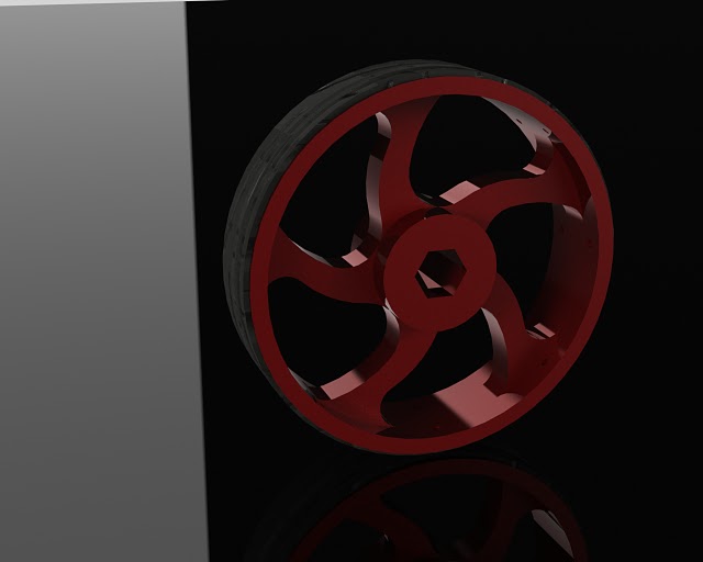

pic: Wheel 4 V1.2
Wheel idea 4 Version 1.2
Mass - .29 lbs.
Wheel Diameter - 4 inches
Spoke Depth - .45 inches (I think. I’ll check when I get home.)
Spoke Thickness - .5 inches (Again. I’ll double check it. )
All thoughts are welcome.
Ok. I do apologize. I had some of the measurements off.
Spoke Depth - .375 inches
Spoke Thickness (Bottom) - .275 inches
Spoke Thickness (Top) - .15 inches
(Neither of those include the fillet.)
Your spokes seem too thick, IMO. You ought to be able to pull off at least .25" thick.

What’s the size of the hex?

The radius of the hex is .5 inches. Same as Andy Mark. I know. Looks big to me as well.
OK, be careful with this. If the wheels will be used in a swerve/crab application on carpet and your wheels will have a decent CoF, the spokes need to be beefier than you think.
Just to reiterate what Raul is saying here…
If you are using solidworks or inventor you have built in tools that allow you to do some quick FEA on your wheel. Instead of guessing at something being too beefy or not beefy enough, why not do some analysis?
For starters when it comes to wheels I do this:
Knowing that a wheel can only exert a certain amount of force on the ground and vice versa we can use the coefficient of friction with the wheel and ground as a starting point. The wheel will be under the most load when it is being pushed sideways along the carpet RIGHT before it loses traction with the ground. So estimate the weight of the robot and determine the normal force on one wheel. Then you will be able to determine the frictional force acting on your wheel. Use this as a baseline (ie safety factor = 1). You can then put this exact force on your wheel in Solidworks Simulation (or some other FEA software). Support the wheel right where the shaft would be and start your analysis. You are definitely going to want to bump the safety factor for a FIRST robot, and especially since this is just a rough calculation. To do that just multiply your frictional force by 3, 4 or 5 or whatever you want. Look at your stresses, compare them to the yield stress of the material you are using. Look at your deflections, make sure they seem reasonable (ie not half an inch or something like that, you want to be in the couple of thousandths range). Look at your stress concentrations and see if there is some simple geometry fixes you may be able to incorporate to alleviate them.

I second Brandon’s suggestion. Additionally, be careful when looking at the visual representation of the deflected model. The deflections illustrated are typically exaggerated to make them more easily identified, so be sure to look at the numbers provided instead.
I wish I could make this bolder. Trusting your intuition only works as well as the human brain. Numbers and raw data are far more effective.
Cough. It’s possible to pull off some VERY light wheels while still maintaining plenty of strength. Those are 1/4" Thick spokes, two 1/4"x1/4" bar per spoke area. In the bottom wheel, the ends are radiused for extra strength (and style).

Back on target. I honestly have no idea as to how to use the stress analysis. I know what buttons to press. Just not how they should be pressed. If that makes sense…
Yes it is possible, but I would like to leave VERY light for a later date. For now I would like to stick with getting at least one wheel out that weighs less than .35 pounds. If I can do that I’m happy. :smiley:
I believe it’s side loads that Raul was worried about. Your extra strength radius doesn’t seem to address that.
Erm, yes it does. Please examine the lower wheel closer. The wheels were “dished” out by a .5" radiused end mill, in order to increased the side load ability of each wheel.
It’s possible that I’m not seeing something in the picture that you know is there. The extra widening on the ends of the spokes would seem to be helpful only in the normal direction of travel of the wheel. To be stronger in the sideways direction, the spoke would need to be thicker where it meets the hub.

Craig is talking about the wheels his team built I believe 2 seasons ago that he linked to on this thread. Those wheels have a .5" radius where the spokes meet the rim. This absolutely strengthens the wheel in side impacts and can be verified by a quick FEA analysis. Adding this inner radius is a simple way to increase wheel strength without much extra work.
Completely correct. My machinist was also able to use a single tool for the majority of the job, which greatly sped the process up.

Alan was correct, in that the small radius there doesn’t really solve the problem Raul stated. If your spoke is too thing to handle the side load, a small radius really isn’t going to fix the problem; and if that little bit makes the difference, your factor of safety is too low.

Second. His radii may help, but you are correct; they do not address the problem that Raul presented. It’s because of the side forces that the wheel would have on it that I will not be making the wheel depth any smaller.

In 2008 we got ‘too greedy’ with our wheel design and made the spokes way too thin. I think each spoke was something like .167" thick.
While practicing between LA and Atlanta, our driver turned a corner and something shinny rolled off our robot. After finishing the lap I went to go an examine what came off our robot, only to find that the wheel hub was still on the robot, but the rest of the wheel was gone.
After looking at the rest of the wheels, I found that others were starting to fatigue as can be seen in this photo.
The problem was caused by side loading and how thin our cross sectional area was. When we were doing our pre-fabrication analysis using Cosmos, we only checked the compression strength and ‘normal’ direction loading on the spokes. In both cases, the wheel had a factor of safety of >2. After we began breaking wheels I did another analysis on the effects of side loading and found that our FoS was <1.
If you look at the picture I linked, all the wheels broke at almost exactly the same spot, which also happened to be the smallest cross section of the spoke.
For Atlanta, we made a new set of wheels that had a thicker spoke and took the weight hit since we had 8+ lbs to work with.
Yes, weight is an important factor, but you don’t want to under-build your wheels and have them break in the middle of competition. There are other places you can save weight with out sacrificing the structural integrity of your wheels.
Alan is right, where the radii are at now only help in the ‘normal’ direction. When it comes to side loading, they don’t do anything.

Yes, radii such as those are good, we do them on our wheels; they can be machined easily with a ball end mill. They certainly help make the part stronger and reduce failure at that joint. However, you can see in the picture’s Jon linked that they had a radius, and thin spokes can still fail.
Raul was making a valid point, analyze what kinds of forces are on your wheels before you lighten the heck out of them. No one can say “1/4” thick spokes are strong enough" without knowing the floor surface, wheel tread, drive type, etc.

I honestly have no idea how to use the stress analysis on SolidWorks. Would anyone mind either looking over it for me or giving me a detailed walk through? Also. If I were to add the radii, what degree of a fillet should I put on them?
-Rion
Go to the tutorials under the Help menu; you can learn how to do simple normal and shear stress tests in under ten minutes.
