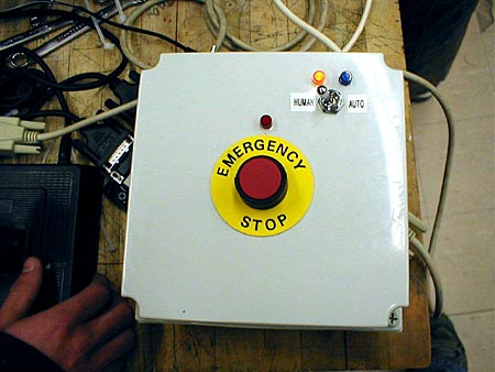

It is impossible to tell you what is wrong with the details given.
What types of switches are you using, and how are they connected to the RC?
Does the box you made pinout with a multimeter the way that you think it should?
Does a debug statement showing the states of the switches show what you expect.
What code are you using to try to switch programs?
Answer those, and people here will be much better able to help you.
-They are 2 position switches, on and off. Each switch has one connection to a digital input pin and the other goes to a common digital input ground.
-This was tried, everything worked as it should
-I have no idea how debug works
-I was hoping a simple IF THEN in the autonomous section of code would perform this task

[edit]Forgot to upload that pic of my dongle… apparently you can’t upload attachments to a attachmentless post when editing it… glare at Brandon)
