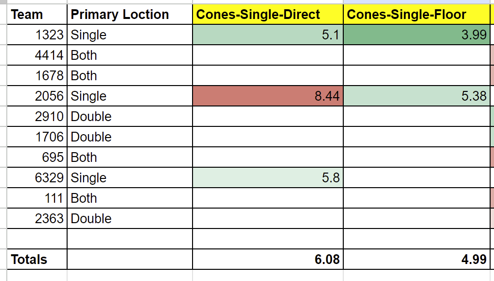

How big is this difference, really? In the thread about the WCP Competitive Concept, RC said the following:
And indeed, it does seem to human load pretty fast: https://youtu.be/TKs_UDj4Ej0?si=1YpRAZsns3NDBCCD&t=29
Do you have an example of a ground pickup cycle quicker than this, or are those pickups still in development at this point in the season?
I don’t think it’s a massive deal breaker type thing, but picking up from the floor was faster than doing the ‘baby bird’ at the single station last season.

Here some of the data I collected after like week 2 last year.

I was trying to illustrate that human loading can be relatively fast, so it could be worth going for if your ground pickup works for auto but is still slow. There are many reasons this could be the case, the most basic ones being that you decided to go simple with your ground pickup, or that you haven’t mastered picking up things with the sight line being all the way across the field.
