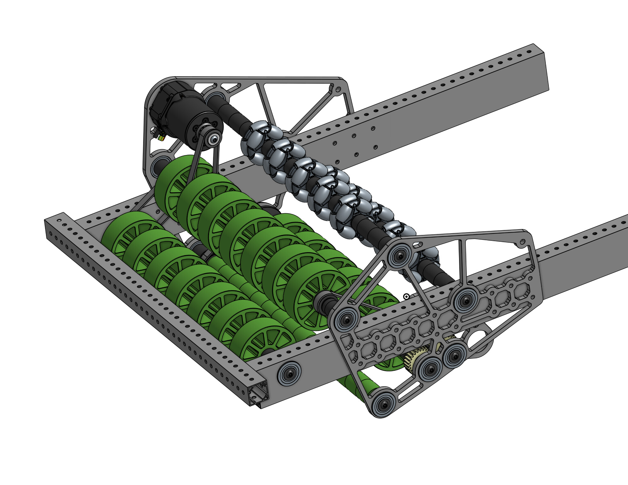

Look at the under the bumper intake in our thread for some inspiration:
You’ll have to chance some dimentions but overall an under the bumper for this should end up being smaller and easier to build because it can compress so much.
