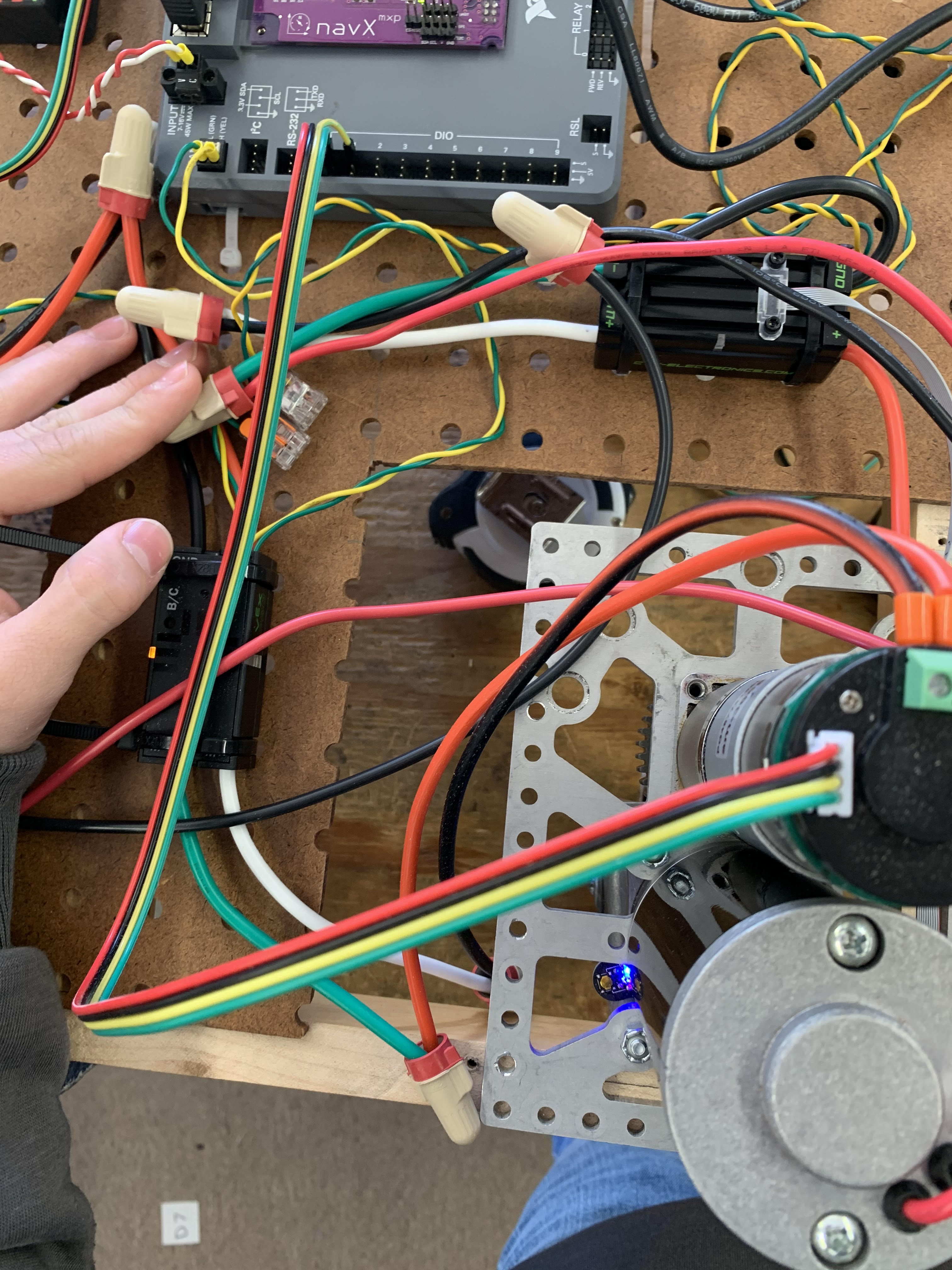

My team is working on swerve drive and for the turning we decided to use the PID system along with encoders to tell the turning motor where to turn. I have printed both the SetPoint and the Encoder values to the Dashboard. Both are printing the correct values. We are using the DIO ports on the RoboRio for our encoders. My question is how can get the SetPoint value to actually be written to the motor? (Don’t mind the horrible wiring…still developing the electronics board)Thanks in advance.
