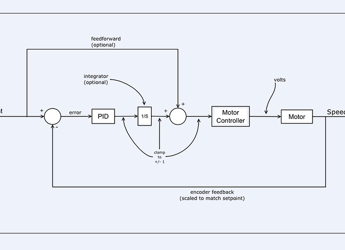

hey there. we’re having some issues with out PID speed controller. we are working on setting the appropriate P value, and things are just not working. does anyone have any ball park estimates for the values?

you need to scale the encoder signal so that it corresponds to the setpoint. otherwise the PID cannot form a proper error signal.

SetDistancePerPulse() so that a call to GetRate() returns +1 when the speed is what you expect to get when setpoint is +1.

hey. thank you so much. i found the correct number for that now. it was 1/2000 which was the reciprical of the max speed. now we have the issue in which the P value seems to be a scaler for the jaguar, as opposed to a proportional controler. as we increse P, the target speed seems to incress. any ideas?

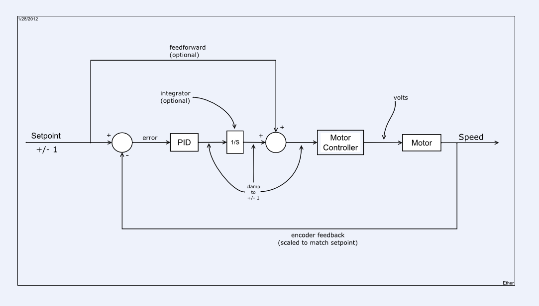

Instead of sending the PID output directly to the Jaguar, you want to intercept it, process it, and send the processed value to the Jaguar.
So if you want to add feedforward, you’d do something like this:
processed_output = PIDoutput+feedforward;
if (processed_output>1) processed_output=1;
else if (processed_output<-1) processed_output=-1;
… then send processed_output to the Jaguar.
If you want to integrate the PID output, you’d do something like this:
processed_output += K*PIDoutput;
