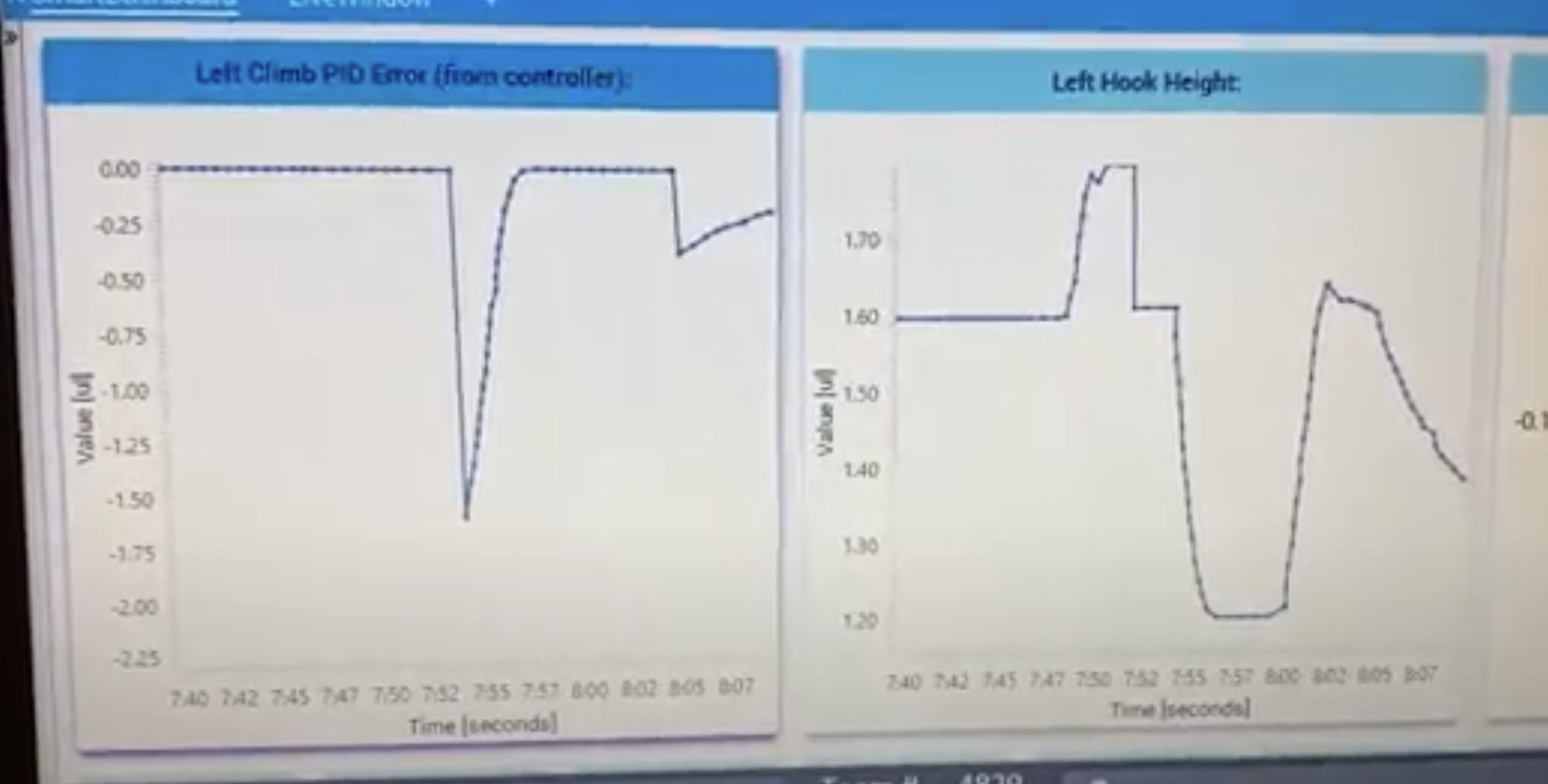

Hello. Thank you for your quick response. To test (maybe a bad idea) we made a separate robot project to test the code to eliminate things that might be causing it to go wrong. The same thing happens in both projects.
In the separate project we have buttons to reset the encoder pos (at the top) and a button to set the position to half height.
The values of the estimates were gotten from resetting the encoders at the top, and running them down.
Can you post a graph showing target height, current height, and error?
https://drive.google.com/file/d/1k1HIA6wD7jHBDiYHlF75RcsZUDxEUlef/view?usp=drivesdk
Thanks! This is nice, but it’s still a little hard for me to tell what heights are being set here, and which command they’re using.
Because you’re using a profiled PID controller, you’re setting a goal, and then the setpoint is moving towards that goal, subject to constraints. This means that your feedforward calculate should be using getSetpoint instead of getGoal. (See Combining Motion Profiling and PID Control with ProfiledPIDController.) Also, note that getPositionError is based on the setpoint, not the goal, so you’d expect it to be nearer zero than the goal error. It would be helpful to add both the setpoint and goal on the same graph so we can see more clearly what is going on.
One other thing I notice is that, in ClimbCommand, you’re calling ClimbSetPos with ClimbConstants.kSecondBarPos, which is set to 471289, which I think would get you past the International Space Station.
