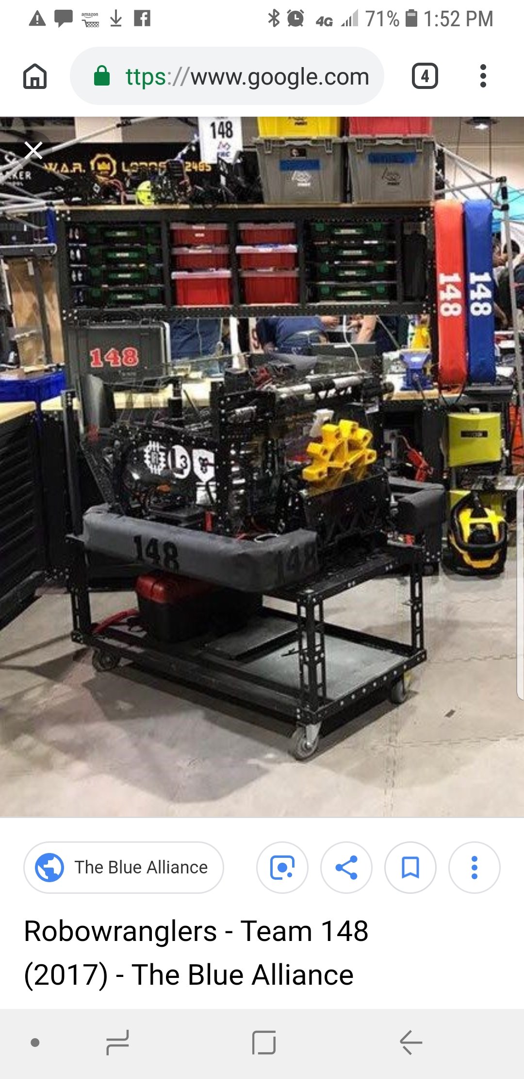

If y’all really want to have cool bumpers with a team logo, consider making a set of what are often referred to as “vanity” bumpers. My team makes them most years. They can be out of any fabric and have whatever logos or words you want (without being edgy I suppose). Other teams that do them include 118 and 148, personally I love the black on black look that 148 does.

Please note that the vanity bumpers or show bumpers are typically use for display or demos, not competition.
