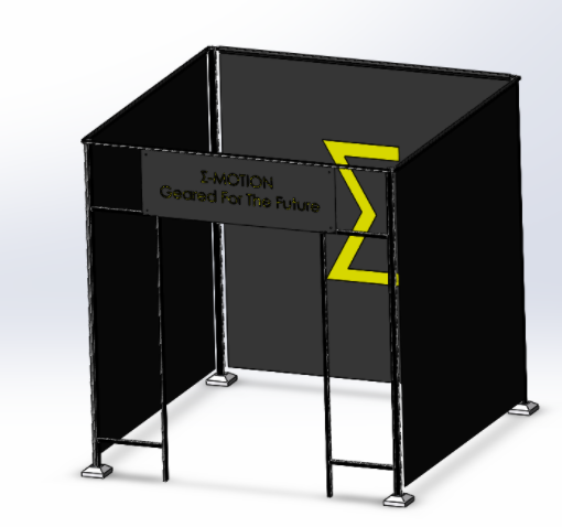

I have started CADing our pit, and I can link it in the thread below. If anyone has any advice or pit examples, it would be greatly appreciated. I have read many many threads, but if there was one that already exists that addresses these questions or one I over-looked, please feel free to let me know.

Work in progress using extrusion. It may or may not be a good fit for your team, nor is it perfected in CAD, but it’s something.

I like the idea of a more closed off pit. What material would you use for the walls?

That CAD looks sweet!!

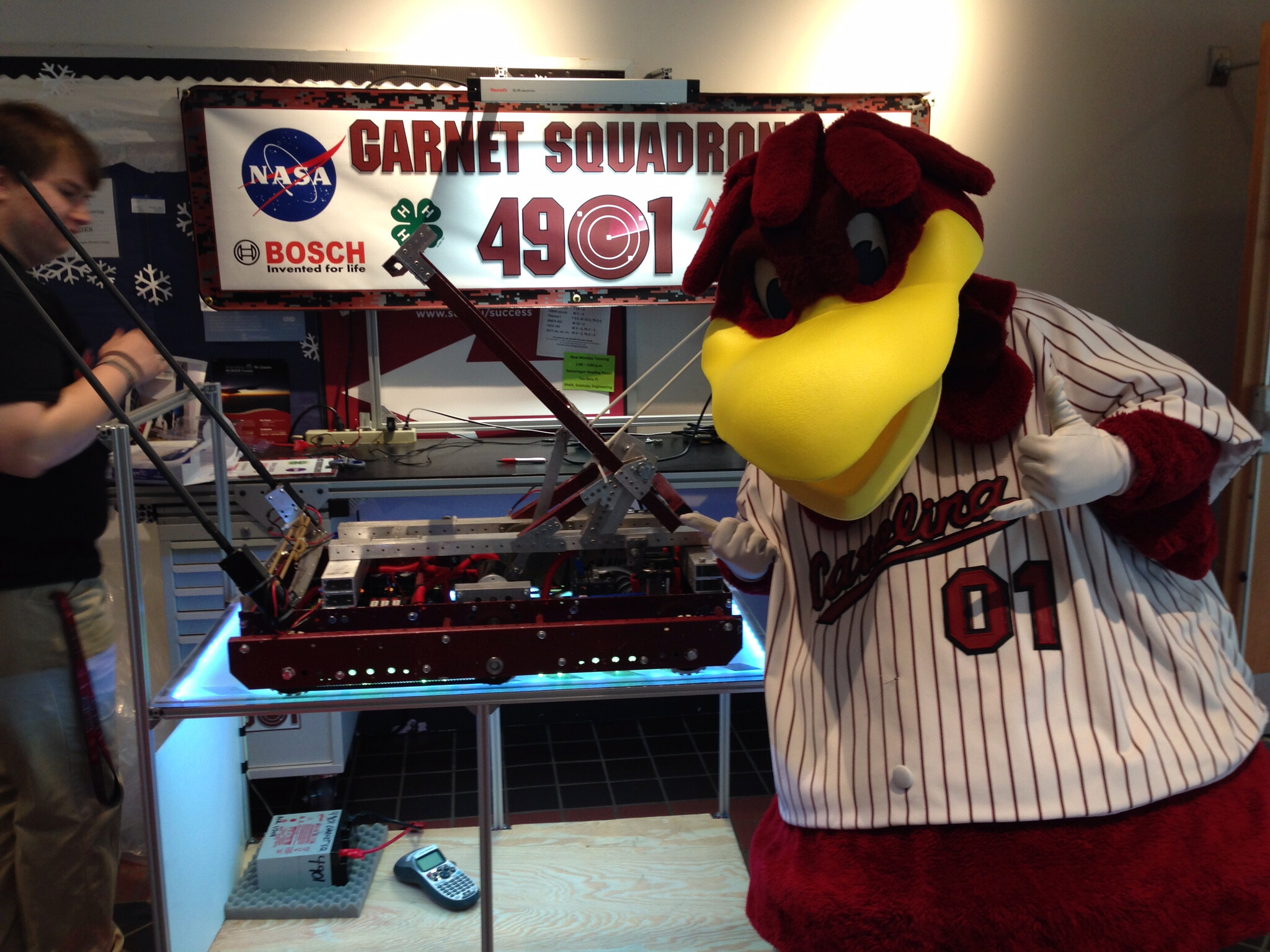

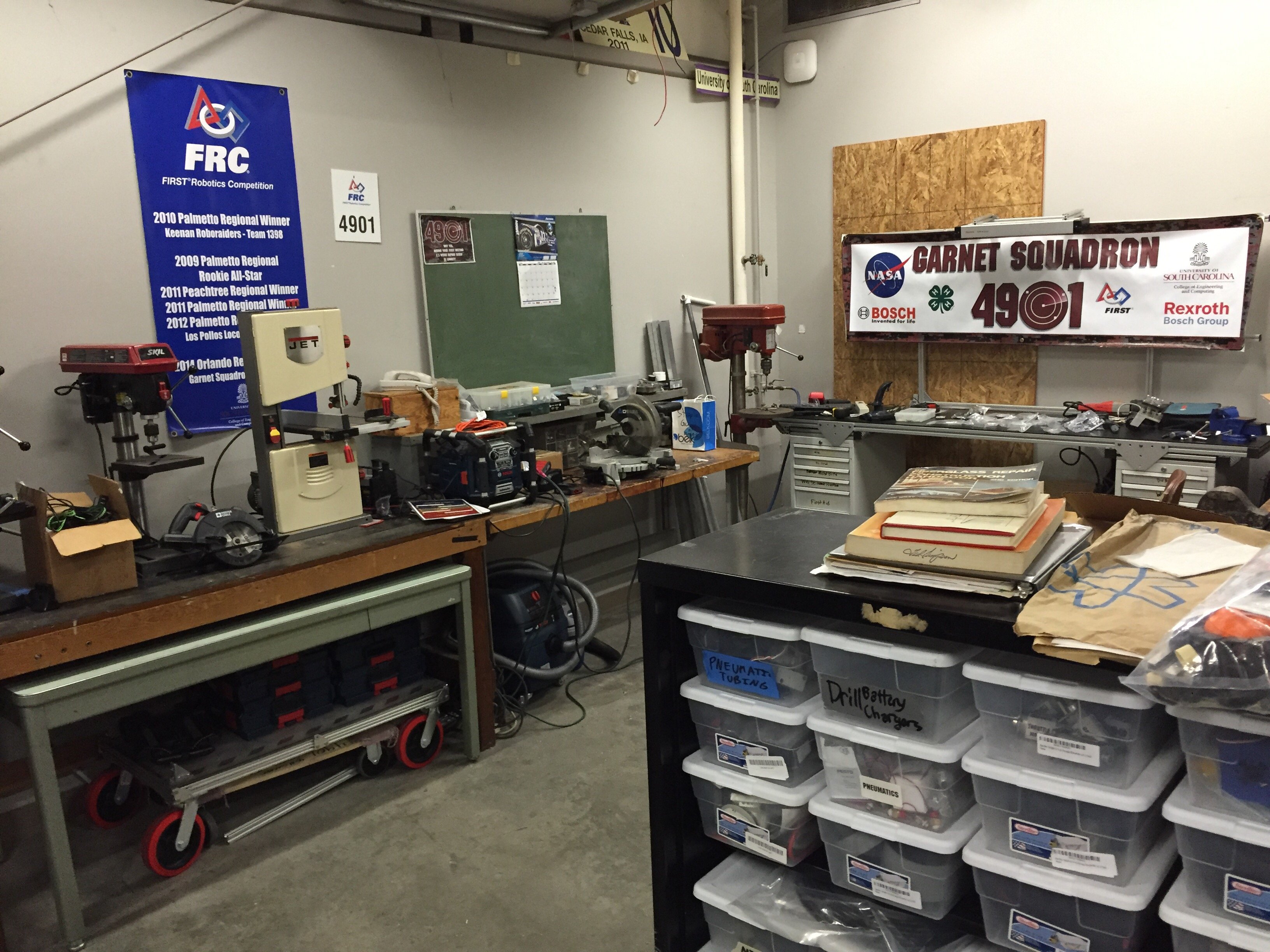

But if a trailer is nowhere in your future, 4901 used to have a pit setup built around Bosch FMS extruded aluminum and two smaller upright toolboxes that Bosch offered. You can see it in the back of this picture:
And another view, partially obscured by the robot and Cocky:
When transported, the rear banner mount would pop off, the black tabletop would lift off, and the toolboxes rolled independently once freed of the tabletop (which had bars under the work surface to keep everything constrained while set up).
We fit the whole thing under a charter bus a couple times, and we once managed to fit all of our stuff and 1772’s stuff in a U-Haul trailer. If I can’t just roll it all onto a trailer straight up, that would be the way I’d go about it.

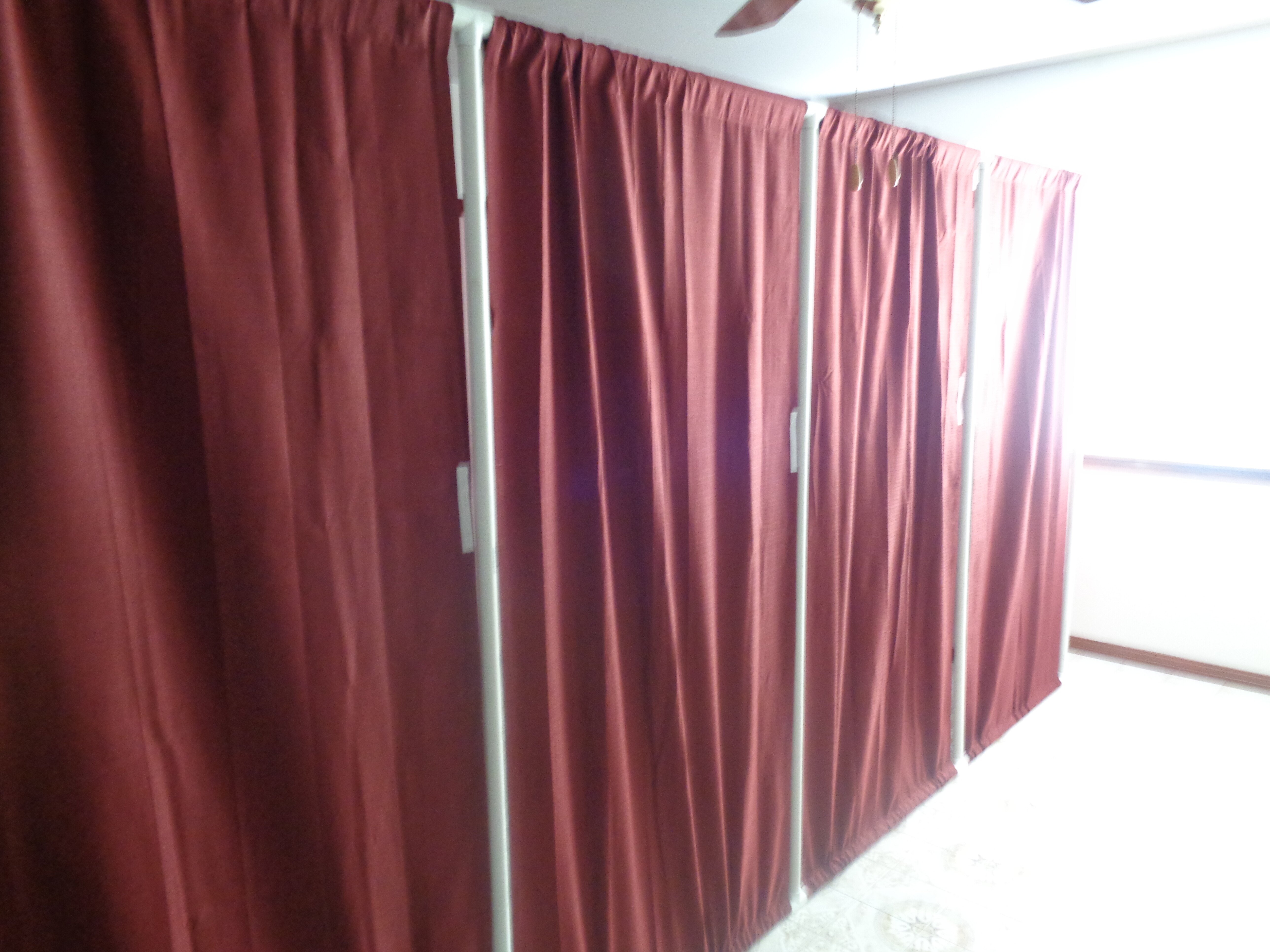

Outside of FRC, I have made some PVC-framed cubicles to serve as bedrooms for Family Promise, a “back on your feet” charity for homeless families. For those, I used blackout picture window curtains with pockets at both ends similar to this:
https://www.walmart.com/ip/Mainstays-4pc-Rod-Pocket-Curtain-Panel/361376660
We may have had to rip out some seams at the bottom to create a bottom pocket.

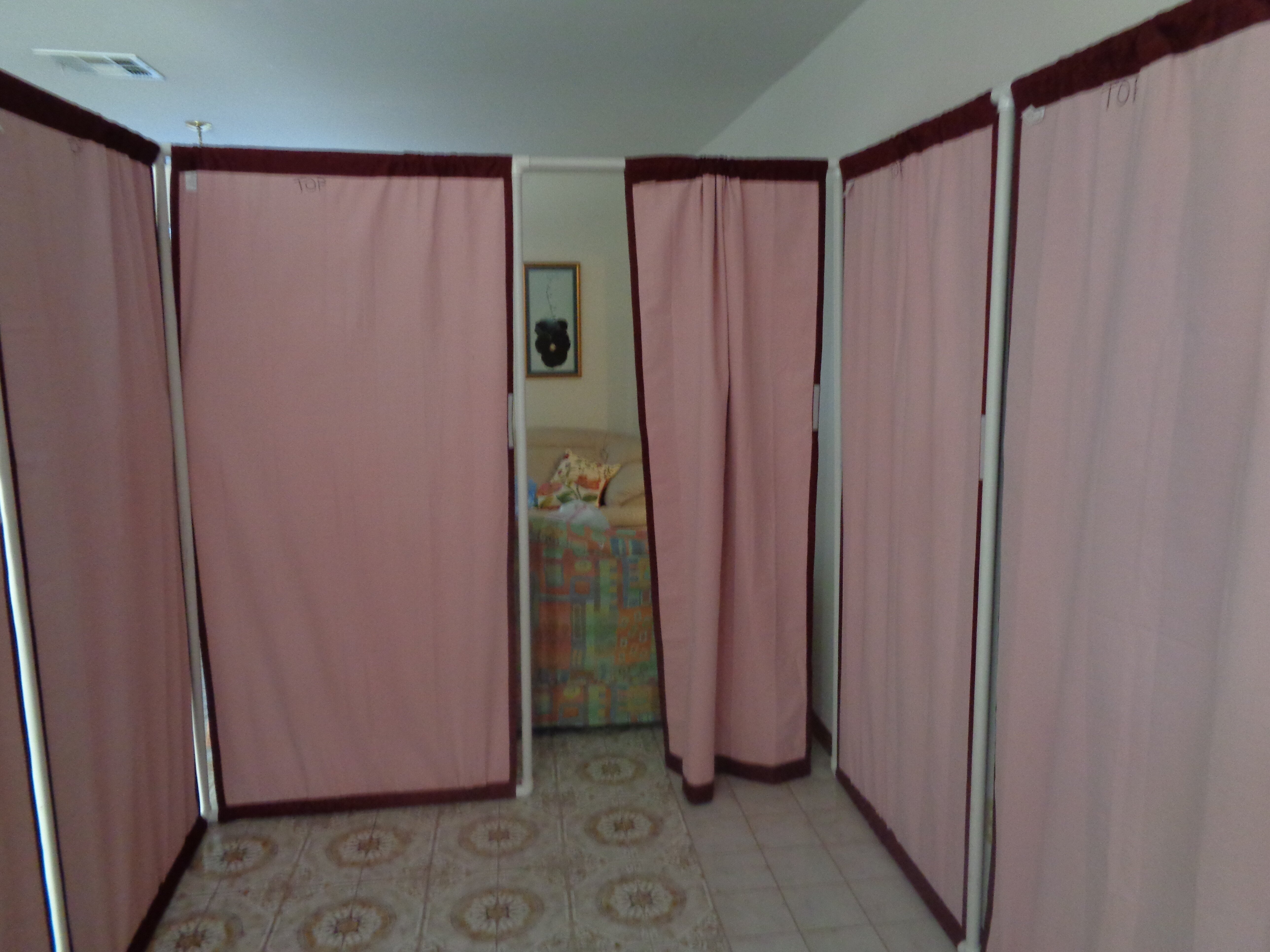

The cubicles are somewhat modular: at 3 panels by 3 panels, they’re 10 feet square, which is how we usually set them up. Below I have some photos where I set them up in a 2x4 (6’8"x13’4") configuration.
Outside:
Inside:
For a pit, the doors would obviously be wider, and you’d scrunch the side panels a bit if you used them at all!
