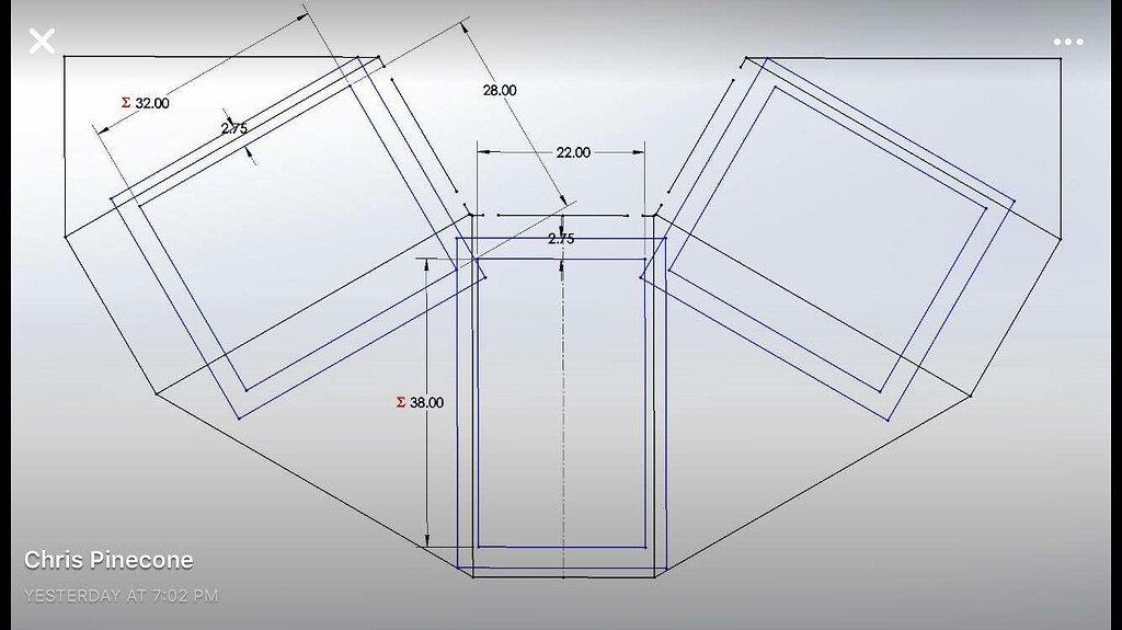

I wanted to point out something important about geometric constraints when scaling the tower. If your robot exceeds 24 inches wide, including the bumpers, and you plan to scale with your bumpers sliding up the tower, there are a couple unpleasant consequences.
  1. If you scale adjacent to the wall, the wall will push you off center. This means you might only be able to scale from the center face of the tower.
  2. If you scale from the center face of the tower, and you overhang to the sides, you may interfere with adjacent robots. If they get there first, you may be blocked from scaling. If you get there first, and you only scale to the minimum height, you may block your alliance members from scaling.
Possible solutions:
  1. Have a very narrow robot.
  2. If your robot is wide, scale first, and raise yourself 5" MINIMUM higher than necessary, to allow your neighbor to scale next to you.
  3. Plan to be the only robot on your alliance to scale. This will limit your chances to be on a winning alliance.
  4. Chamfer the side of your robot that contacts the tower such that you play nice with others. (see attached figure)
  5. Use some other robot/scaling geometry that doesn’t have this issue.
I’m publicizing this issue because we want to be on alliances with multiple climbing robots, and putting it out there makes it more likely this will happen.

I think this solution is the most viable at this point for teams that haven’t realized this possible difficulty this late in build season. It’s worth not waiting until the very last seconds to scale if it means your partner has room underneath you to scale as well.
Don’t I know it. I love discovering these little traps the game design committee has laid for us when it’s too late for most teams to do anything about it.
Raising yourself higher is a pretty viable option, though. As is pushing yourself away from the wall (after hooking in) so your bumpers stay on your side of the divider.

We are currently work on building our climber and brought this at a meeting the other night. We are planning for two different heights when we scale. Left and Right side when scaling will be right above the line we have to cross. If we go center will make sure where first to scale and go higher than we would on the left or right side. This is what our plan is as of now but it could always change.
The robot that can scale the highest on your alliance scales 1st and in the middle location. Then the 2 robots on the sides can scale anytime after. No issue.
Yep. I definitely should have been monitoring CD more closely.
I think the key will be for the quickest scaler to be in the center, regardless of chassis size. The sooner the middle is out of the way the faster the rest can start their climb and there will be more than enough room on the left and right for their chassis (no middle robot to contact!)

I know our team has chosen to hang very high so that other teams can get underneath us if necessary. We have also added extra power to our climbing mechanism in order to lift in just 2-3 seconds so we can get up higher and faster to allow other robots to climb underneath us.
