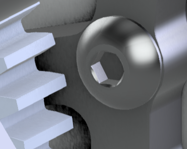

All in all, good looking gearbox design. While I am not a custom gearbox expert, I did notice one thing that gave me cause for concern. I would rotate the CIM mounting holes to give a larger clearance between the upper mounting hole and the first stage gear (picture below). The current alignment might be good enough to work as is, but for a gearbox I would prefer to have some extra safety factor in case that bolt were to ever come loose.
Good point. Will do. Maintenance and failure is important to think about.
