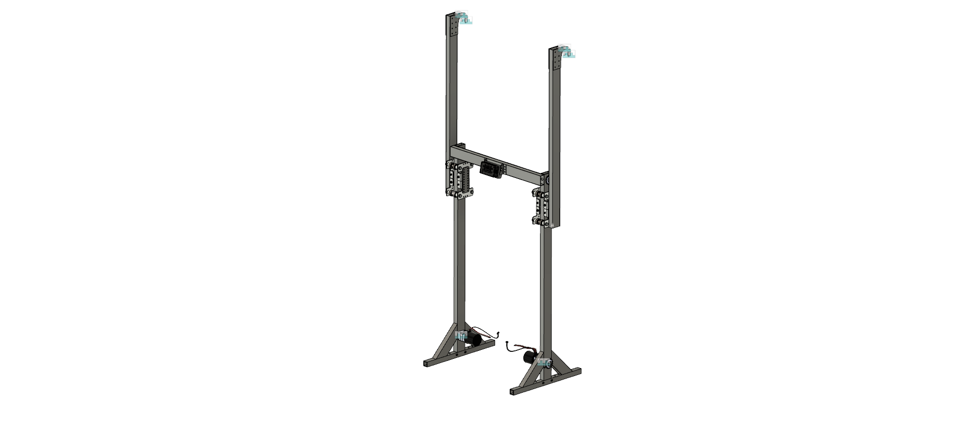

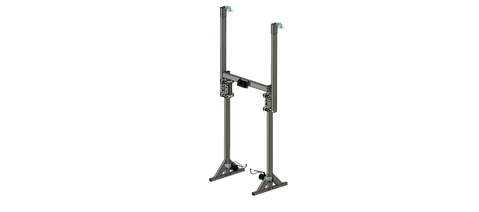

We are using a 2-stage cascading elevator system with chains for climb, however, a mechanical stop for the climb was not incorporated so it slides down after power is no longer provided to the motors driving the system. I realize that this is a design flaw, but is there any way to apply a mechanical stop that would prevent the robot from falling back down, or at least slow down the rate at which it falls so that it would still be off the floor 5 seconds after the end of teleop.
A ROBOT is considered HANGING if, five (5) seconds after the ARENA timer displays zero (0) following TELEOP, it is fully supported (either directly or transitively) by its GENERATOR SWITCH.
The main hindrance are the sliders that move up and down the stationary beam because it limits the mountable space on the stationary beam to less than an inch on the top and bottom.
We were looking at springs to slow the fall but any suggestions are welcome.

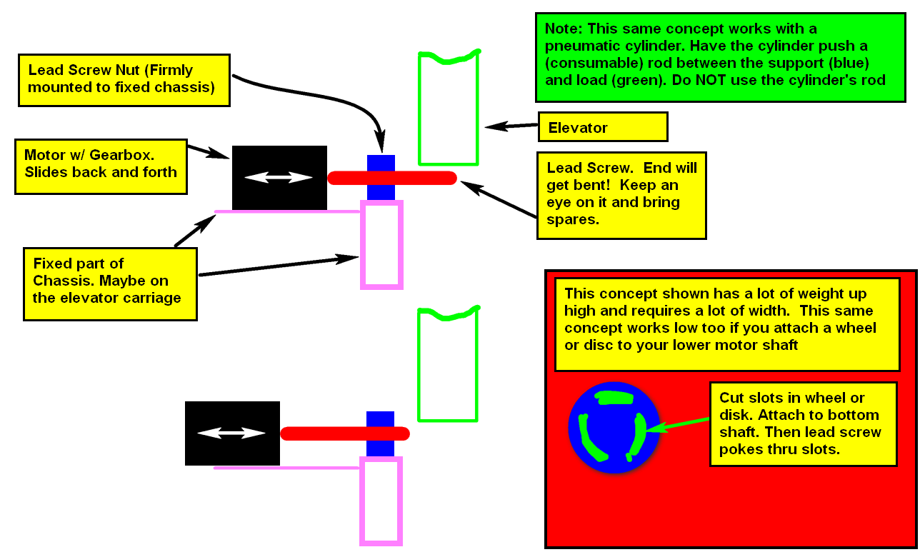

I am not sure what the space looks like around your elevator. I agree with others that the easier solutions would use a pneumatic cylinder to get linear motion to lock everything in place. But if you don’t already have a pneumatic system on the bot - here is an idea that only uses motors. I would be careful about servos - the ones allowed can be pretty powerful, but my experience with flipping ratchet wrench switches is that if there is any load on them, it is nearly impossible to flip them.
Constant force springs can get pretty beefy (40 lb version). These can get heavy! They have a LOT of power - use gloves and extreme caution around them (they give very unpleasant bruises)! Have them pull the elevator down and use your motors to overcome their pull. You might want 2-3 of them depending on how much they dip. I have seen quite a few bots that are up at T=0 but only by a few inches and slide down to touch.
