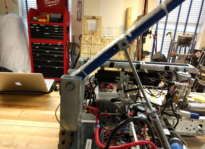

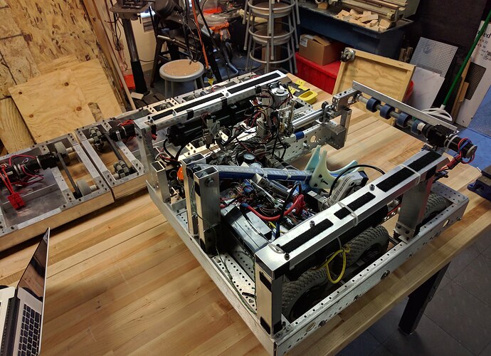

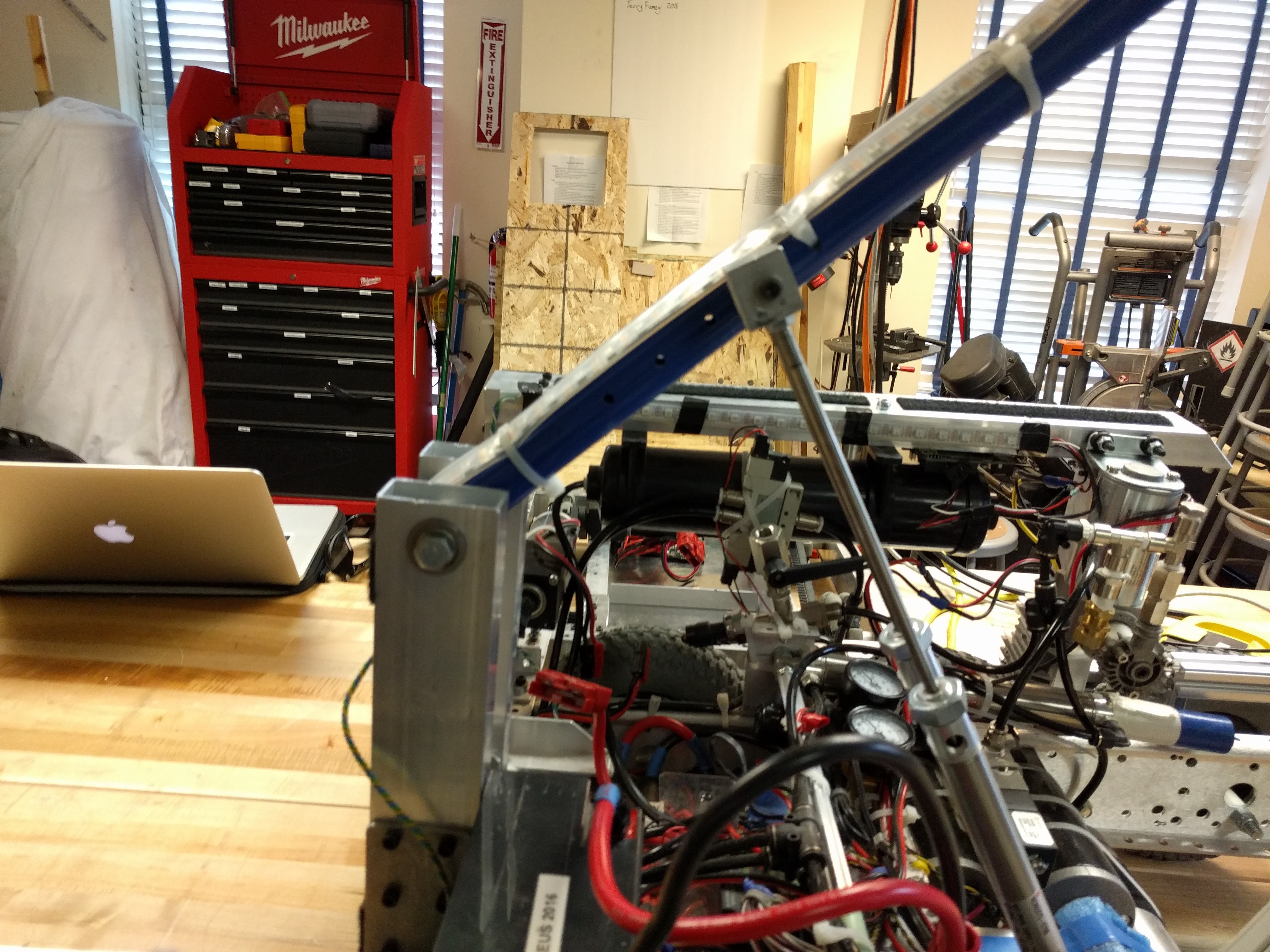

You can see the inner workings of our catapult in the below image. We used 4x 7/8" bore cylinders, 4" stroke each.
We did not use the super high Cv solenoids automation direct sells (mainly because they are GIGANTIC). We used some smaller sized SMCs that we have used many times along our history.
One thing we did do though was limit the runs of tubing to as small as possible. To do this, we mounted the manifold & solenoids right next to the catapult cylinders.
Additionally, we created a ‘pre-charge’ tank @60psi to remove the pressure regulator from the flow path. This meant we had a black plastic Clippard tank @ 60psi right next to our manifold, which was right next to our cyilnders. Each shot from our catapult used about 1/3 of the black Clippard tank, which again helped as we maintained fairly consistent pressure in the entire system throughout each shot.
Good luck! We shot approximately ~12,000 test shots on 10 different prototypes to reach the final configuration we liked :).

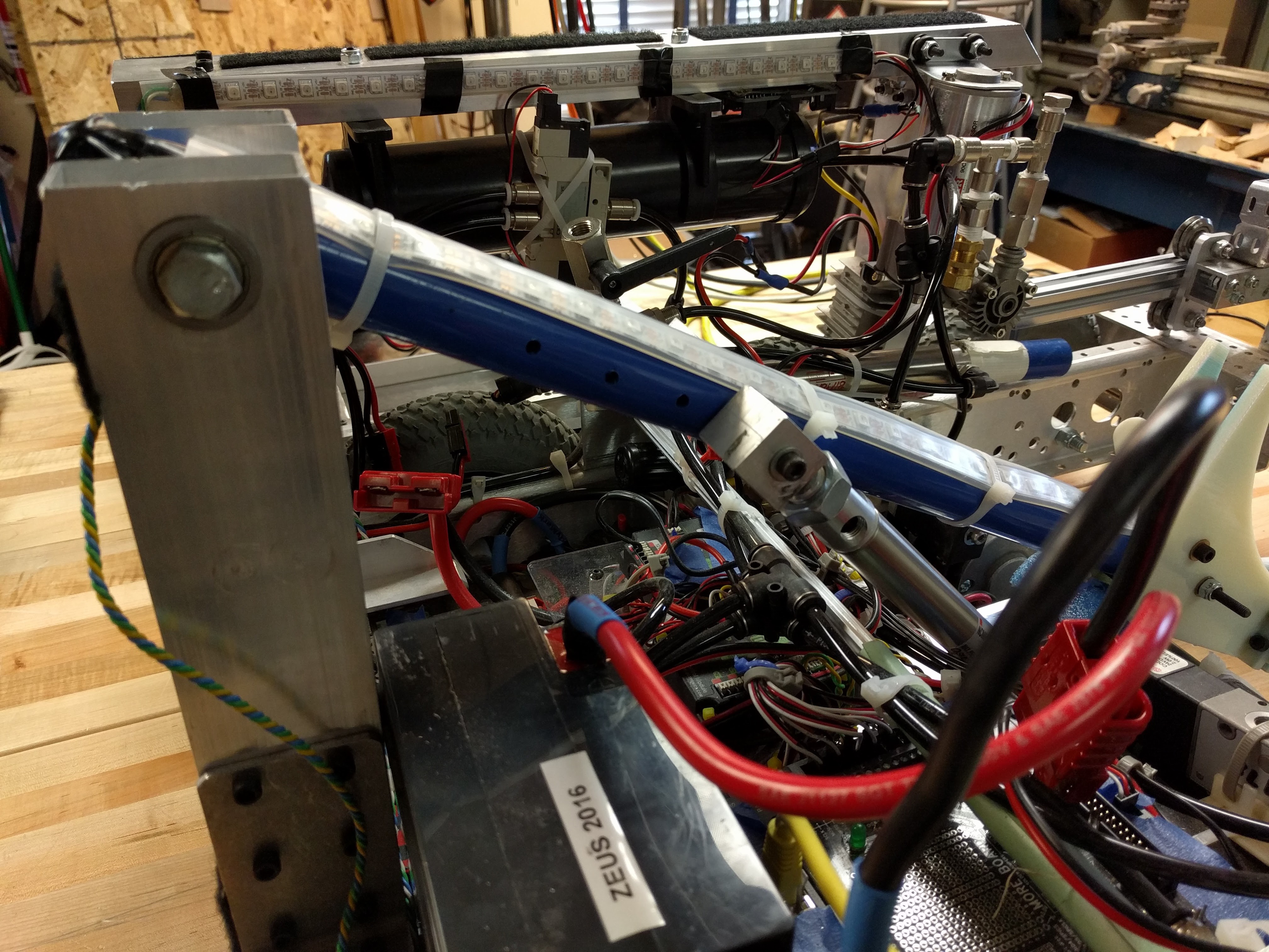

We built a pneumatic catapult for RI3D on 'Snow Problem. We used a pair of 0.75" bore 7" stroke cylinders with high cv valves (Norgren v60). The black tanks are at 60 psi. The catapult is gravity return, top of the cylinders are left open. The distance from the pivot point to the piston mounting point is 6.5". The length from the pivot to the center of the cradle is 20.5". I would be happy to answer any questions.
