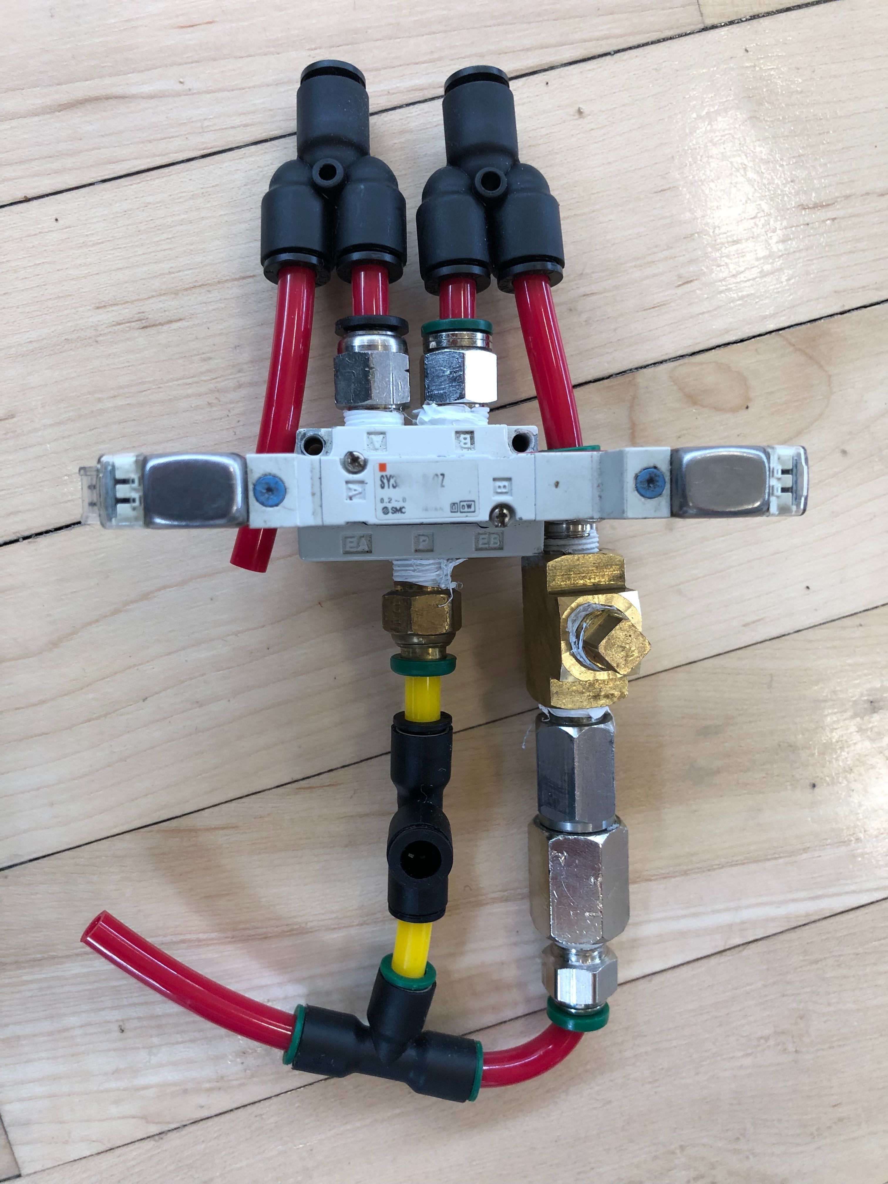

A team I was talking with last weekend was using two pistons to raise their robot to hab lvl 3. Due to an imbalance of weight, this wasn’t working evenly like they wished. While they tried to fix the balance, they were also exploring options for controlling the pistons using PID. By picking a 3-position solenoid with a closed center for each of them, they can essentially stop the cylinder in any given position, letting them cycle between extending and stopped based on sensors in order to get a relatively even lift. However, please be aware that these solenoids may not be designed to relieve when pressure is released! Some do, some don’t. If they don’t, you’ll have to get creative with your plumbing design to ensure all pressure is properly released.
Since you posted this… I’ll expand on the end of my last reply. You can see how it would work in this video: https://www.instagram.com/p/Bs66W7YFzNv/
And a partially plumbed solenoid. Pressure would come in from the bottom of the picture., go out to either end of the cylinder at the top. The Y connectors at the top feed back into check valves (only the right side is actually hooked up in the picture) that would release air back into the system. This way when the solenoid is in the closed center position and can’t relieve pressure, pressure can still relieve through the check valve when you open your manual release valve. Depending on your valve, you may or may not need a setup like this.

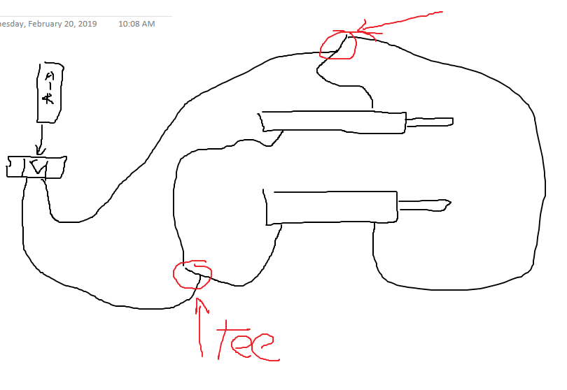

Last year, our robot’s ramps each had 2 cylinders, tee’d symmetrically from one solenoid. Even then, they actuated out of sync, so we added some flow limiters to one side of the branch to give finer adjustment to balance them out.

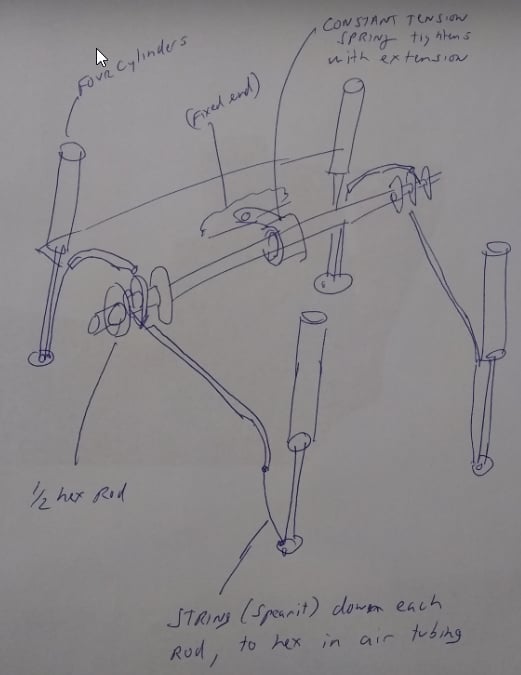

I posted earlier about this same topic…people advised using flow valves–and they got us halfway there, but the weight distribution on our robot was off, so we still couldn’t get four cylinders to go the same speed even that way.
So we added what we’re calling a 'lift governor".
Each cylinder has a string that it has to pull to extend, attached to a ‘foot’ at the end of each rod.
The four strings all go back to turn the same 1/2 hex rod where all four wind against a constant force spring. So the ‘fastest’ cylinder is slowed to the speed of the slowest by the spring-winding. Our spring is six pounds of force–and that seems to be enough resistance to slow down the fastest cylinders to the speed of the slowest.
Our four cylinders are 1-1/16 dia, so 47 pounds of force each–188 pounds. The constant force spring adds to the total load they pull, but the extra resistance seems effective to keep them going the same speed (with flow valves)

The problem is inherent in having two independent air lifts without feedback - once one of them gets a bit ahead, the weight shifts onto the one which is behind, which becomes even slower. @hrench’s lift governor does some mechanical feedback, @Jon_Stratis mentioned which controlled 3-way valves. Another way to control this would be if you have an actuator which shifts the CoG of your robot so that it loads one or the other of the cylinders more heavily; you would start this in a central position, and move it toward the side which is higher than the other as the climb progresses.
@hrench Our team seems to be having the same issue. I am having a hard time visualizing what you are talking about. Is there a way you can post an image of this mechanism?
I really need to get this written up in a more professional manner, but I made a quick sketch hoping to convey our idea…I hope you can get it from my bad sketch.
The strings are wound around the hex-rod when the cylinders are not extended. When the cylinders extend, they pull the strings and turn the rod against the force of the spring, to wind up the constant tension spring.
if one cylinder is trying to be faster than the rest, it is slowed by the string pulling.
This only worked with flow valves to get the cylinders pretty close…if one cylinder was way-slower than the rest, it could still unbalance the robot.
How do you tension the string so that when a piston rectract it rewraps around the rod? Or do you not worry about it and just let the string hang?
The constant tension spring should wind the shaft back up when the cylinders are retracted.
You pulled on it and extended it with the cylinders…now when you retract the cylinders, it naturally wants to return to its original position. Like a tape measure winding in.
