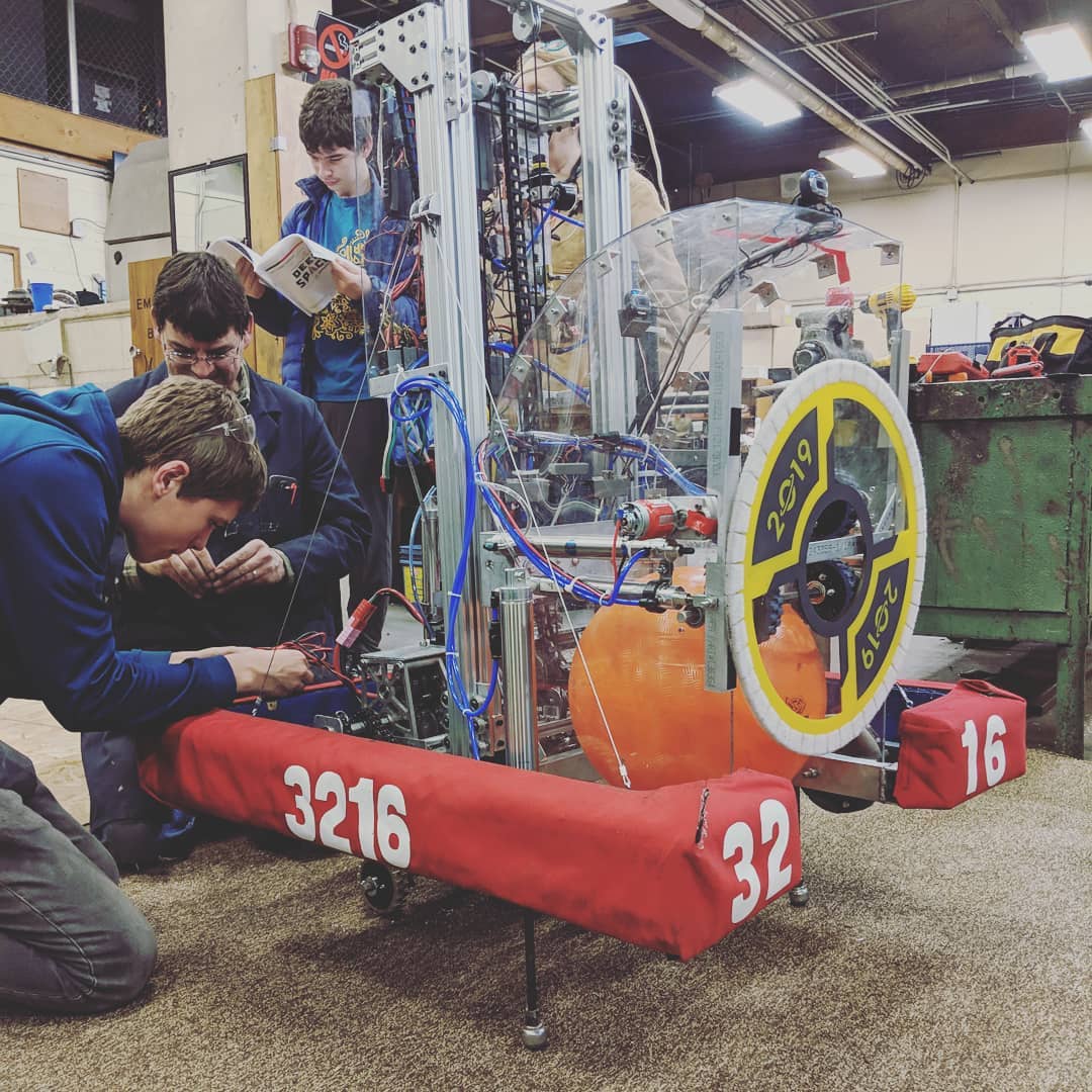

This year we decided to lift our robot with pneumatic pistons with wheels on the end. We have two pistons in the front (one each corner) and one in the back. Here is a picture of the robot with a set of smaller pistons that we got to work:
We used adjustable flow rate valves to balance them. The main problem occurs when we switch them out for larger ones. These larger ones have a 20 in. stroke and can raise us up to Level 3. The problem is getting them to go up evenly. We can’t find a consistent balance between the front going up and the back going up (at 120 psi). Does anyone have any recommendations for tuning flow rate valves? Should we start with them closed, find a balance, and then increase speed, or go in the reverse of that? Thanks.

I don’t think it should matter much which direction you tune from, just try to do it with known increments (write down how many turns you do).
That said none of your cylinders should be at 120 PSI, the max working pressure is 60 PSI and if you are using 120 psi into anything that’s illegal and you won’t pass inspection.
The storage tanks are at 120 psi due to the large size of our pistons, they eat through all of our 60 psi in the working pressure. The pistons also need to be near 60 psi themselves to lift the weight of the bot. But we have enough air on board so this isn’t a problem.

Basically two approaches that I’ve heard teams try are to use closed center solenoids and controls, or to use some type of lift governor as explained by hrench.

Another idea I think I got from CD was to mechanically connect front and back with some latching mechanism, possibly using a gate latch actuated by a servo.

We have adjustable flow rate valves for each cylinder, which are placed between the solenoid valve and the cylinder’s valve to extend.
Could you use gyro feedback to control two solenoids, with one solenoid feeding the rear pistons and one feeding the front pistons? Lift the front until +5 degrees. Lift back until -5 degrees. Lift the front again until +5 degrees. Lift back again until -5 degrees. And so on…
I suppose solenoid control might also be accomplished in analog fashion… A rocker switch (or a couple of limit switches) with gravity and a pendulum-type extension providing level reference.
