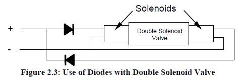

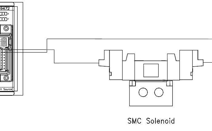

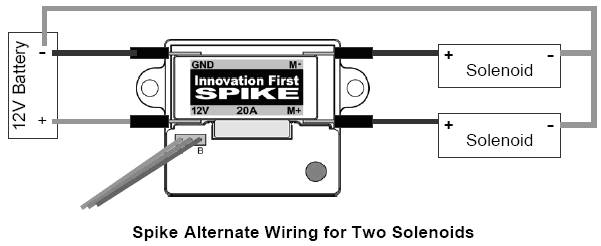

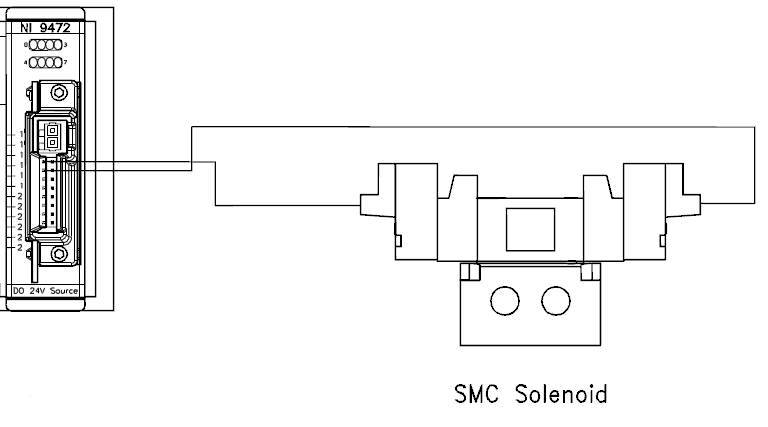

Typically, the major variations you’ll see in wiring a double solenoid on FRC robots are:
  • Use two outputs on the Pneumatic Bumper w/o a spike at all (diagram 3 below). This is the easiest choice.
  • Use diodes to direct the current flow from the spike to a either side of the solenoid (2nd diagram below). Jeremy’s favorite method.
    *]Cross-wire the sides of the solenoid to a spike (first diagram below). This is the way I usually tell people to wire a double solenoid to a Spike.
    All three methods work fine. It’s just a matter of choice and circumstances.
