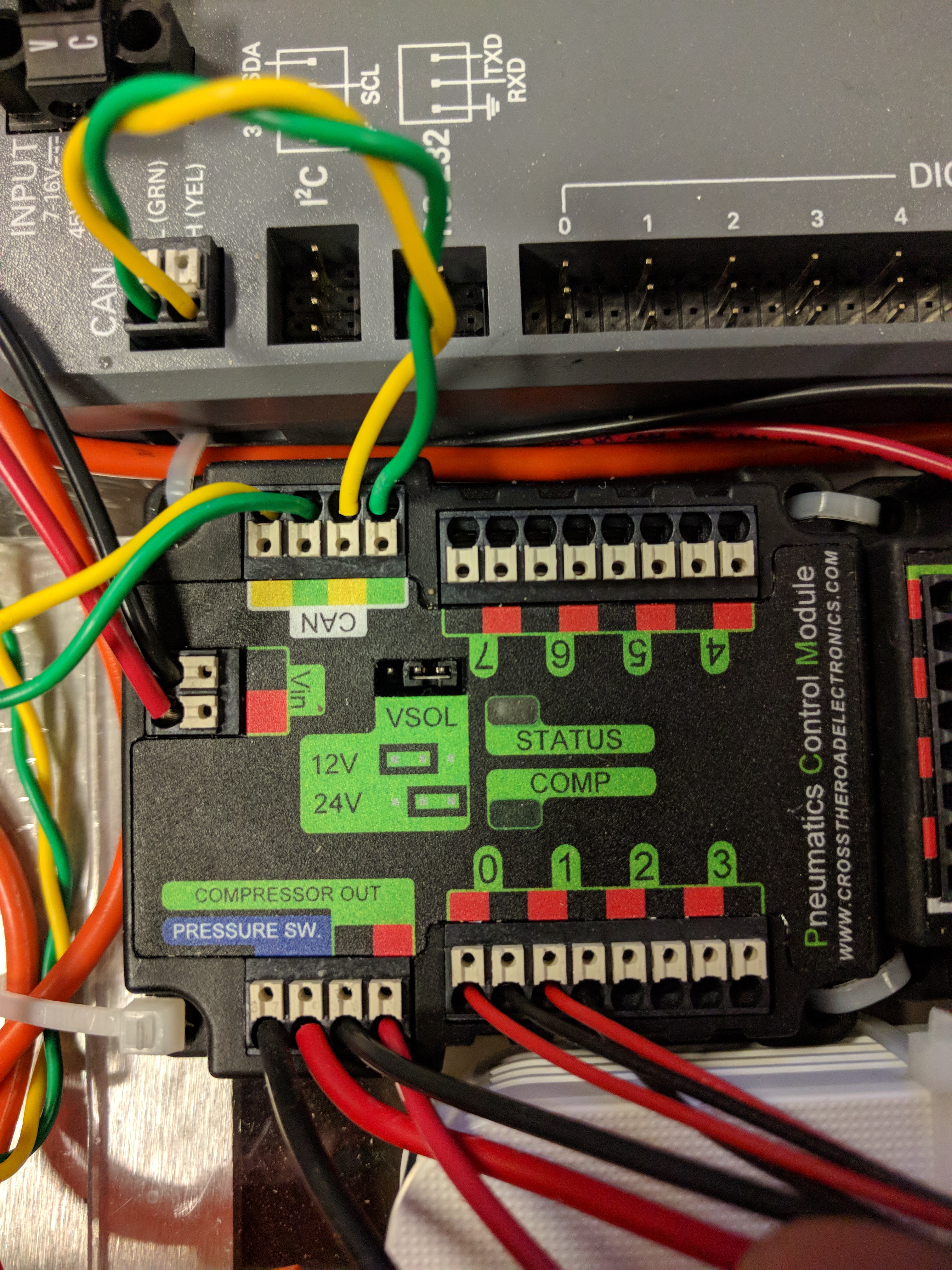

you do not need to call a command to turn on the compressor, unless you want it only to turn off and on at specific times, as long as a solenoid command is created the compressor should run. Do you happen to have a picture of your PCM wiring? is your pressure sensor installed correctly?
When we turn on the RoboRio, we get a green blinking status light. The pressure switch seems to be working on the Phoenix Tuner - it shows pressure is not full.
We tested the compressor, and when conneced to 12v source, it will turn on. GitHub link for full code is below, still unable to get the compressor to turn on when robot is enabled.
When we press the buttons to operate the solenoid, we are getting a null pointer exception in the Launcher.java subsystem (either line 28 or 32 depending which buttong is pressed) which crashes our robot code.
The phoenix tuner occasionally gives a compressor short cicuit sticky error (we have checked the wiring and there are no obvious shorts), but after we clear it, it doesn’t appear again for a while (seems random).
the wire gauge going into the pressure switch slot look pretty large for a switch, and the wires going into the compressor slot look very small for any type of COTS compressor, are you sure the wires are not switched.
