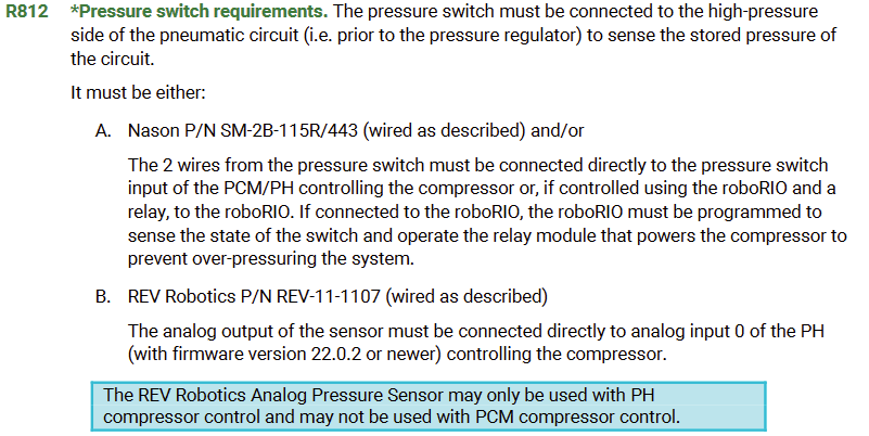

You will need an analog pressure sensor (in addition to the digital pressure switch of using the CTRE PCM) Something like this would work: https://www.andymark.com/products/analog-pressure-sensor
R805C states that you must use the analog and/or digital sensor. The digital sensor is not required if you are using the analog one. The Pneumatic Hub can be configured to use just digital, just analog, or both in a hybrid mode.

With the REV Pneumatics Hub that is true. However with the old CTRE PCM you can use an analog pressure switch plugged into a RIO and do the same thing. You just also need the digital pressure switch plugged into the PCM.

So if we have the CTRE PCM we need both and analog switch and a digital switch?
No, you can plug the REV Analog Pressure Sensor into the RIO
Edit: I am mistaken, you need the REV Pneumatics hub to be able to only use the REV Analog Pressure Sensor, so yes, you will need to use both. I don’t know if in code you will still be able to configure the on and off depending on your PSI but you should be able to.
That does not satisfy R812. If using the CTRE PCM you need the pressure switch.
ya, I just realized that. I posted an edit
