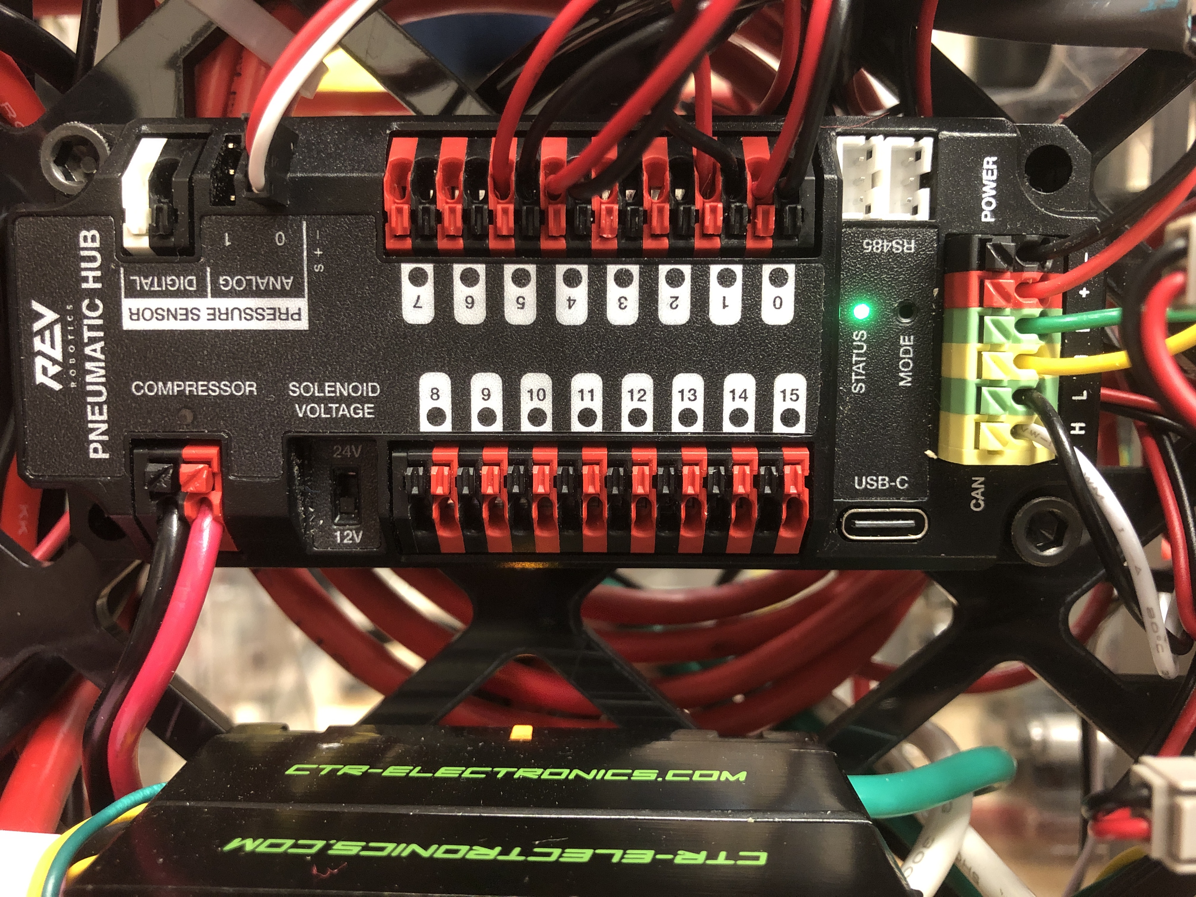

Hello,
We are using the REV Pneumatics Hub this year and for some reason the Channel Status lights are not glowing green. It is properly powered with the switch on 12v. The compressor is also properly wired and does work. We have our analog pressure sensor properly wired into the 0 port. A picture is attached.
Thanks
Has your code turned on any of those solenoid ports?
The code is calling those ports but nothing is happening on the hub itself
Pneumatics Hub is set to CAN ID 1?
Firmware up-to-date?
Make sure your pressure switch isn’t digital, and truly is analogue.
