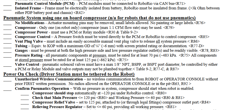

This is my first year being a lead pneumatics person and I was wondering if anyone knew any of the questions that are asked about pneumatics during inspection. Also what are somethings they check for? Thanks for the help!
Here is a picture of the relevant part of the inspections checklist:
And the makes an inspector happy list:
Use large gauges so we don’t have to go blind reading your pressures
Making everything easily accessible makes it easy to see if setup is correct and to test shorting system to check pressure relief valve

I ask simple questions about the system to make sure it meets the rules and is safe to operate. Questions include locations of items, pressure ratings, modifications, types of regulators, demonstrations of dump valve location and access, relief valve settings, etc.
Also put those gauges where we can see them at the same time, ideally without having to get into a weird position or look through half the robot to get a reading (which can get a little challenging when we get into the multifocal lenses).

Please, make it easy for us to see everything with our bifocal safety glasses.
