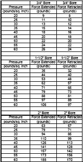

my team was just wondering how much you could possibly lift with the pneumatics provided in the kits, does anyone know and would it be effective in using it for the arm? :confused:
Well, for how much you could possibly lift, you can look that up in the 2005 Pneumatics manual. It has charts that show how much force in and out. And make sure you don’t forget, you can order two free cylinders :slight_smile:
link http://www2.usfirst.org/2005comp/Manuals/2005PneumaticsManual.pdf
page 12 of pneumatics manual :wink:http://www2.usfirst.org/2005comp/Manuals/2005PneumaticsManual.pdf
You can look it up in a table, but here is the calculation so you understand.
F=PA, or Force = Pressure x Area.
If you are working with a 2" dia. cylinder, the area = piĀ®^2
or 3.14*(1)^2 =3.14 square inches.
(remember to use the radius, not the diameter)
If you are working at 60 psi, the force is 60 psi x 3.14 sq in = 188.4 pounds of force in the extending direction.
To determine the force in the retracting position, you do a similar equation, except you have to subtract out the area of the rod, because the air pressure cannot act on it.
Same 2" dia. cyclinder = 3.14 square inches. Assume the rod = 1/2" diameter.
Area of the rod = pi(.25)^2 = .196 sq in.
Effective area of the retracting end = 3.14 - 0.196 = 2.945 sq. in.
If you are working at 60 psi, the force is 60 psi x 2.945 sq in = 176.64 pounds of force in the retacting position.
You have more force in the extending direction than the retracting direction, because of the smaller area.

Yep. F=PA. Double the cyclinders, double the area, double the force. Most people use the cyclinder as levers so know how much you want to lift and how far you want to move it. Then you can find where you need to place cyclinder(s), how many cyclinder, length of stoke, size of bore, the pressure you need to run at, etc. With pneumatics you only need to use what you need. Just figure how much you need to lift with respect to where you are lifting if from and you’ll be fine.
When sizing a pneumatic application, another thing to think about would be side loads and efficiency losses.
For instance, working from the numbers Chris posted above, there are many situations where you will not get your entire 176 lbs (retracting) for a 2" cylinder at 60 psi. If the rod of that cylinder is experiencing any side loads, then more friction is created inside of the cylinder. A certain amount of force is needed to overcome this friction. This amount may be up to 1/4-1/3 of the force of the cylinder, if the side load is significant. Therefore, cylinder output forces in these situations could be only 70% - 80% of your calculated force.
