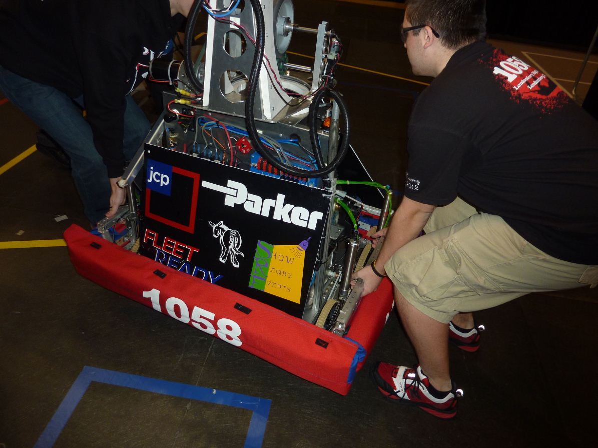

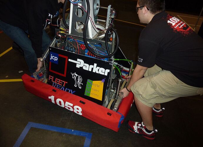

Looks cool and probably works great as well! The lights are definitely far more visible than on our control system (picture related, they’re under there somewhere). Just don’t try to bring it on a plane! haha
the picture
[spoiler]http://i1096.photobucket.com/albums/g329/Sharkbait24/electrical.jpg[/spoiler]
Don’t think I don’t remember you…:ahh:
I have a picture of that side of your robot that I show to people…
