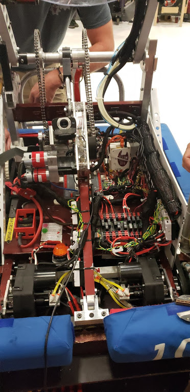

This is how ours was mounted
It worked very well because it was right there in the middle of the robot so all the runs could be very short which helped significantly with cable management. We also mounted it this way because it is very easy to access so if we need to replace a fuse or plug a speed controller in or something it made it very easy. In 2018 we used a vertical board and we had accessibility problems all year long so if we needed to unplug or plug something in we almost had to remove the entire PDP from the robot.
So in summary for my team and our robot designs a laying mount was much better then a upright board.
