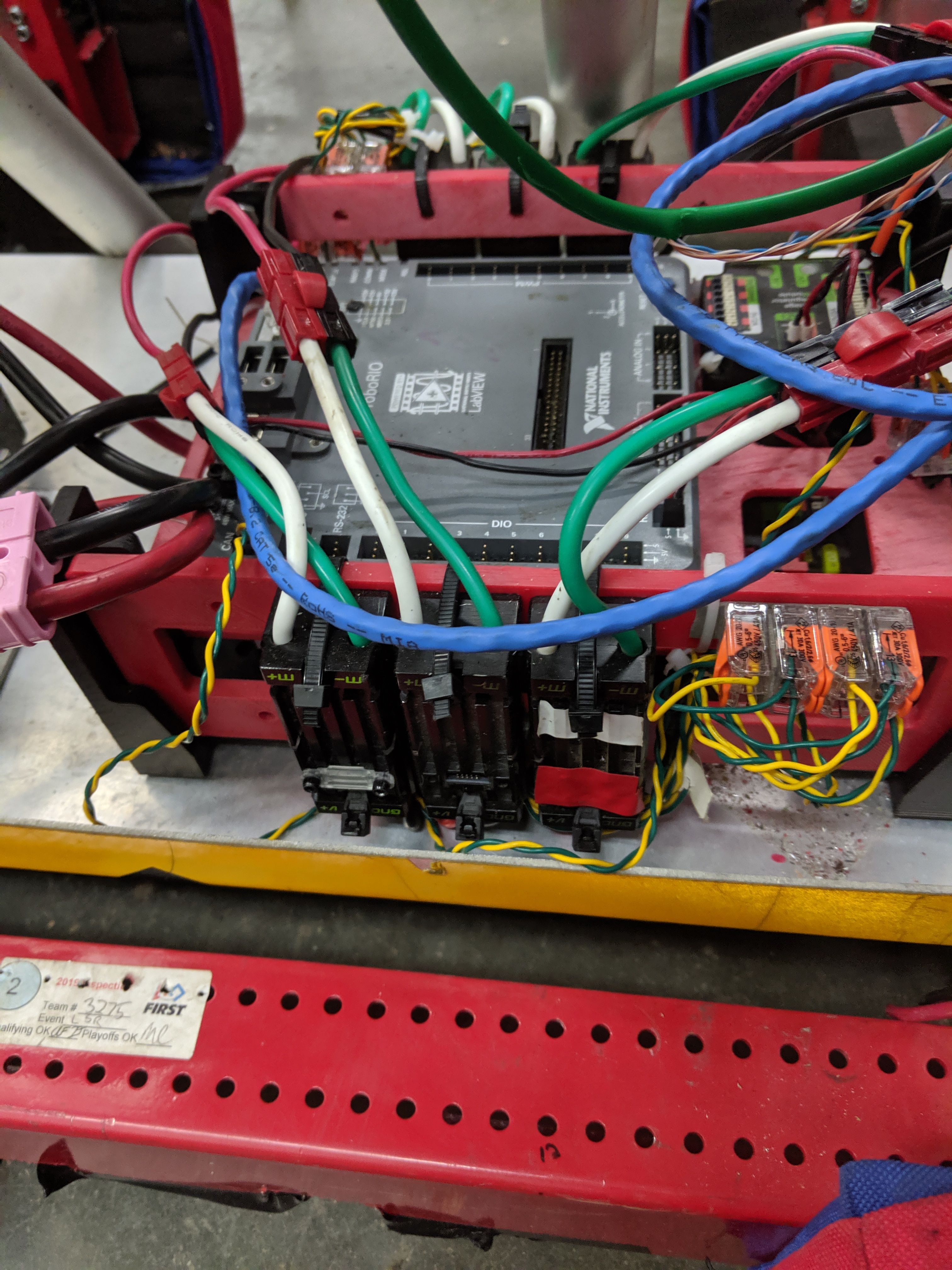

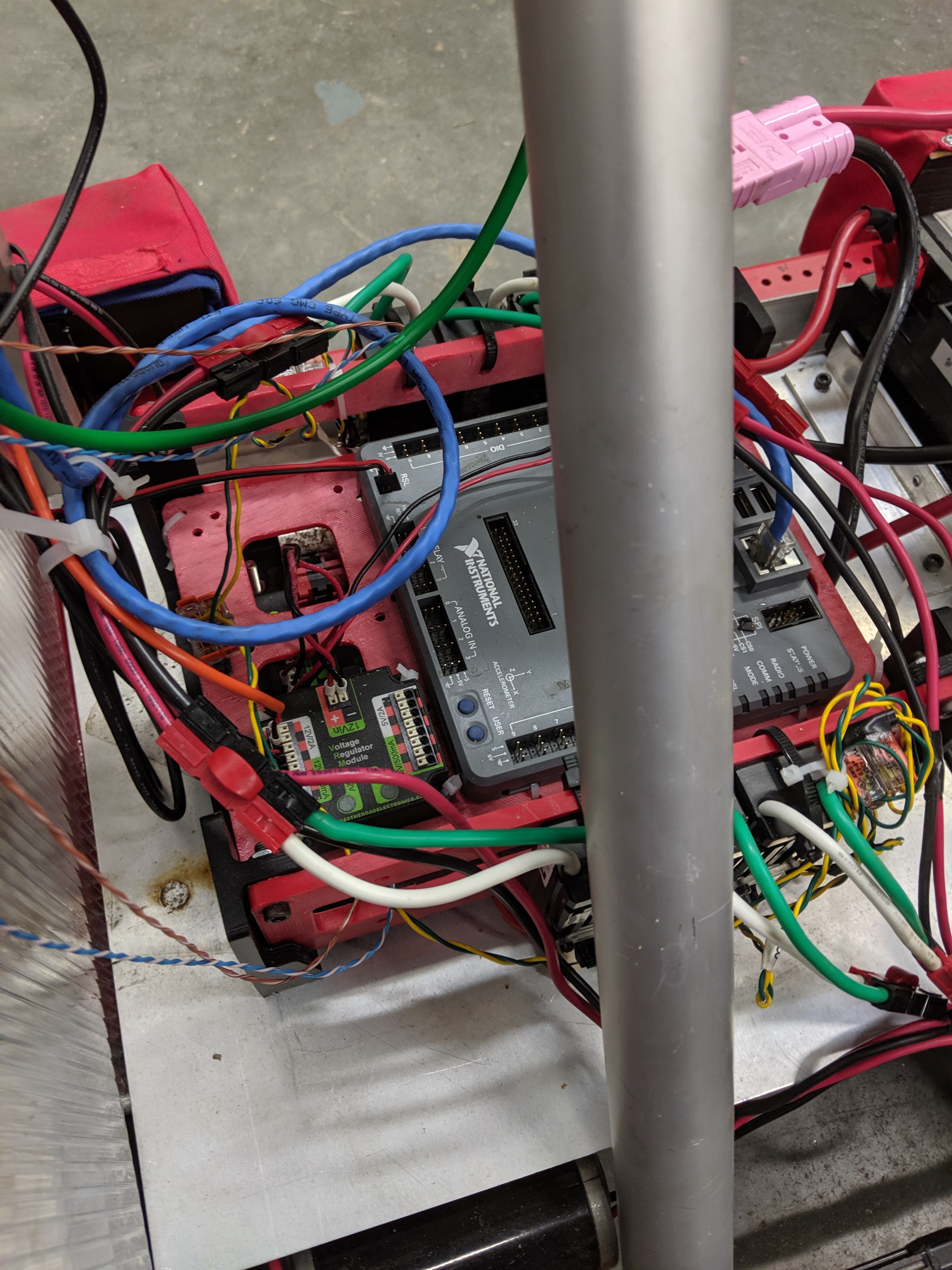

Here’s an album with a few pictures from each of our boards over the past three years. (Annotated in the pictures description.)
In some of those cases it comes pretty well flush with the bottom of the 1x1 tubing we make our frames out of. We affix a polycarb panel to the bottom of the frame to keep it protected.

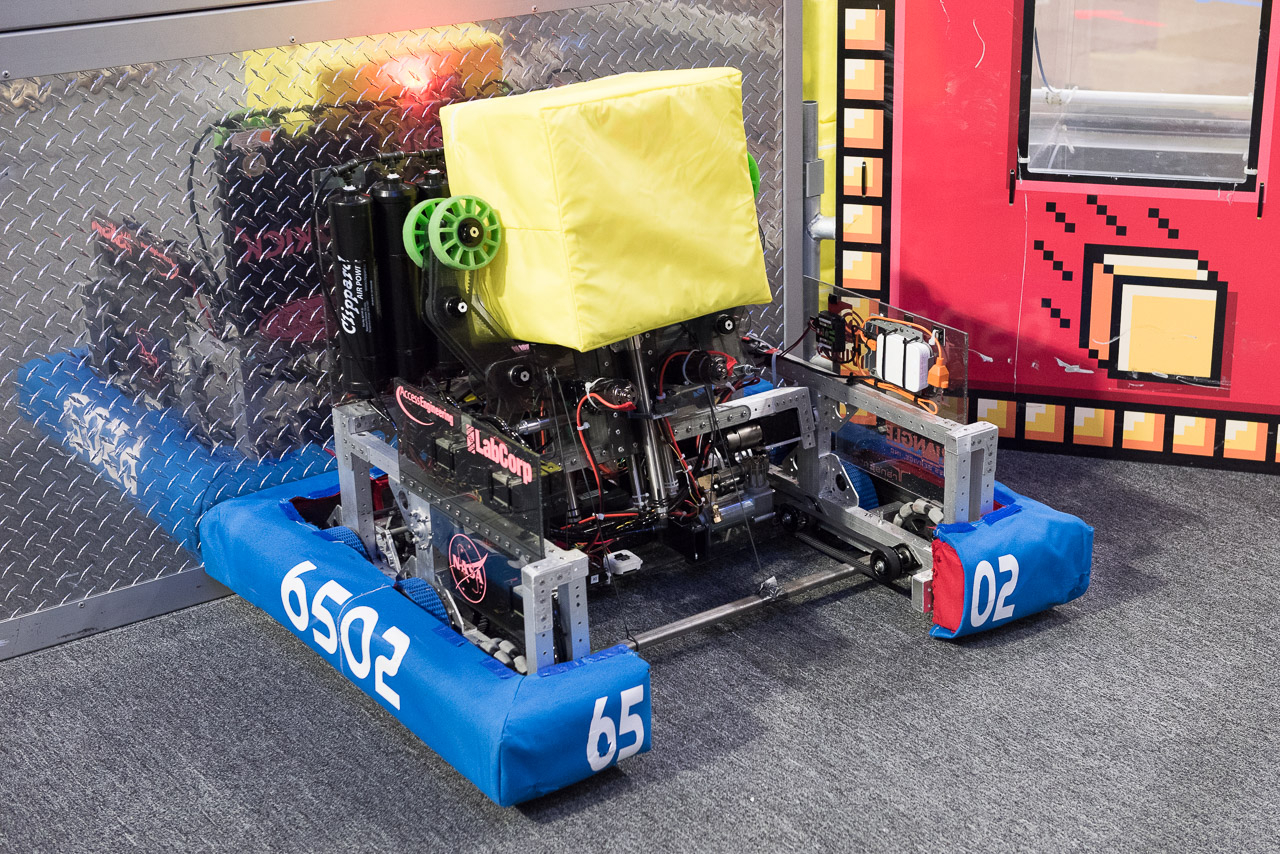

On our 2018 robot Dropkick (RIP), we made an upside-down t-shaped structure with the battery on the bottom, and the PDP and RIO on the two sides of the “T”. this sat in the back of the robot with the PDP facing out the back. This let us see everything and troubleshoot as well.
it’s hard to see in this picture, but the RIO is right behind the middle air cylinders. Since our bot relied heavily on pneumatics, we made the two “wings” (with the NASA logo) to mount the solenoids and other accessory parts on.

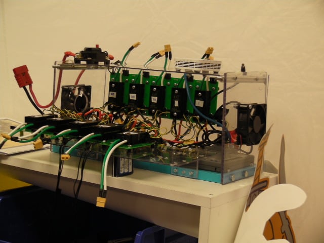

In U shape in a box with doors
