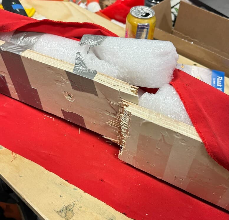

You CAN break polycarb; I’ve seen it first hand.
The issue with using 1/4" polycarb is that its MUCH less stiff than 3/4" plywood. SO, impacts transfer the load directly to your frame without any significant spreading. Plywood is acting as a structural member in the bumpers.

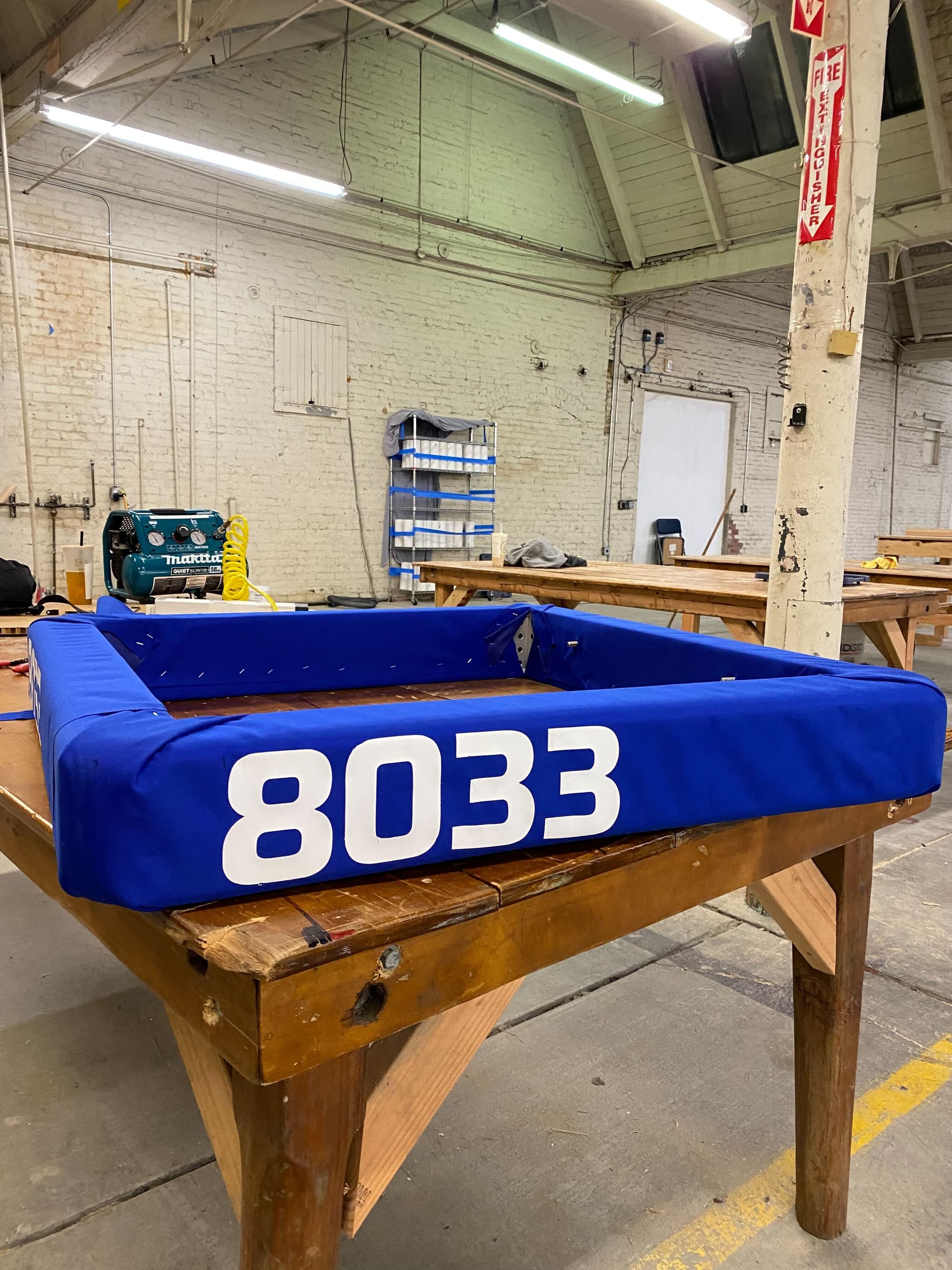

Here’s the best i could do. Hard to see, not sure where it is currently in the house.

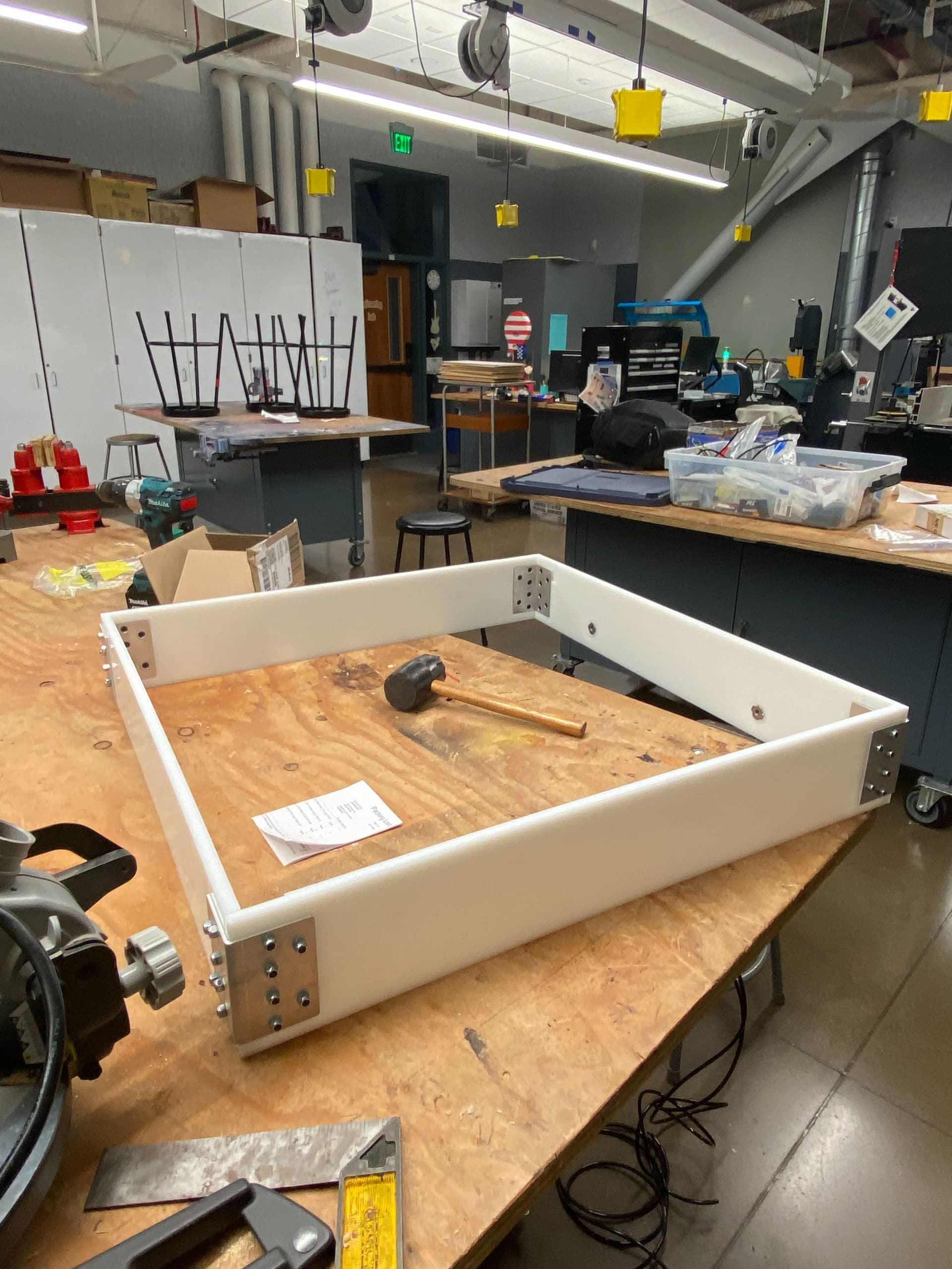

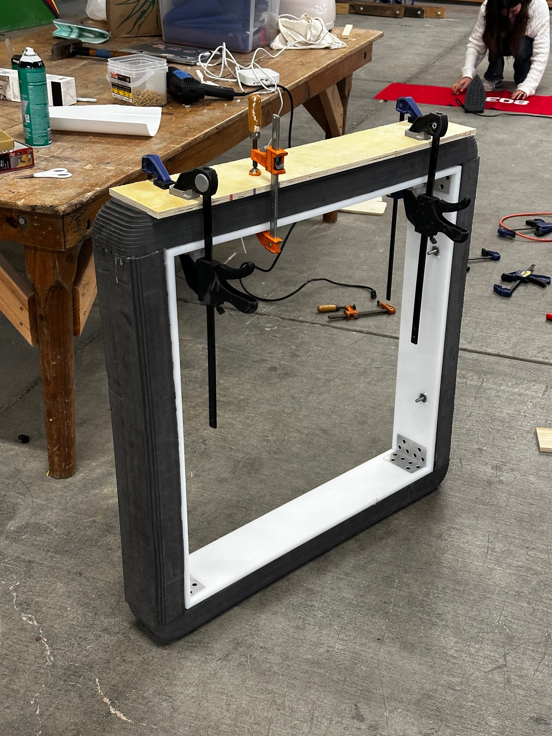

However, I’m still a huge fan of upgrades over the traditional way. This year, we built our bumpers with 1/2 inch HDPE backing, custom 1/8 aluminum brackets from Fabworks, and billet-machined EVA foam. While this is extremely overkill, we feel confident we won’t have to rebuild our bumpers this year - it’s a great update from plywood.
Configurable CAD here.

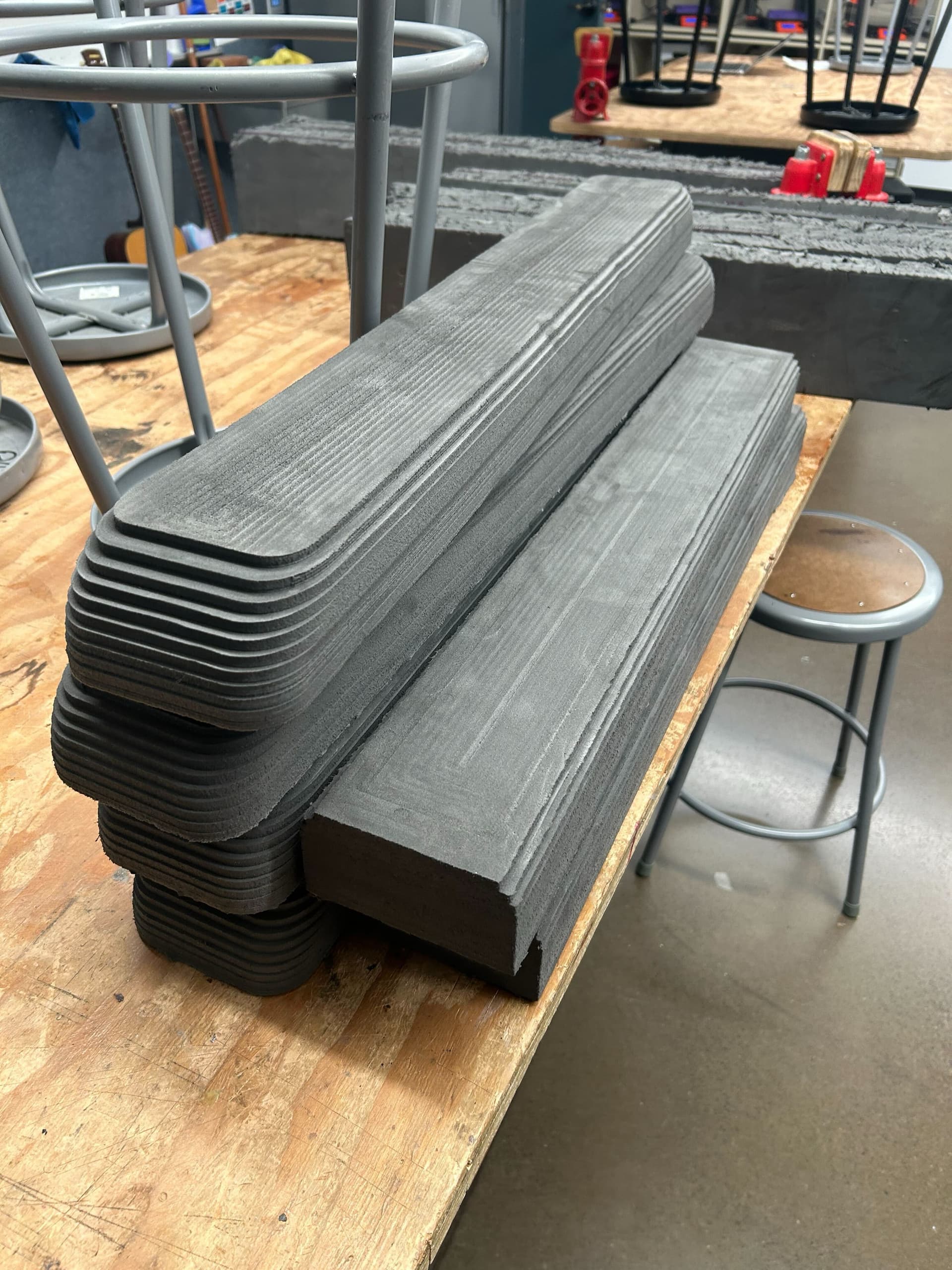

Where did you source your foam from?
We got it from Foamorder - a local company, so we didn’t have to pay shipping. We buy it in 3-inch thickness (gluing up 3 layers of 1 inch, etc also works), cut some rough blanks, workhold with painter’s tape and spray glue, and then each “side” takes around 30 minutes of machine time with a special foam-cutting endmill.
