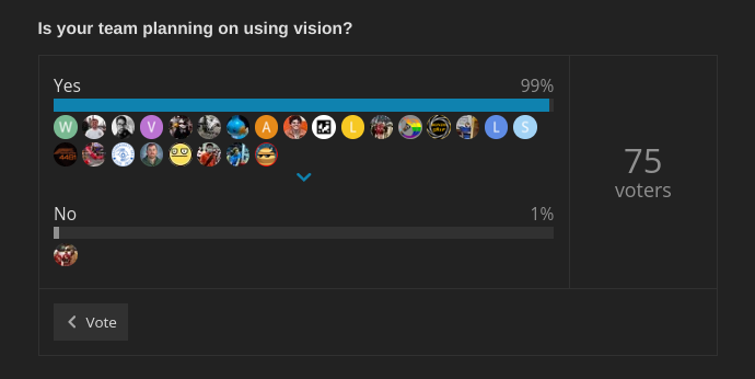

Screenshot 2024-01-05 8.22.06 AM
This is one of the most extreme examples of CD bias I’ve ever seen
(Edit: updated screenshot as proportions got even more extreme)
I get what you are saying, but this is really not surprising. FRC has been pushing having vision on the robot for ~10 or more years.
I looked at the 2022 usage stats (could not find 2023), and ~1500 teams reported having “USB camera”. I believe that means the camera is connected directly to the roboRio, and does not count all the teams with separate coprocessors. So, I would guess that >90% of all FRC teams have some sort of vision processing.
I’m sorry, but there is no way this is the case. With most regionals falling between 40-60 teams, and most district events being 30-40 teams, this would mean that your typical regional would only have 4-6 teams without vision, and your typical district event would have 3 or 4.
