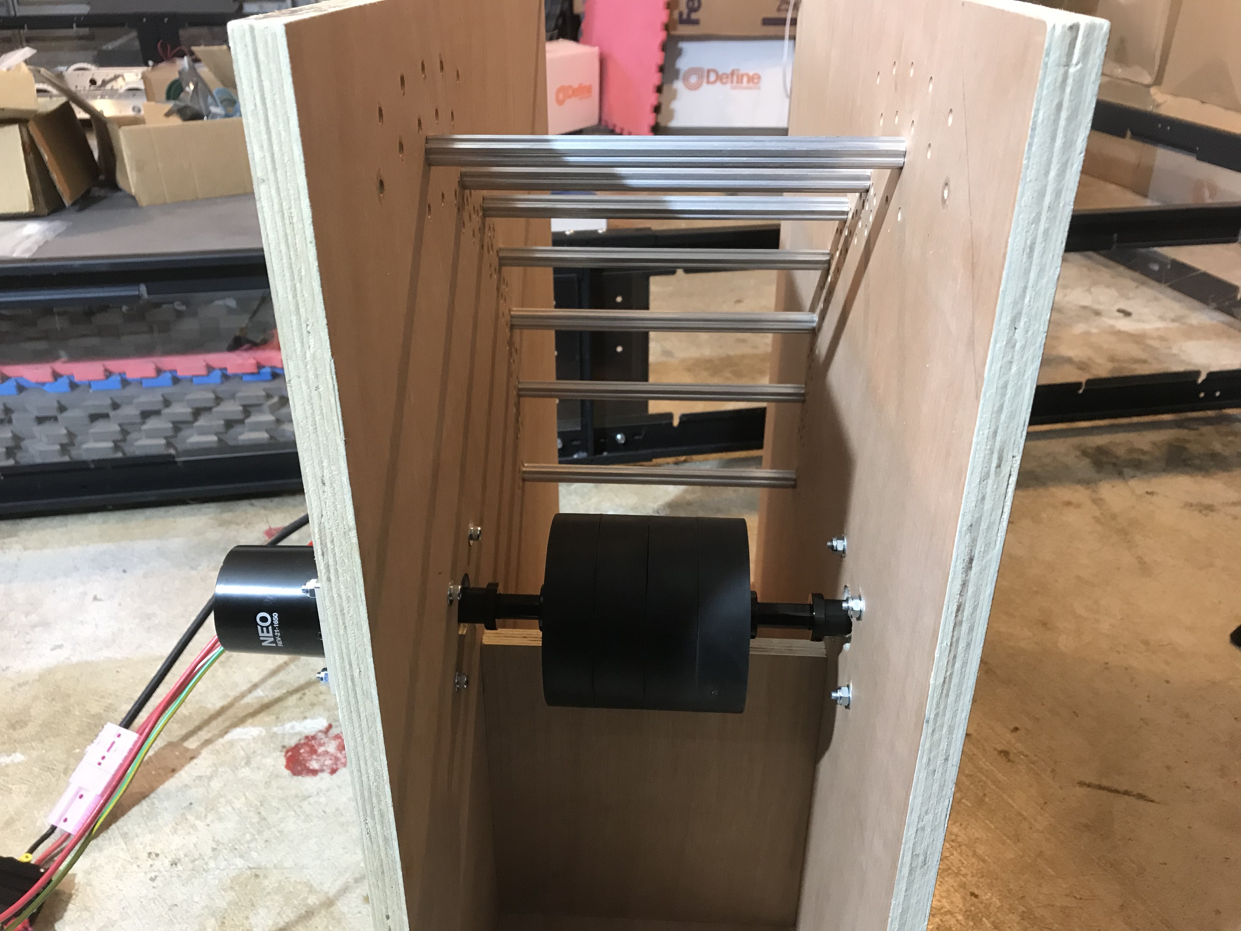

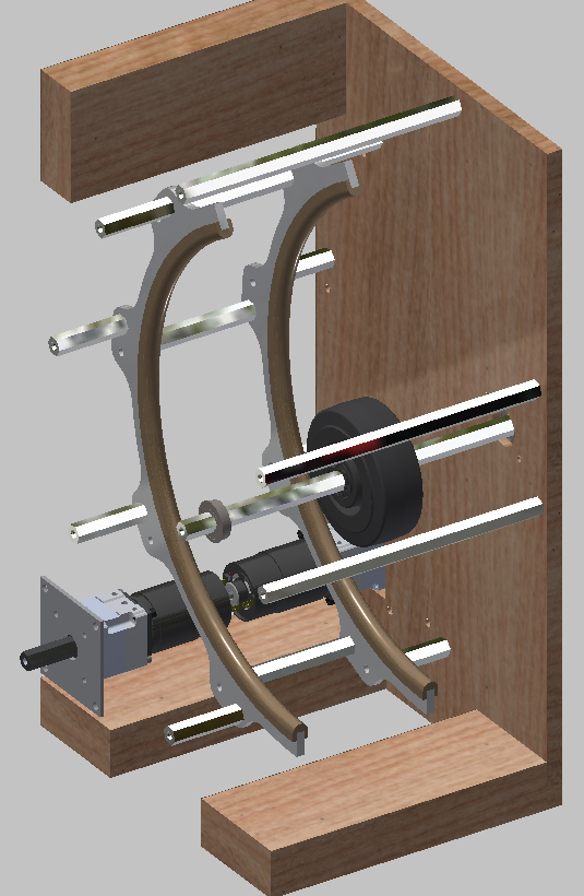

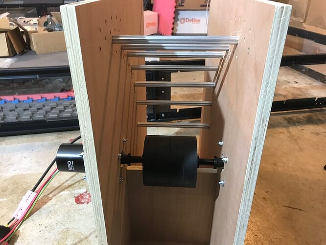

Our team hasn’t built a successful hooded shooter in active memory. Looking around and analyzing other team’s CAD models and robot pictures, I’ve noticed that the overwhelming majority of shooters are built with a polycarbonate backplate. What is the benefit of that over a set of two rails with a high-friction material lining, like this:

Depending on the spacing of the two rails, the ball rotates on a smaller radius than it would on a fully-backed shooter. Intuitively, I would expect this to affect the rotational velocity to linear velocity ratio of the ball.

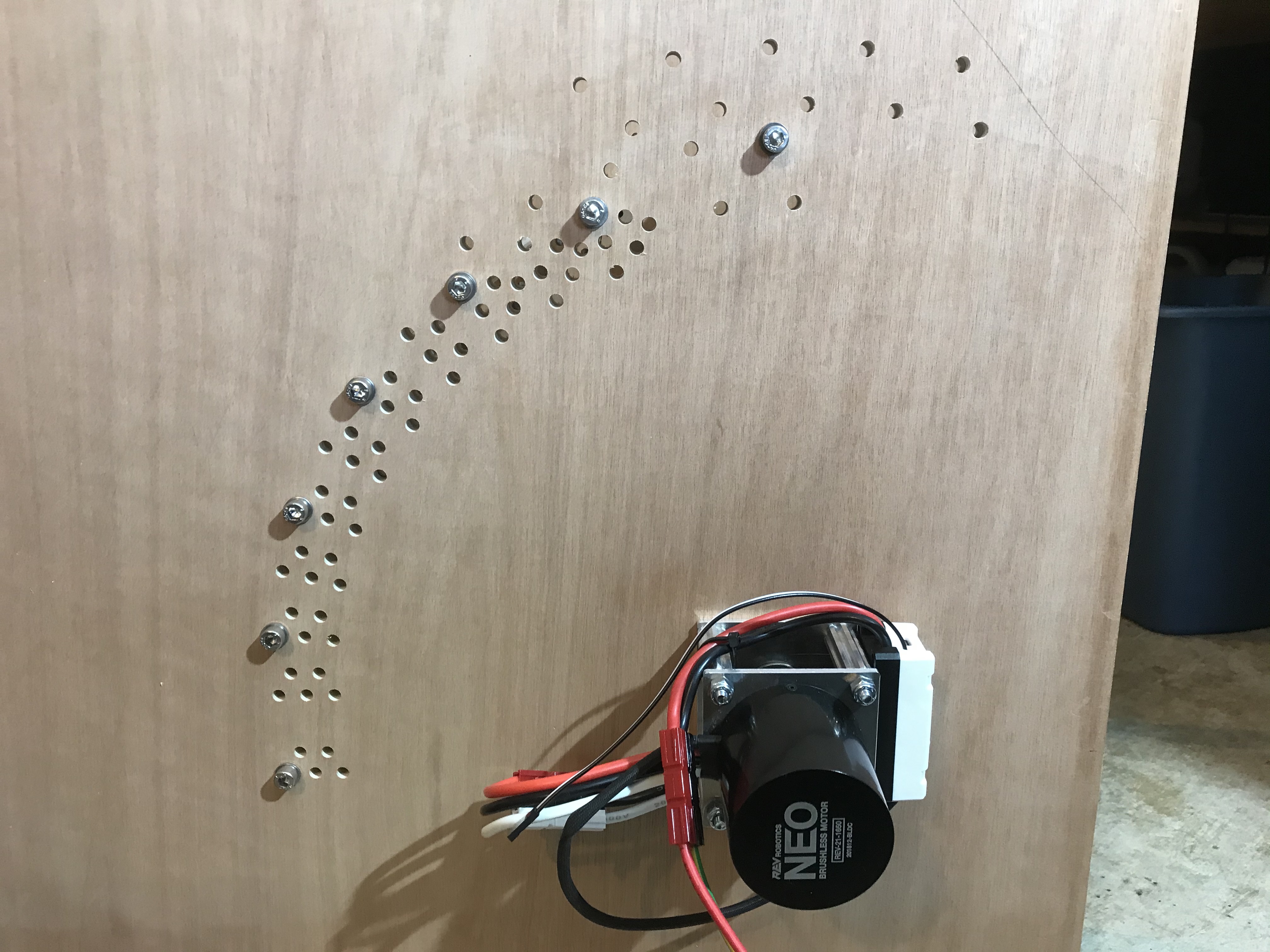

Our plan for our prototype (which might be together by the end of today) is to use a similar design to yours, as far as the wood goes…but add a couple more 2x4s between the plywood end plates, and screw an old piece of polycarb to it in an arc. We can then easily move the 2x4s around to vary compression, entry/exit angles, etc.

We actually already built it and are having problems with it that you can check out in this other active thread :wink:
Since the rails are simple arcs, they can be manufactured with a handheld jigsaw and a drill press. The backing of the handmade rail may not be as elegant as a CNC’ed rail, but the rail itself is just as effective.
oh…that explains everything! We all assumed you had a nice polycarb backed mechanism in the other thread, now we see it’s a rail system, and the ball is getting stuck in it, causing the breaker popping. Try a polycarb back, and see if it fixes your problem
I wish, but the breakers pop while the wheel is spinning up, before the ball is even put into the system. Oddly enough, when you ramp it up really slowly it works fine when you put balls into it

Plywood and AM churro spacers. Polycarbonate backing cable tied to the spacers and it’s done. Hole pattern to match what compression range and contact arc you want to test.
Successful 6m range achieved with this test rig.
