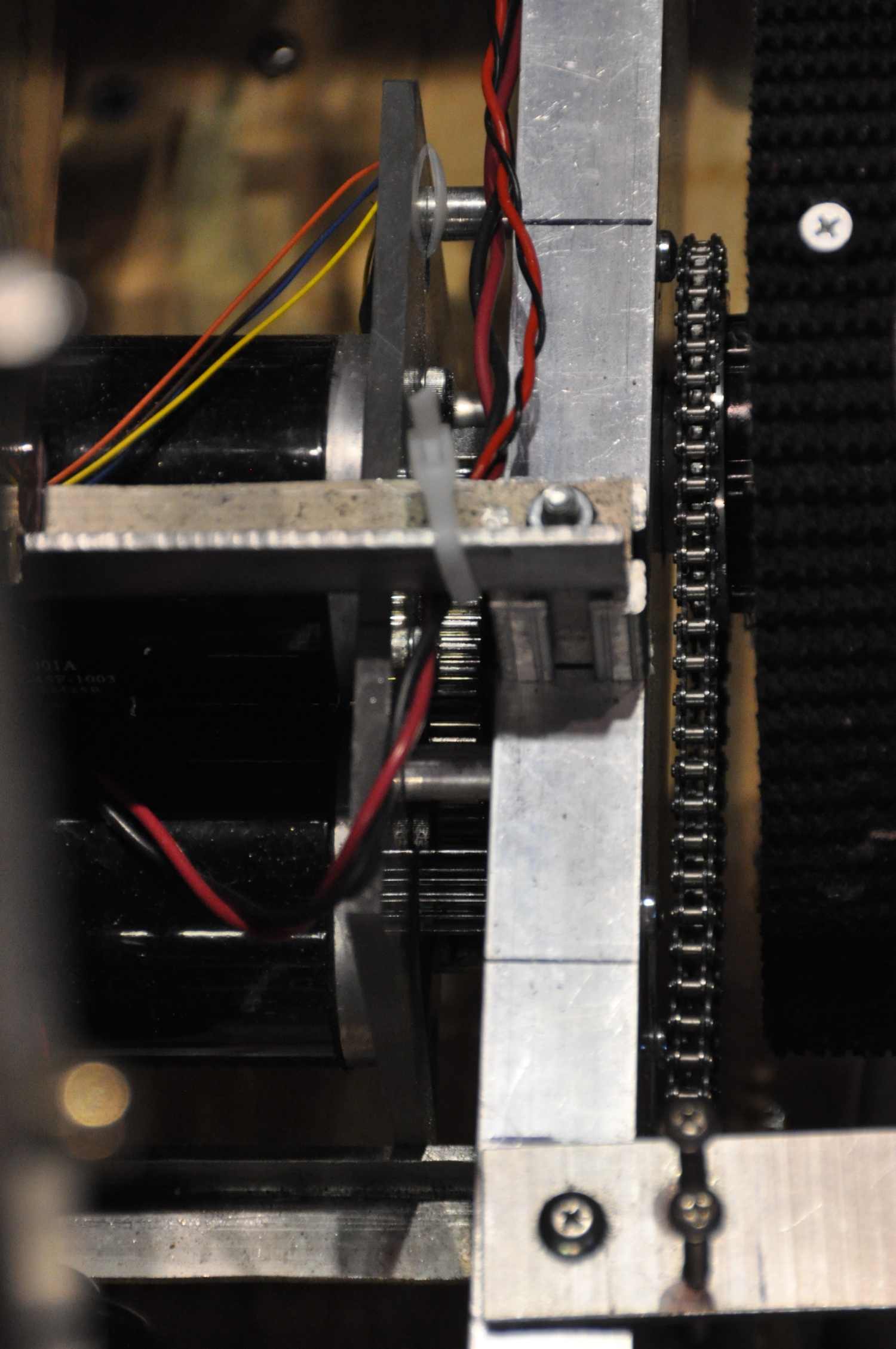

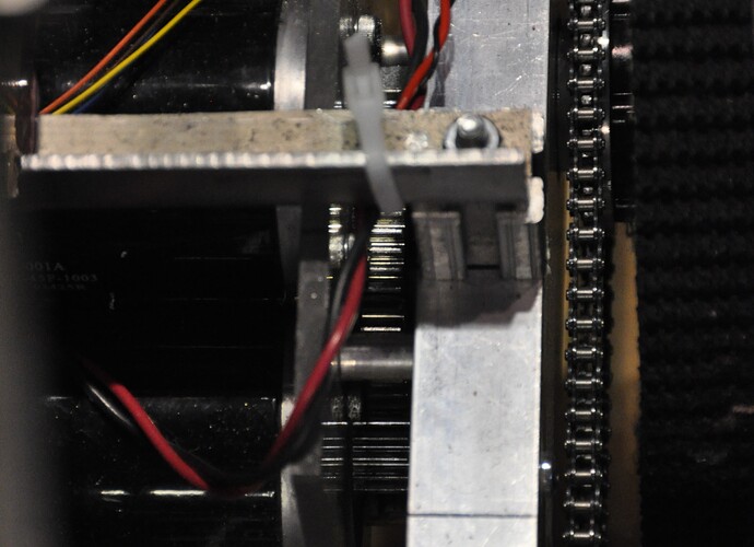

you mean something like this?:
This year our team decided to integrate the gearbox into our chassis rail and use a piece of polycarb as the other side wall. It took a couple of tries for our students to get the hang of drilling the holes, but we never had any problems with the gearboxes.
