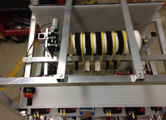

This is the problem we’ve had this year; we’ve tried to fix it by limiting the cord’s ability to walk.

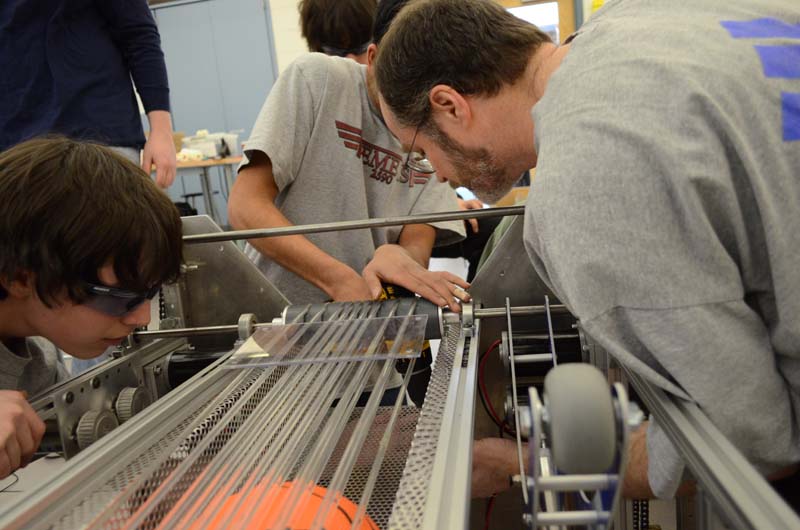

We’re using a “comb” to keep the cords in place, at one end. They run on very simple ABS rollers. We used the connectors and hollow cord, and only about 3% stretch.
Do you have a photo of this comb? (We used 5% stretch, though our belts are welded.)
sure…I have pics of almost everything!

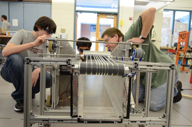

Here is a picture of our “comb” for the belting. It will walk a little if a ball goes through, but it then walks back.
We are using 3% stretch on solid “welded” polycord. All seems well. What do others see as the advantage of greater amounts of stretch?

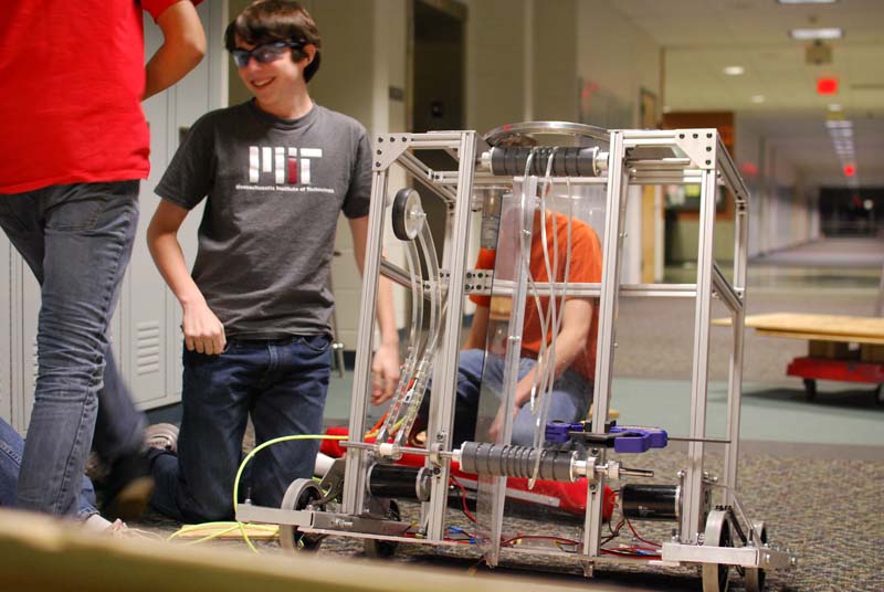

For teams with a lathe, cutting channels for the polycord works well. We used mcmaster #8749K17 PVC pipe along with andymark hubs for 1/2" keyed shaft (drive) and 1/2" ball bearing hubs (idler). The hub OD is 2.25, so it was a nice match for the 2.25 OD, 1.125 ID pvc pipe. We used clear 1/4" polycord and fused the ends.
If you have a mill, just use a 1/4" ball end mill to cut a 1/8" deep channel in two blocks of aluminum, then you can heat the ends resting in one channel, push them together, and then cap it with the other piece of aluminum so that the fuse is nice and round.
We used way more bands than are necessary, 1 or 2 would be plenty.

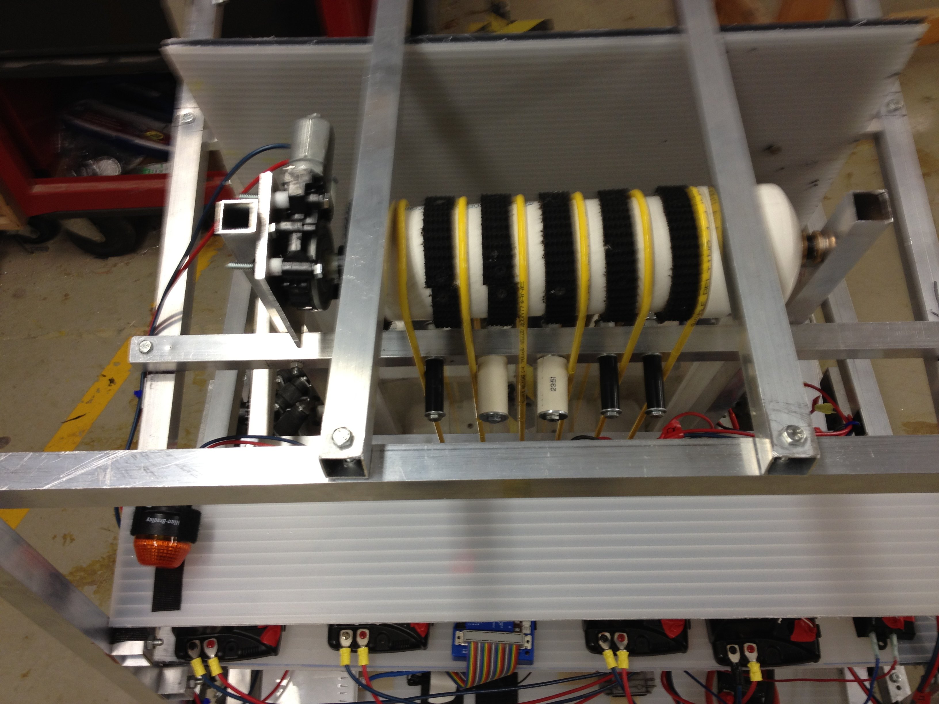

We used solid poly cord in '09 it worked well. Welding it was a bit of pain so we decided to try hollow cord this year. It has been working great. We use 5% strech, it works fine. To keep it in place we simply drilled 2 .250 holes in our Aluminum pipe roller on either side of the cords. We cut a short length of cord and stuffed on end in one hole, wrapped it around the pipe and stuffed the other end in the other hole. It works great, the poly cord stays in place and the short lengths have not slipped out at all.
Forgive the image, the photo has a bag between the bot and camera :wink:
