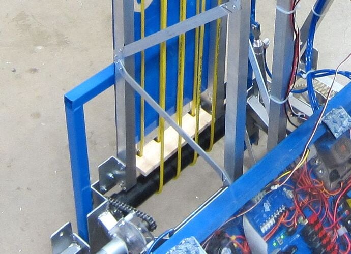

3% stretch is working ok for us. We are using 1-1/2" ABS (about 2" outside diameter) rollers that are about a foot long. We’re using ball bearings in end caps to support the rollers. We don’t have any grooves in them, instead we have a simply plywood “comb” above the lower roller to keep the cords in place.

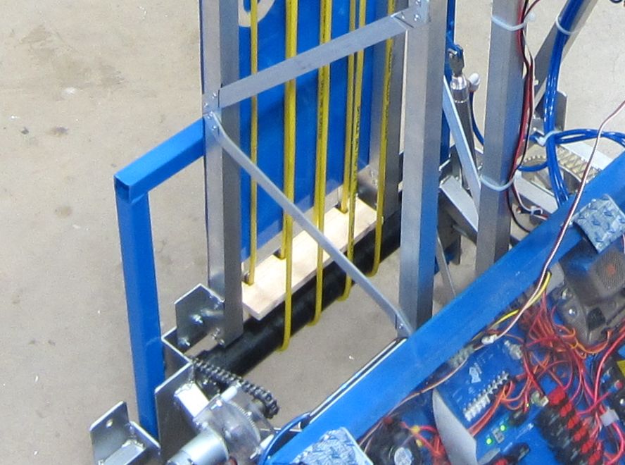

How about a picture of the “comb” Does it help rerail derailed cords?

Here’s our comb. It doesn’t allow the cords to derail, they’re pretty well contained. But you have to experiment to figure out if it will work for you, it will not prevent the cords getting tangled up if for example the balls are trying real hard to push the cords sideways.

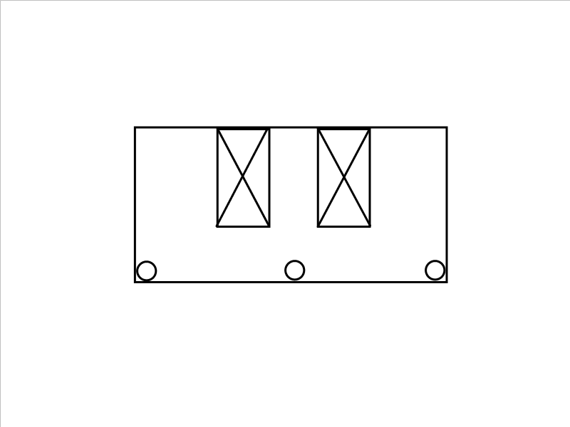

Here is sample of ours from a past robot.
The rectangles with the diagonals are cut out to create gaps for the cords to move through. This particular one was designed to keep two bunches of cords together, not space individual cords. The final version that was use was significantly less material but this was the first iteration.
Circles are rivets to attach this to the bottom (or top) of piece spanning the run.
We usually make the comb out of hdpe or nylon.

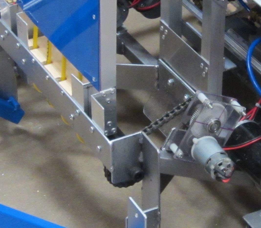

Jim (Mr. Forbes), what motor and gearing is your team using to drive the polycord rollers? Are you using solid or hollow (tube) polycord? Does thickness play a big factor, We have 1/4" tube, but have yet to fabricated lifter (hopefully tonight). Thanks.
This post kind of describes our system.
There is a 9 tooth sprocket on the transmission, and 22 tooth on the roller. We are using hollow 1/4" round urethane belting from McMaster-Carr.
We haven’t experimented with different sizes, we just used what it appears that other successful teams have been using for several years.
