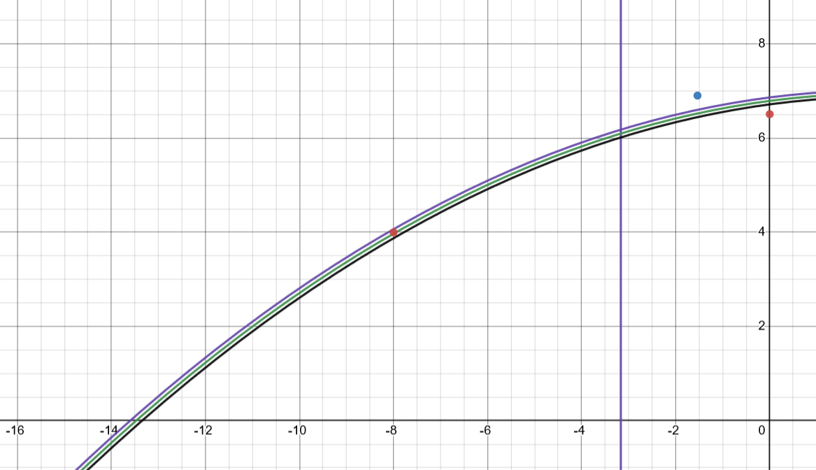

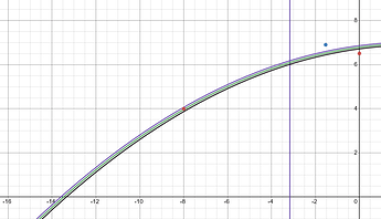

The defender doesn’t need to touch you to prevent your shot from going in, and if your shooter is low or really fast, the defenders don’t even need to be near the podium to block the shot.
30ft/s shot from 2ft high from the podium gets blocked from 3ft away, upping that shot to 40ft/s allows it to get blocked from 4.5ft away, extrapolate for lower or faster shooters as you desire.
I encourage you to look how much space is on the field in those areas and how little it would take to result in contact.

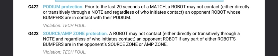

And if you’re too close and the shooting robot is able to touch you, Tech Foul. (Also if they’re able to put a note against you while still being in contact with the Podium.) As long as they’re in contact with the Podium (or in the Amp Zone, at all), the Tech Foul is against you.
Oh, and to make matters worse: If it’s in the last 20 seconds of the match, Stage protection applies instead of Podium protection. Stage protection means 2 tech fouls… unless it’s a qual match when an RP is added.

Most other angles end up being even easier to block, with a high yet slow shooter mounted to the back of a robot being about as unfavorable as you can get (almost every team will have a more forwards shooter and many shoot much faster than 30ft/s). Also remember that anything that can block the ring will also block the apriltags. A decent driver will be able to keep enough distance to not be anywhere near the podium and still block most shots from the podium while being in prime position to drive into or in front of anybody trying to take closer shots (and bad drivers shouldn’t be playing defense at all, but this has always been the case).
