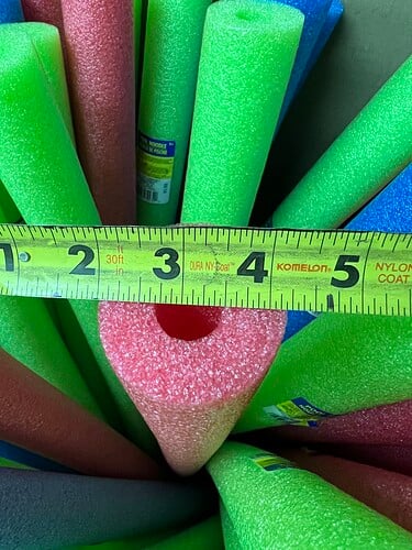

As per other posts, these “Big Joe” pool noodles: https://www.amazon.com/SwimWays-Standard-Swim-Noodles-Pack/dp/B01BY1S2US don’t measure up. I measured each of the 35 in the box and they ranged from 2” to 2-1/8”. None would be within the new 2023 noodle diameter range of 2.5 in. +/- 0.25” (2.25” – 2.75”). If you have these noodles double check your measurements and plan to source some more. I would not recommend teams purchase these for use in their bumpers next year as they do not appear to live up to their advertised diameter based on the 35 samples I received and reports from others here on CD.
The second set I purchased were these: https://www.amazon.com/Oodles-Noodles-Deluxe-Foam-Pool/dp/B01L094C62 “Ooodles of Noodles” brand. There were 6 noodles in this pack and all measured between 2-3/8” and 2-9/16”. All would be well within the new 2023 noodle diameter range of 2.5 in. +/- 0.25” (2.25” – 2.75”). If you have these noodles double check your measurements and hopefully you will be good to go. My belief is that the “Oodles of Noodles” brand of 2.5” pool noodles are measuring up to the FRC legal 2.5” +/-0.25” requirements.

I will attempt to provide some answers and hopefully clarity here. The previous (2022) rule (R408-C) stated:
“use a stacked pair of approximately 2½ in. (nominal, ~63mm) round, petal, or hex “pool noodles” (solid or hollow) as the BUMPER cushion material (see Figure 9-7). All pool noodles used in a BUMPER set (e.g. red set of BUMPERS) may not be modified (with the exception of cutting to length or cutting to facilitate mating pool noodles at the corners as required by R409) or deformed and must be the same diameter, cross section, and density (e.g. all round hollow or all hex solid). Cushion material may extend up to 2½ in. (~63 mm) beyond the end of the plywood (see Figure 9-8). To assist in applying the fabric covering, soft fasteners may be used to attach the pool noodles to the wood backing, so long as the cross section in Figure 9-7 is not significantly altered (e.g. tape compressing the pool noodles).”
The addition of the +/-0.25” “tolerance” in 2023 is to place bounds on “approximately”. It has been observed that, over time, the manufacturing of 2-1/2” pool noodles have strayed beyond what was intended as “approximately” or “nominally”. In essence, pool noodle manufacturers are now frequently “cheating” by advertising pool noodles as 2.5” or 2-1/2” when they are not even “close”. A 2” pool noodle (20% off the advertised 2.5”) was not originally intended to be “approximately” 2.5”. It was not that the pool noodles that teams used in the past that were 2” or 2.1” or 2.125” were “legal”. It was that there was no bounds placed on “approximately” or “nominally” so that distinction was open to interpretation from event to event, RI to RI, LRI to LRI. By now placing the +/-0.25” tolerance, there is an objective criteria in the rule that can be met without subjectivity. The FRC community requested that the robot rules be examined and edited such that there was as little subjectivity as possible. Responding to that, this is one of the areas that was clarified. Further, LRIs are trained, like I stated in this post that RIs shouldn’t be having teams tear apart their BUMPERs to measure the diameter of the pool noodle inside. If teams now know that they need to use pool noodles that are 2.5” +/-0.25” (between 2.25” and 2.75”) then they know what is expected of them. Previously a team’s and RI’s only measure of expectation was “approximately” 2.5”. If a team is super concerned they could keep a scrap piece of the pool noodles they used in their pit to show an RI and for easy measurement so no BUMPER disassembly should ever be needed unless an actual issue is discovered and needs to be corrected.
