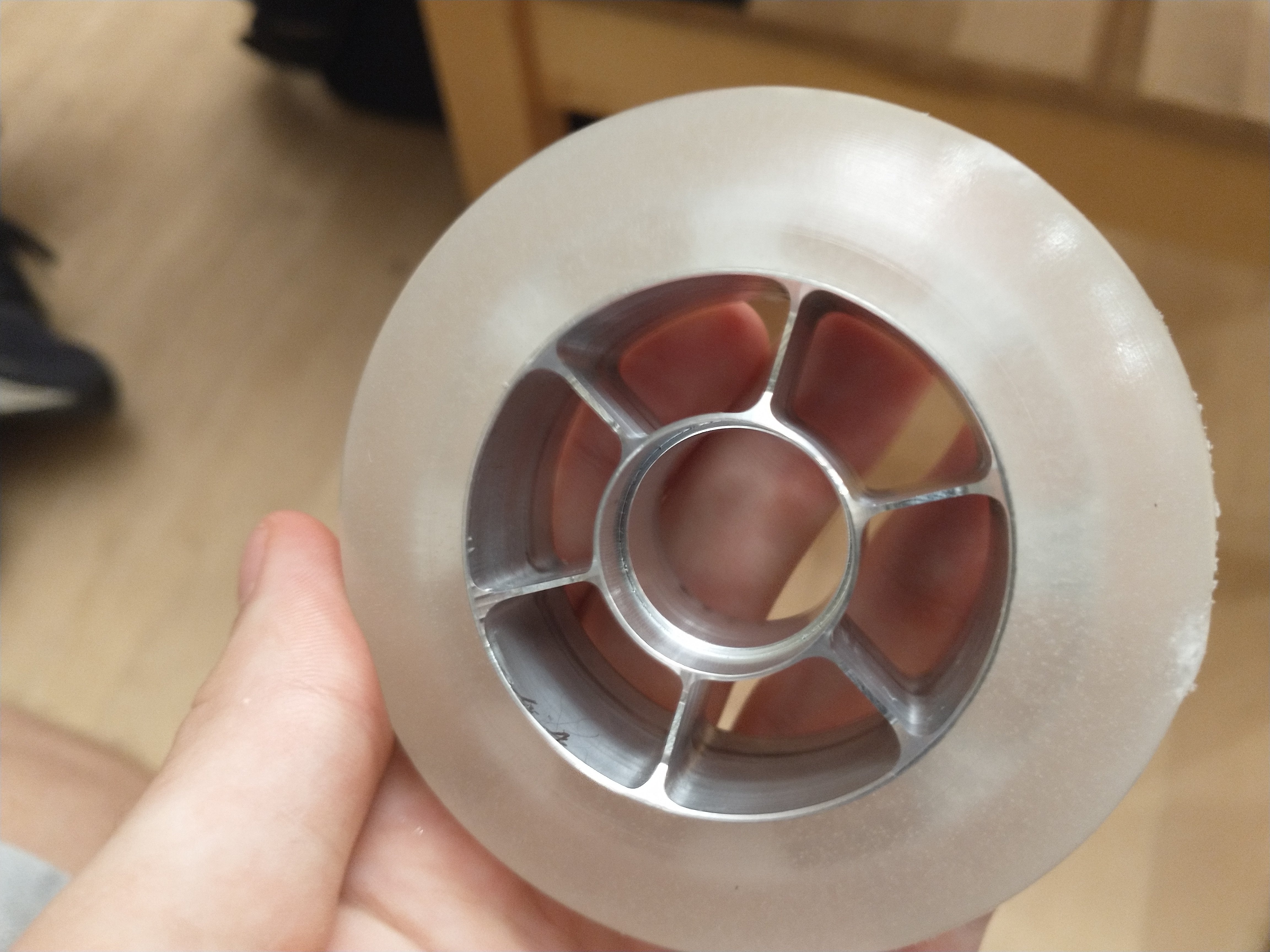

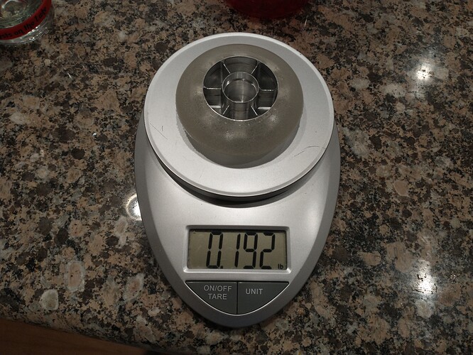

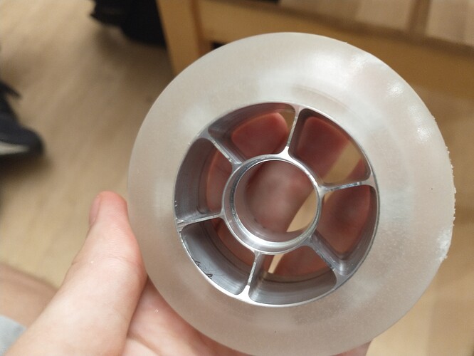

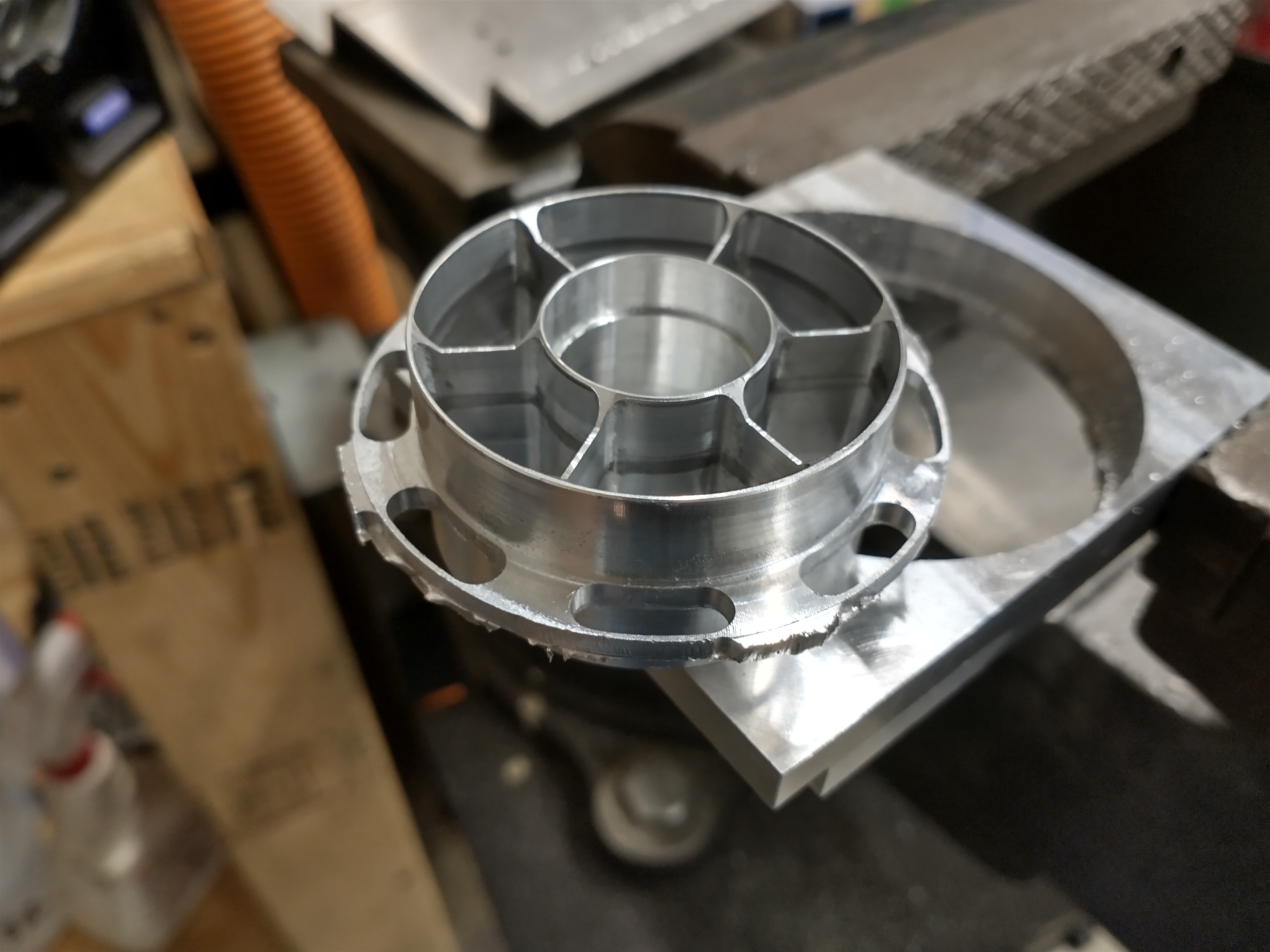

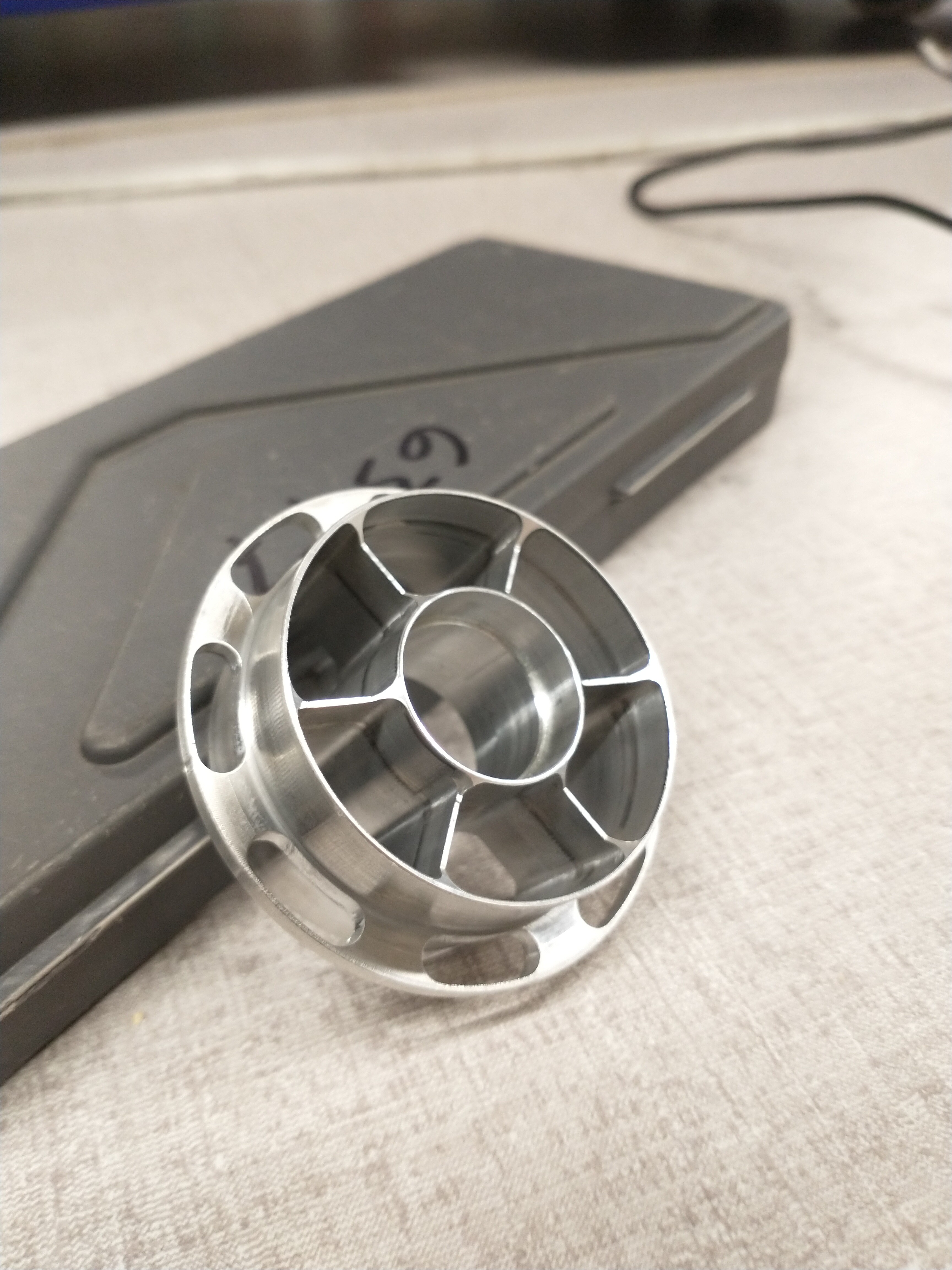

Inline skate wheel and molds, two setups in the 3-axis mill for the hub. The spokes are 20 thou at the thinnest point and 0.04lbs.

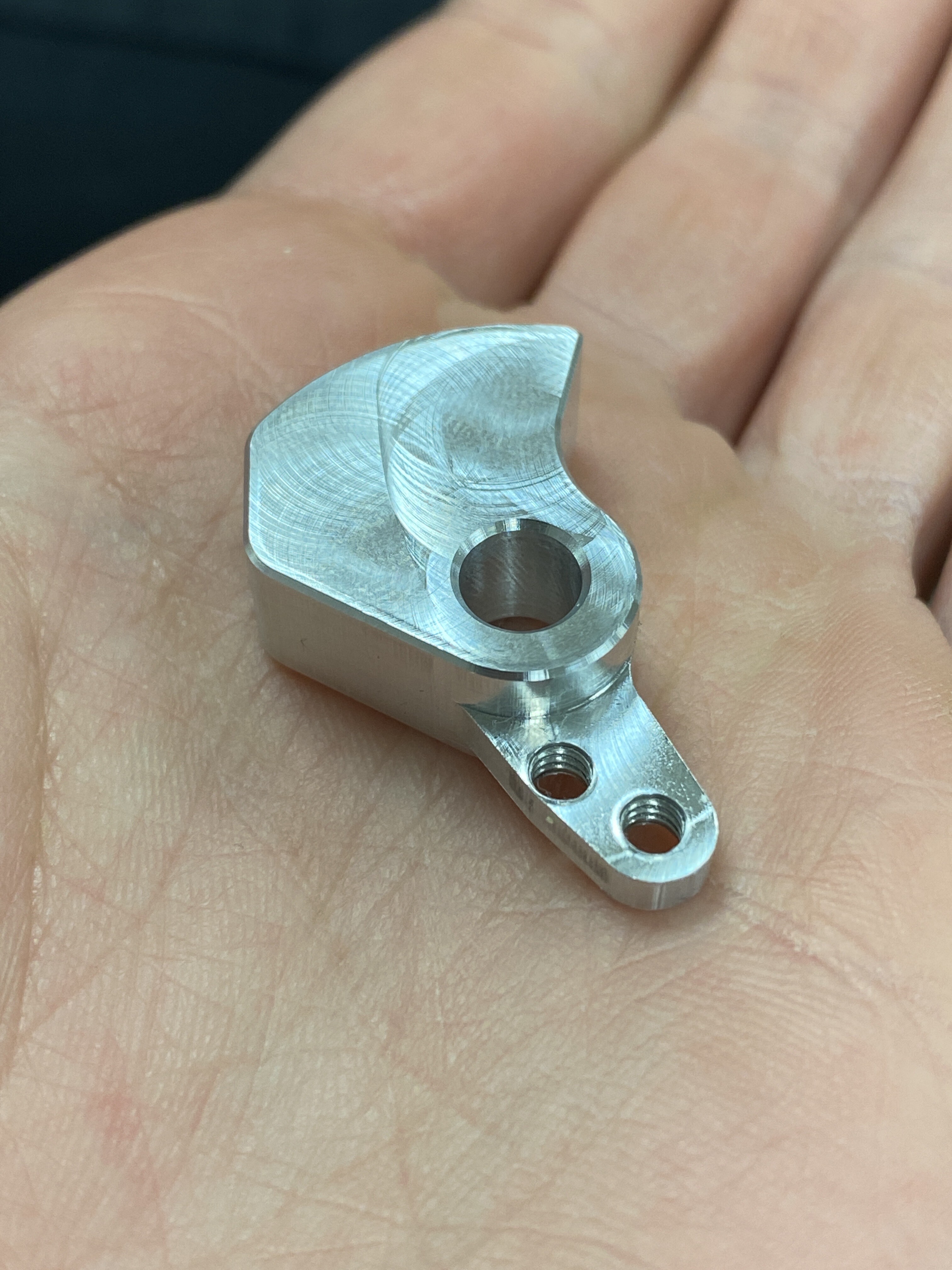

Latch for our 2022 climber (helped us hit a 2.5 second Traversal climb)

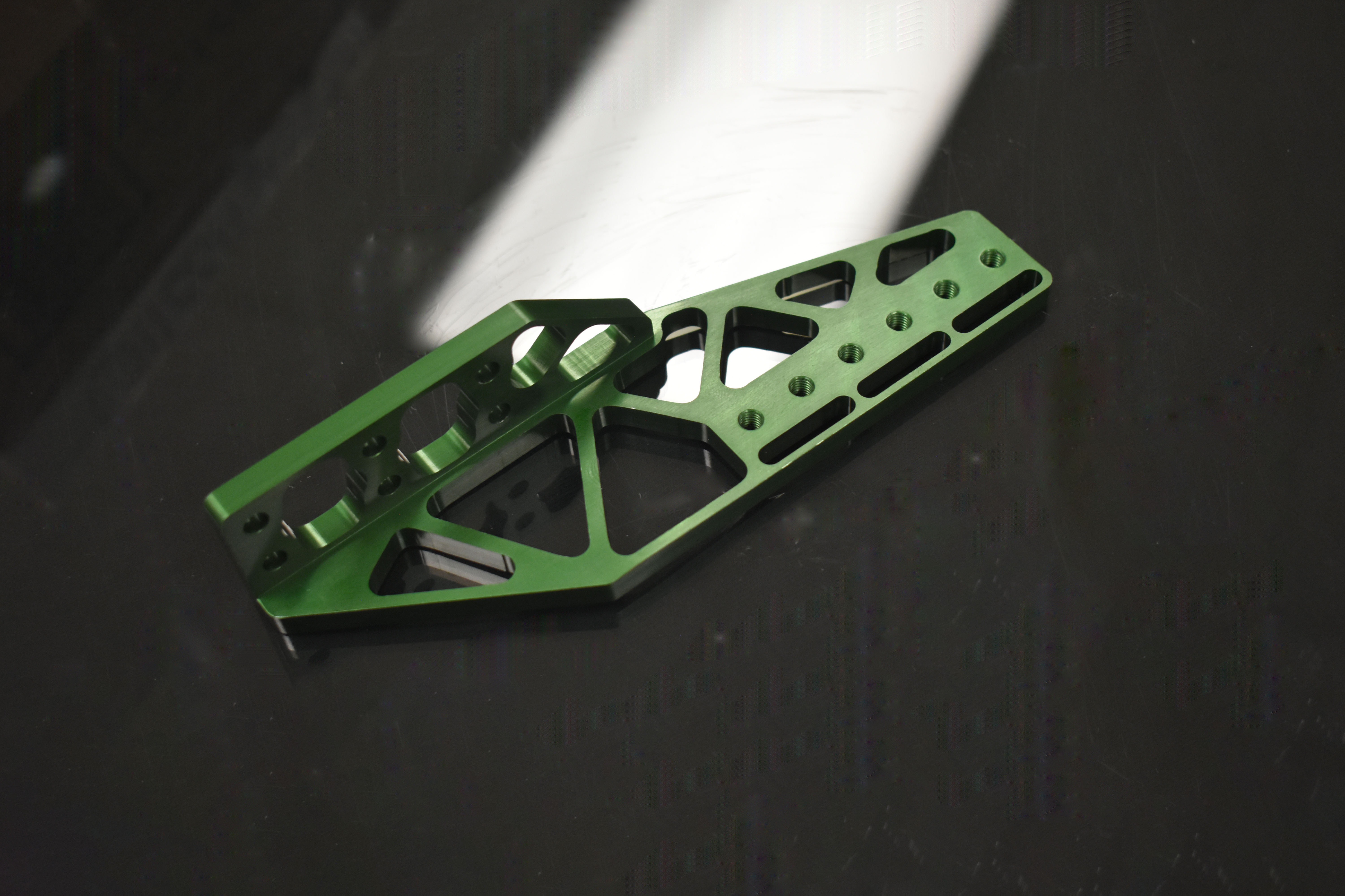

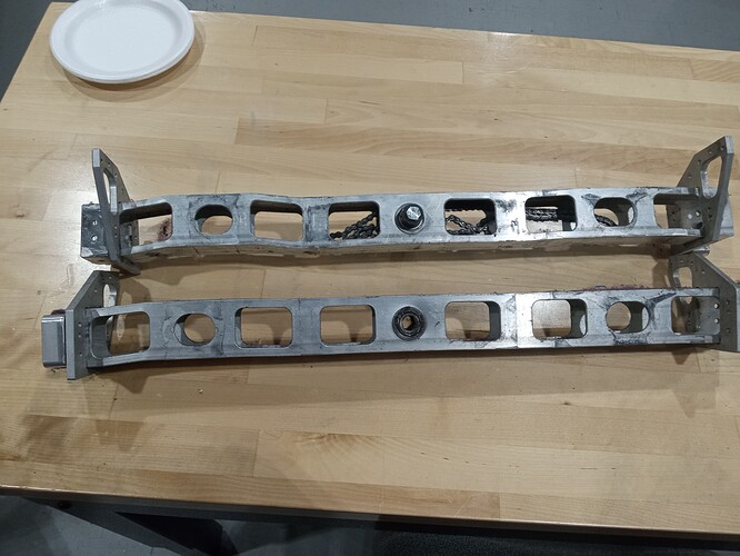

Shooter mount for our 2022 robot. ~90% material removal from raw stock, took 4 setups to reach all geometry

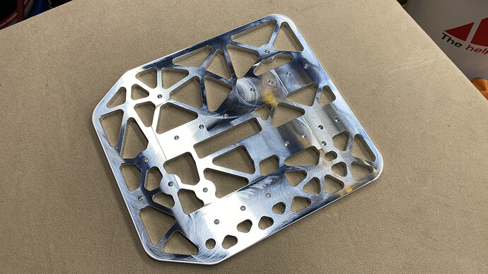

Engine mounting plate for a personal project. ~10"x12"

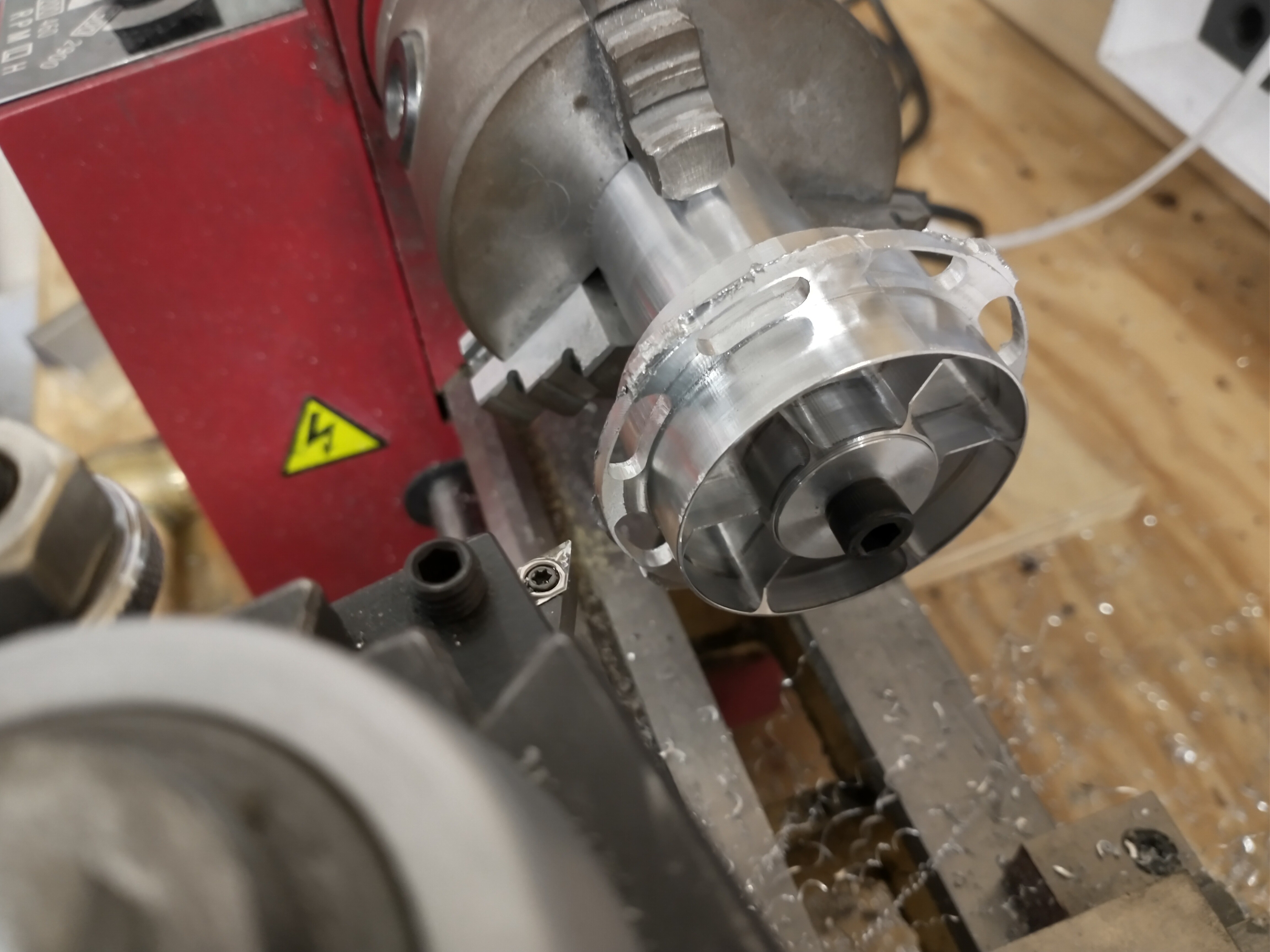

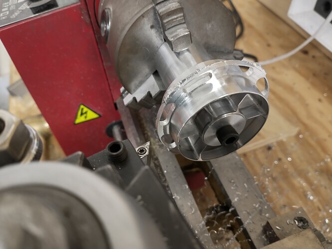

Curious how you are holding for the 2nd op…
Excellent job!
For the first prototype we held it with tabs to make it simple, then finished the OD of the hub on a lathe, there is space on the hub for 8 threads to attach it to a fixture for second op.IMG_20220626_200233160_HDR|666x500

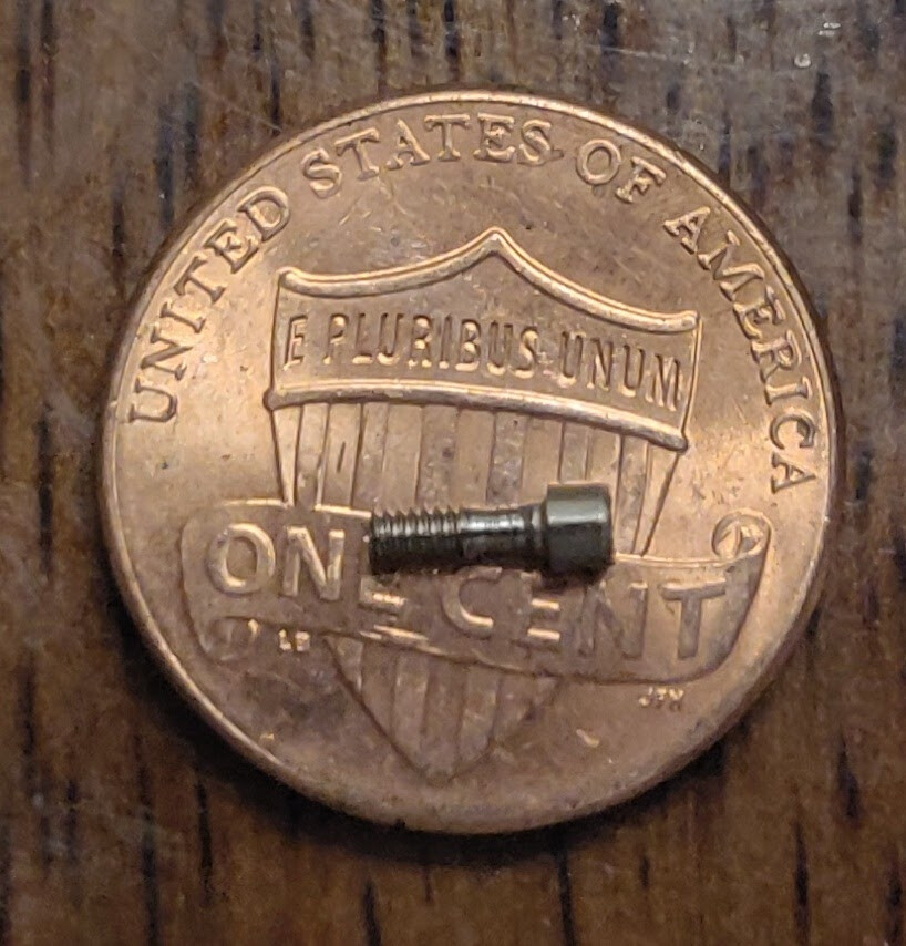

Captive screw for a special fixture.

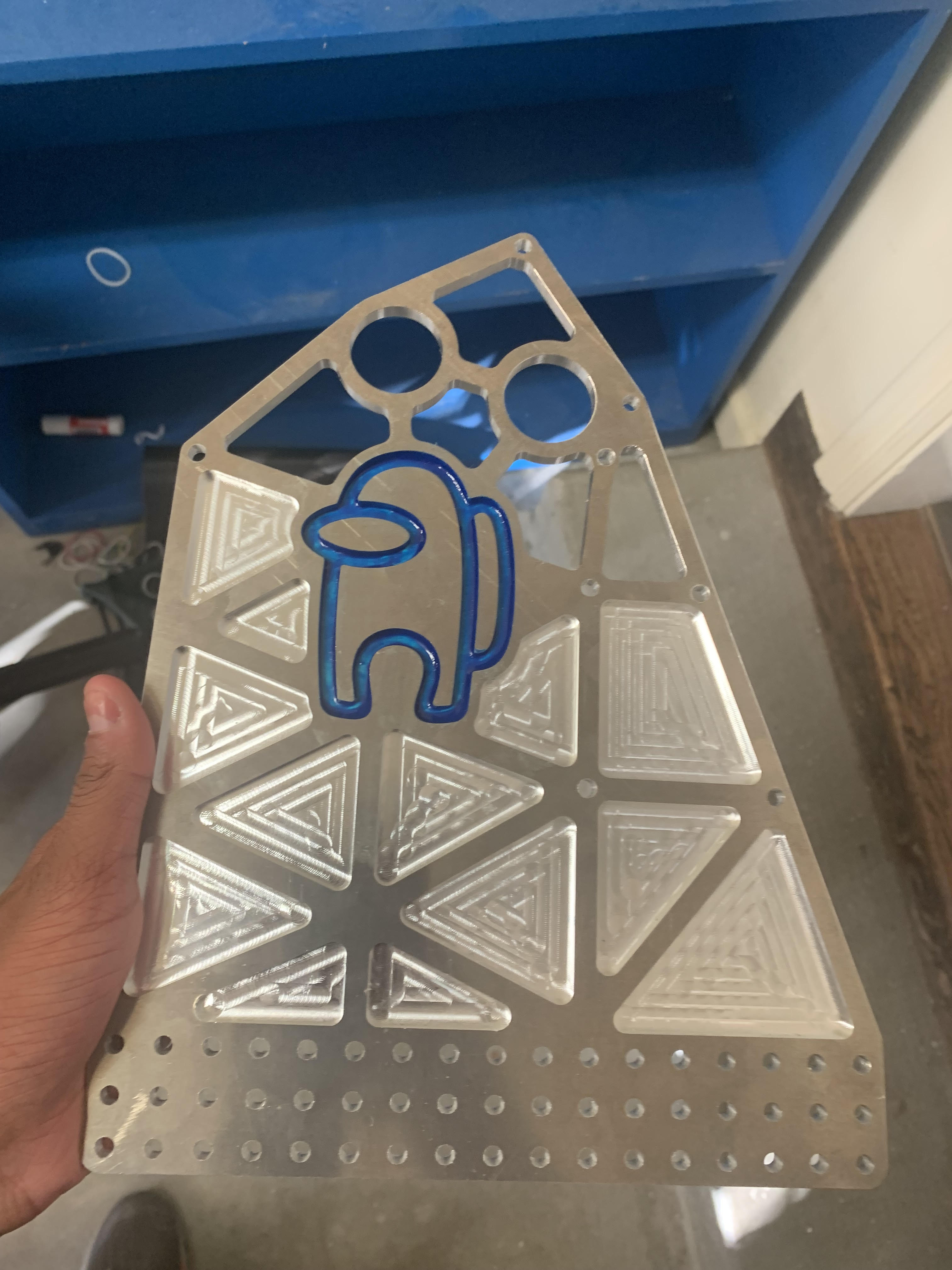

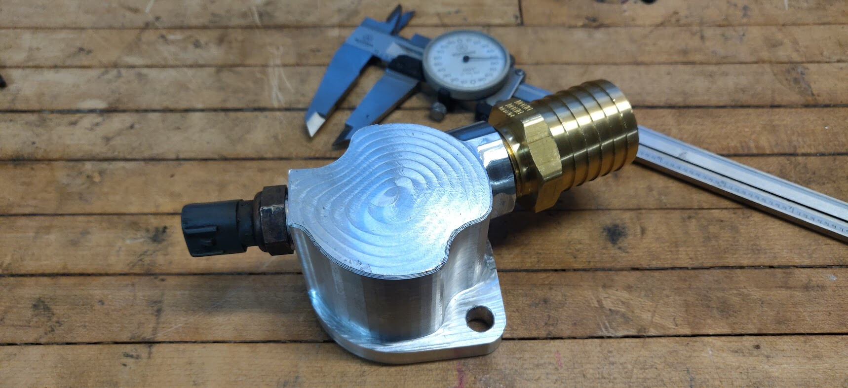

Water neck for my racecar, this required four setups and some long reaches.

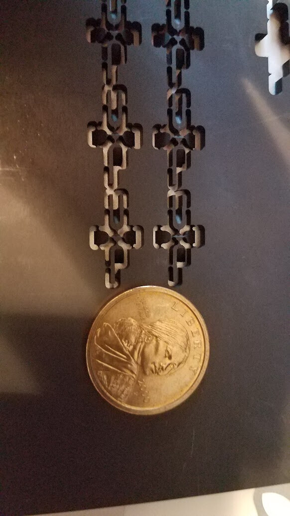

More adventures in work holding:
Though, in fairness, I bought the penny specifically for these sort of threads.

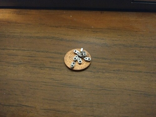

To put some numbers on this: the largest hole is tapped for 0-80, the middle hole is for a 1/32 (?) pin, and the smallest hole, .013in, is barely visible.
It was VERY hard to mill those curve profiles into the 2x1 :stuck_out_tongue_winking_eye:

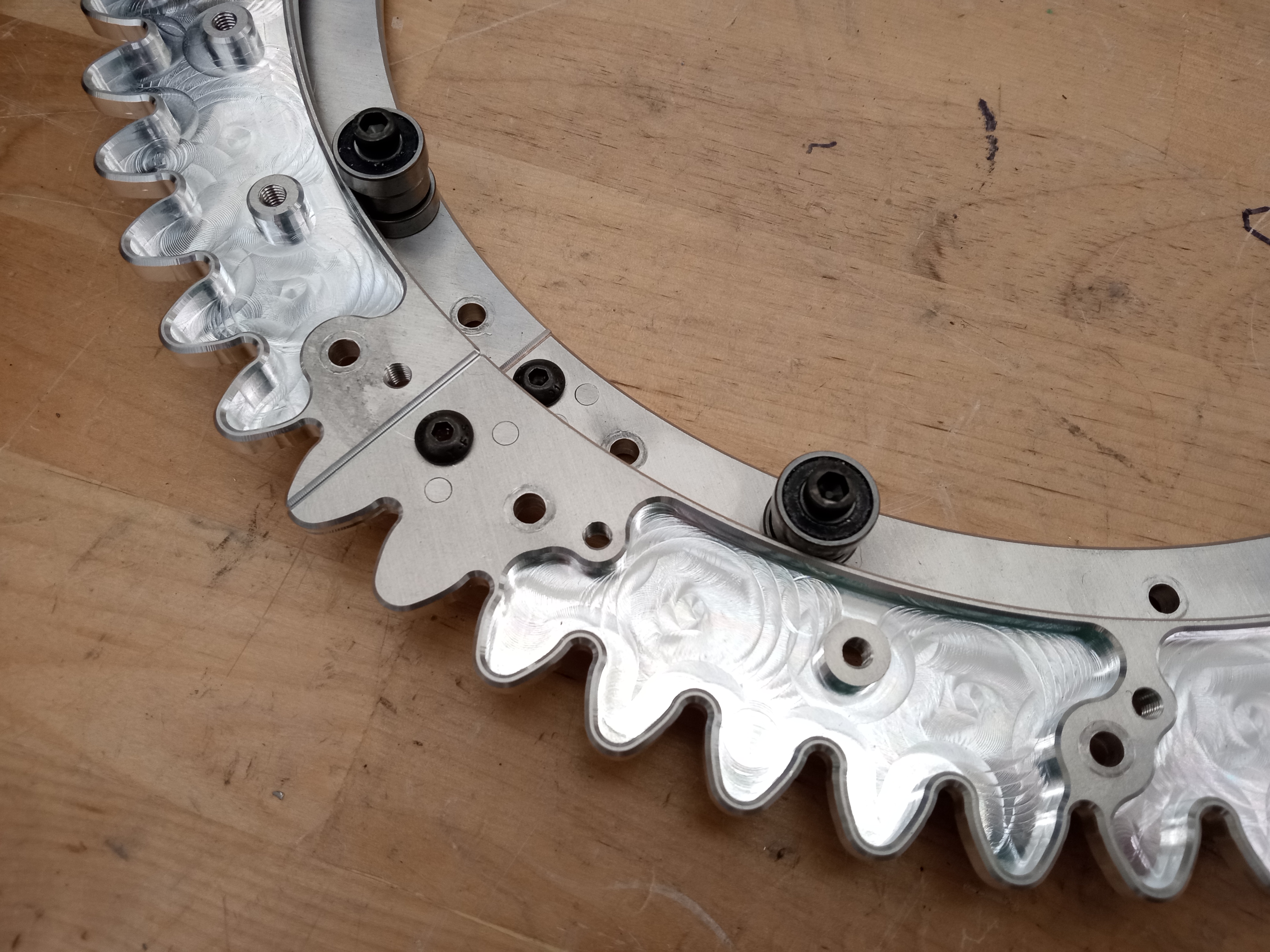

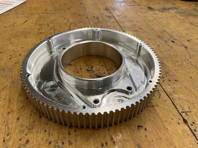

3 piece roller pinion gear for our turret with matching 3mm locating pins and holes milled into the ends. Visible near the button cap screw.

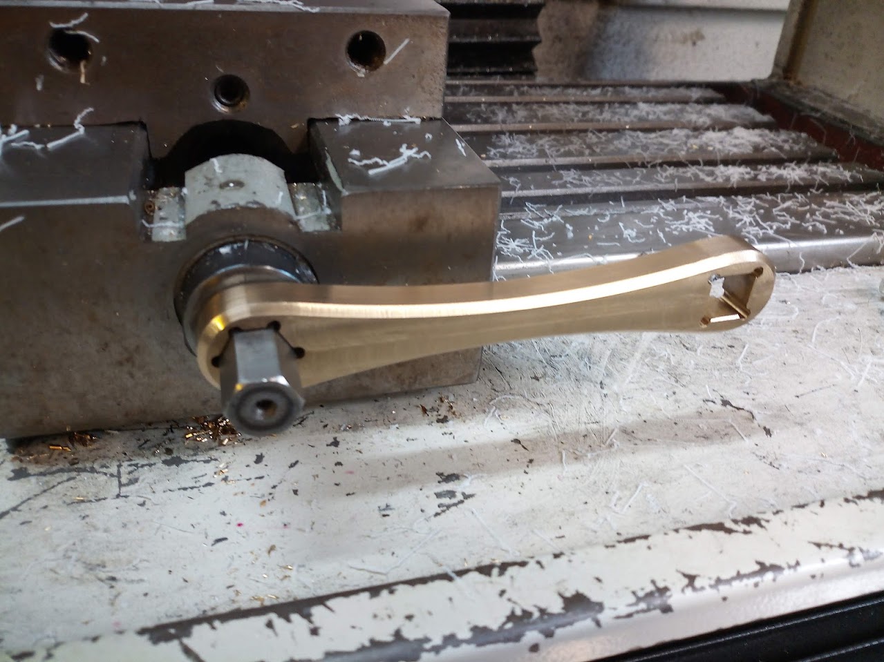

Not really a complex part, but it was a finicky thing to get the fit just so, took forever to make and I think it’s a pretty good example of ‘dog boning’ sharp inside corners.
It’s a combination wrench that fits the very oddball hex on the import vise the Tormach came with, and the square end of the drawbar. It’s my favorite shop made tool. Most Skookum.
