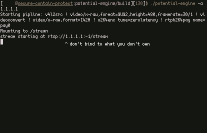

I’m having an issue with using potential-engine. It seems like my webcam doesn’t even turn on when the program runs, and aside from that it says it’s streaming on 0.0.0.0:-1 which I think is just a typo.

Gonna hazard a guess and say you cloned this today, so I won’t ask about what version you’re using.
The 0.0.0.0 part is correct, it basically lets your OS bind it to whatever address if you don’t give a specific preference (as I understand it.) The port being -1 is definitely an error though. What options are you using to launch the server?
Some easy reasons it would show -1 are something else running on that port (make sure nothing is using port 1181 or whatever you’ve specified) or the port you’ve given is < 1024 and you’re not running as root.
Your camera will not turn on until a connection comes in, for what it’s worth. I would encourage you to use “raw” ffplay or similar to test connecting, since it’s muh faster to start than our SmartDashboard hack.

#12
I was launching it without arguments and it still showed port -1, but what you say about the port already being used makes sense, since it only shows port -1 once I relaunch the program, not on first start. Maybe it’s because I’m using keyboard interrupt to exit it and the program doesn’t free the port?
I was already using ffplay, and the program was 1.1.
Edit: Just tried it again with a fresh boot and it still showed the port as -1. But when I specified in the command that the port is 1810 or 1812 for some reason it showed the port is 1811.
I have another question, is the ip address in the command supposed to be the raspberry pi or is it supposed to be the receiving driver station?

#13
That’s very strange, I’ll have to investigate this. You shouldn’t need to reboot to restart the server, CTRL+C (SIGINT) is good enough to stop it and free the port. You can use various methods to see if something is still squatting the port after CTRL+C.
It should be the address of the Pi. You do not need to specify this option at all, the default behavior is “bind to whatever’s available.” There should be no need to specify the address option for most teams, and it’s really only there for people who are doing crazy things with networking.
Also, if you specify an address the server doesn’t “own”, the port fails to bind and you get -1:
The simplest way to combat this is to not specify an address in the first place, and let it bind to 0.0.0.0 where the server will be accessible at any address the Pi “owns.”
