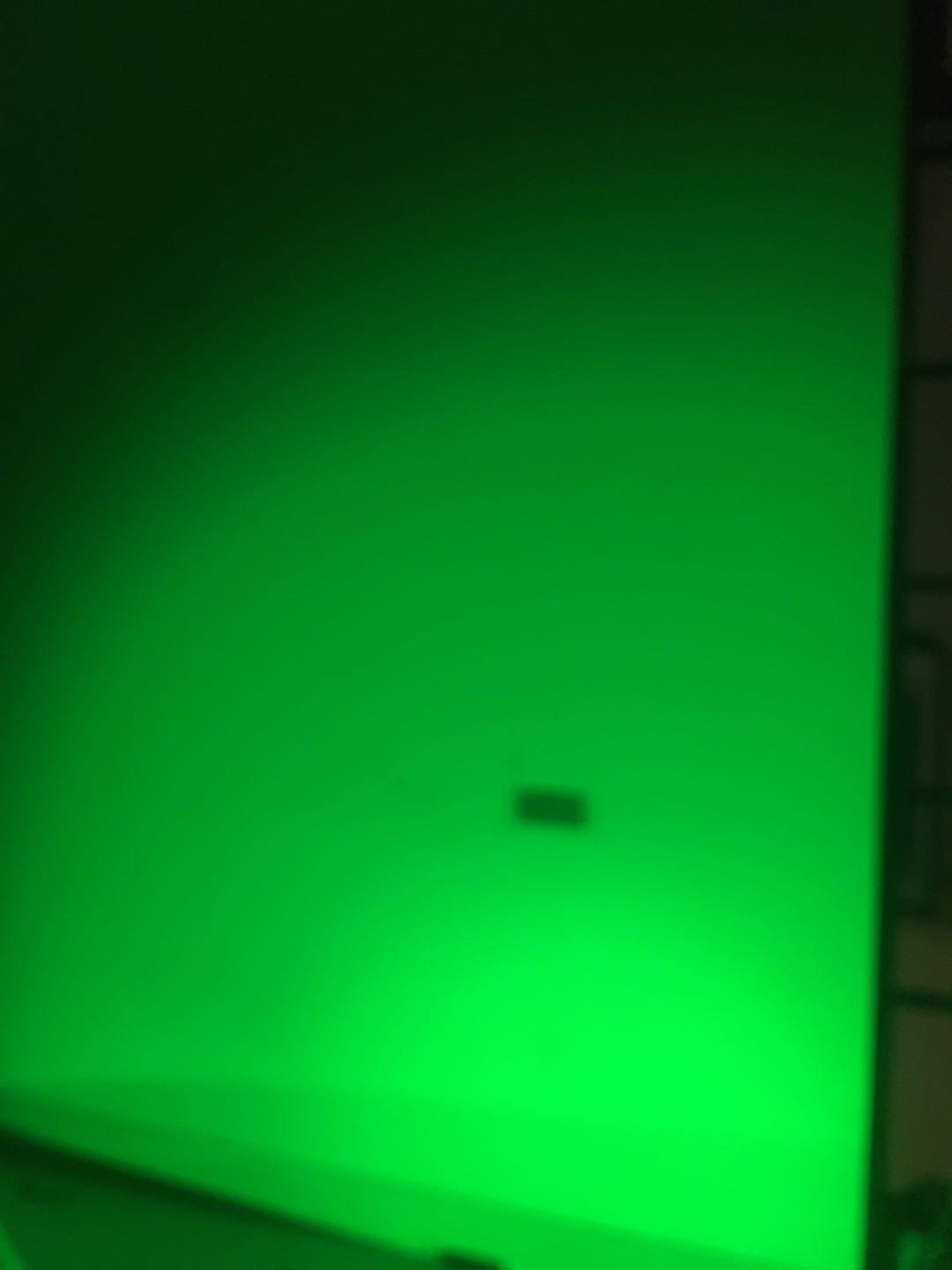

Using a recent PhotonVision Beta on a LL2+ I can turn the camera exposure to about 2.5, camera brightness 6 and LED brightness 20. The full cone target is shown and I can almost look at the LEDs.
EDIT:
In case anyone is wondering as I did and hasn’t been able to test - that diamond pattern on the new tape is very distinctive and blur will be needed to “erase” it. The aluminum pole is NOT retroreflective in any way like the tape. If the LED brightness is turned way up (too far up) you get a thin green vertical line from the center of the pole. The line is gone with reasonably lower brightness.
EDIT 2:
I remember the LL2+ software allows turning off some of the LEDs. We’ll be doing that. The horizontal range of the camera is reduced somewhat but we expect to be aimed almost straight on and my experiment now shows almost no difference with all the LEDS and half of them. Apparently older LL require that you cover the LEDs to turn them down or off.
We’ll try the light shield mentioned above, too.

to be honest didnt think about this till I saw your scientific diagram which makes things very difficult with the amount of cone nodes. I am a little confused why this may have not been thought of before realeasing the game. They may just change the material of the panel so drivers can see better when limelight is in their eyes.
