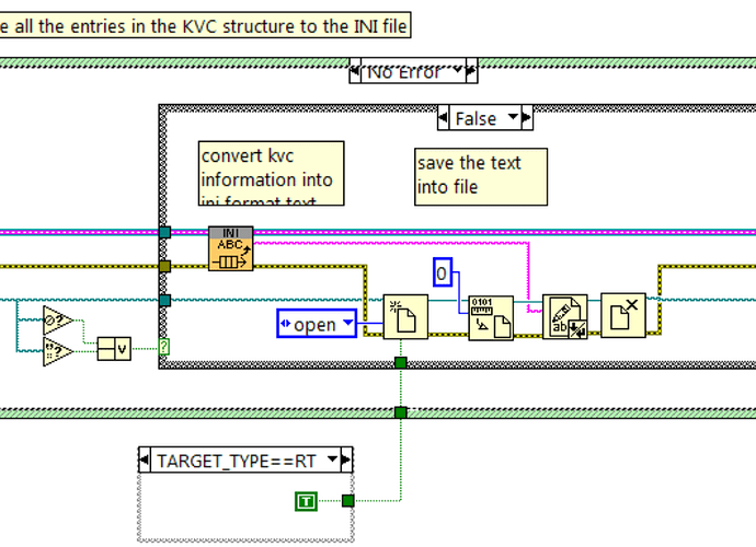

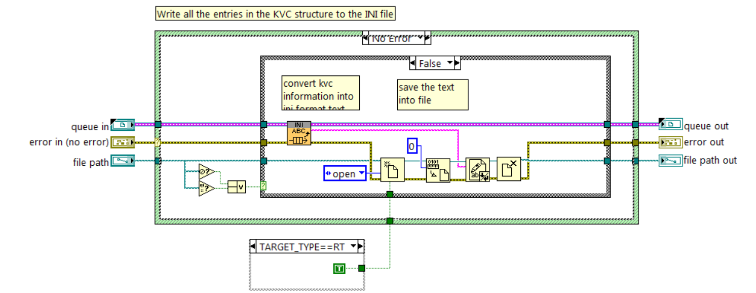

i made the change to Save Config File.vi however when i build i get the following error
the save config file.vi with the change can be seen bellow
any idea how to fix this
OK. I have had the edit and I’ve done desktop and RT builds with no issues. So I’ll PM to get more info on your system.
The original fix that is harder to describe is to make the value of the constant platform specific. The conditional disable structure with at symbol of TARGET_TYPE and a value of RT.
The attached image shows the T case. The default is F.
Please let me know you’re able to try that and the results.
Greg McKaskle
i was able to make these changes and have the model build. The values were saving over power cycle. Thanks you very much for your help with this
