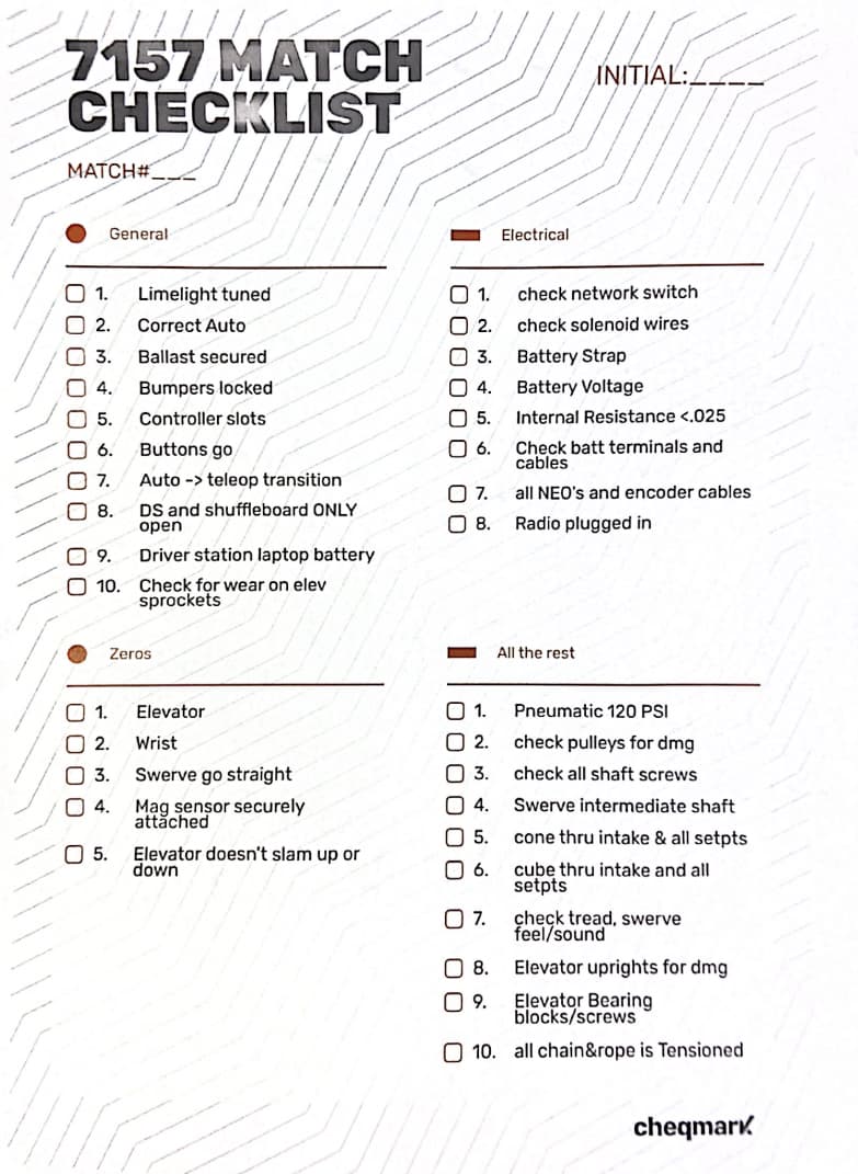

Assuming your team has one, what do teams put on their pre/post-match checklists? This can be as specific or as general as you’d like.
Our team currently has this:
Everything
This is last years Checklist, 95% of it is checked after every match. 1 Programming, 1 electrical, and 2 mechanical students go over it . It may seem like overkill but in the heat of competition you forget things, and if you forget twice it breaks when you aren’t looking. This process has directly saved ~10+ matches that I know of since 2017. And has helped catch small things that could have become bigger issues if not caught as soon as it happened.

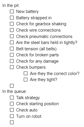

This is the first time we’ve used a prematch checklist, throughout comp we did add a few more things to it, but this is what we had originally. We’d have drive team and pit crew sign off on each before every match.
This is definitely a good start, but as Britt said, you want to be as specific as possible without getting into the weeds too much with what is on your list. That being said, I would take a team that had a checklist like yours over a team with no checklist or just a mental checklist, because in the heat of elims things get forgotten if they arent written down to be referenced.
One other addition may be to check for tools in the bot.

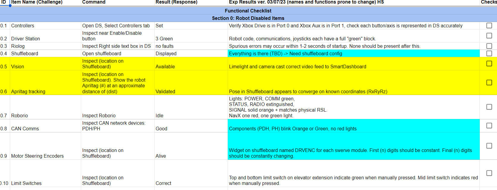

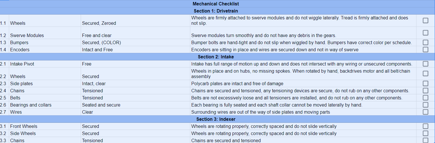

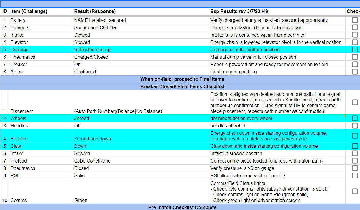

Ours is split in to 4 sections. We have a pit inspection (robot is off and in pit), functional check (robot is on and in pit), queue checklist and on-field final items. The first two are done under a read-do methodology by the pit staff, while the latter two are do-verify and run by the technician.
A few things I can note about writing these are to be specific (PDH connections - seated, tabs flush vs wiring - check), concise (Pneumatic vent valve - Closed vs make sure the pneumatic vent valve isn’t open) and ordered in a way that makes sense (don’t have battery - secured right before changing the battery!).
As for running them, ours are designed such that the most critical stuff gets caught once relatively early and again on the on-field final items. So all the “easy ways to lose a match” like putting in the wrong battery should be avoided. Once a team gets experienced with them, they can be done very fast without reference to the criteria.
Very heavy stealing from the aeronautical world :slight_smile:
