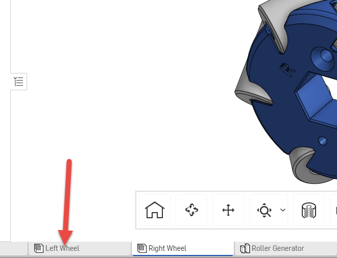

In the tab on the bottom labeled “Left Wheel”.
Thanks a lot

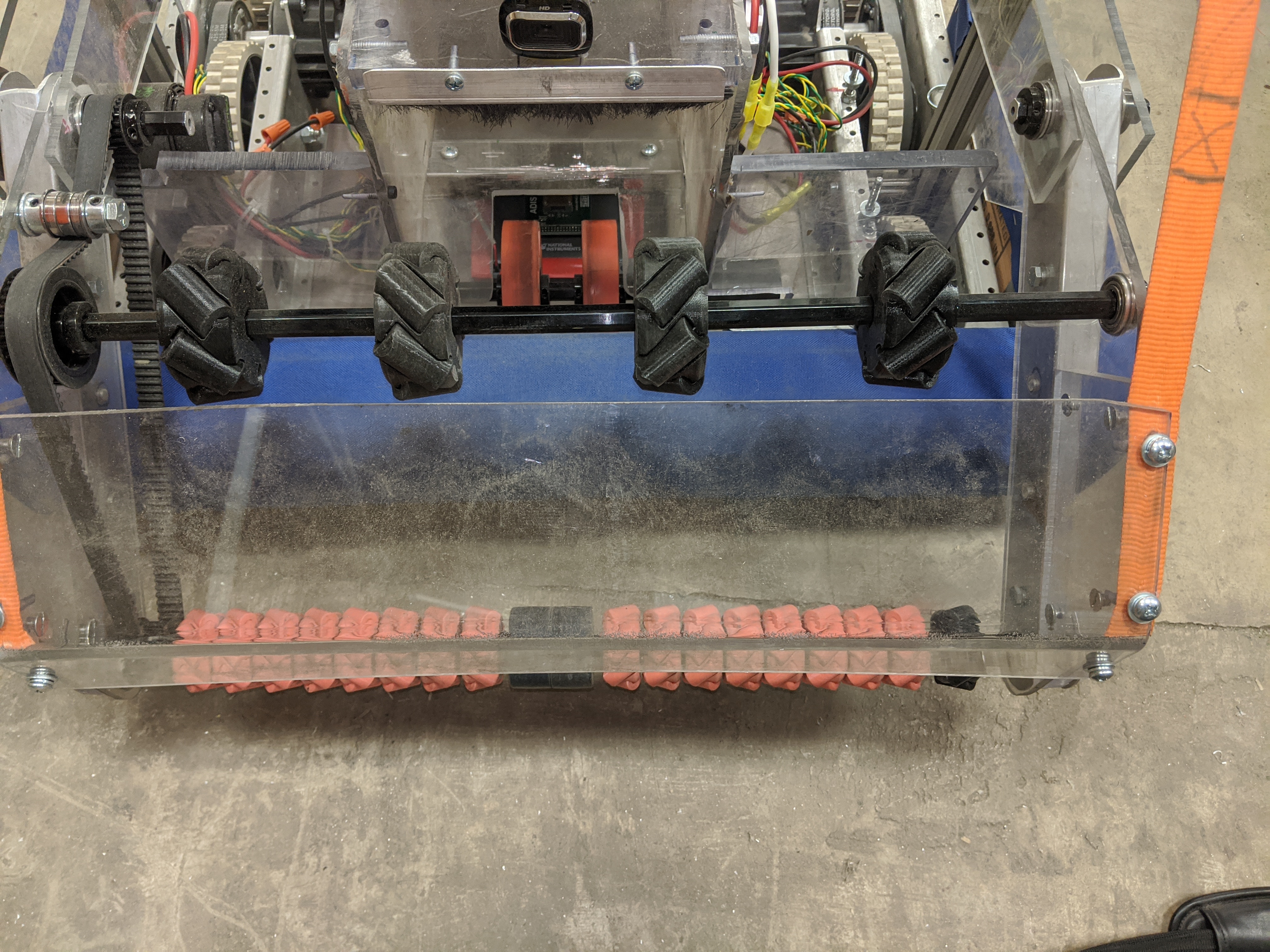

We’ve had incredible success with the split version of these wheels in our indexer. We have a couple on our intake too. One note-the screw holes don’t line up properly, so we had to glue all the wheels instead of screwing them together.

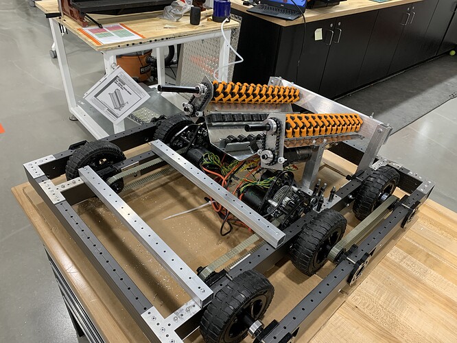

That is going to be the smoothest indexer ever, but it made my hands hurt even more just thinking about filing down the ends of every one of both ends of those rollers. What does that LEMON indexer weigh?
No filing at all; only the hex bores needed a bit of filing (there’s a 1/4" spacer between each mecanum) and the passive rollers were literally just long pieces of roller that we had in the back of our shop. It’s 10 lbs as of now (2 VPs with 775s and no pocketing on the aluminum drives that up more than we’d like, we didn’t have time or energy to properly drive off one motor so we just used two). We will likely update it at some point throughout the season.

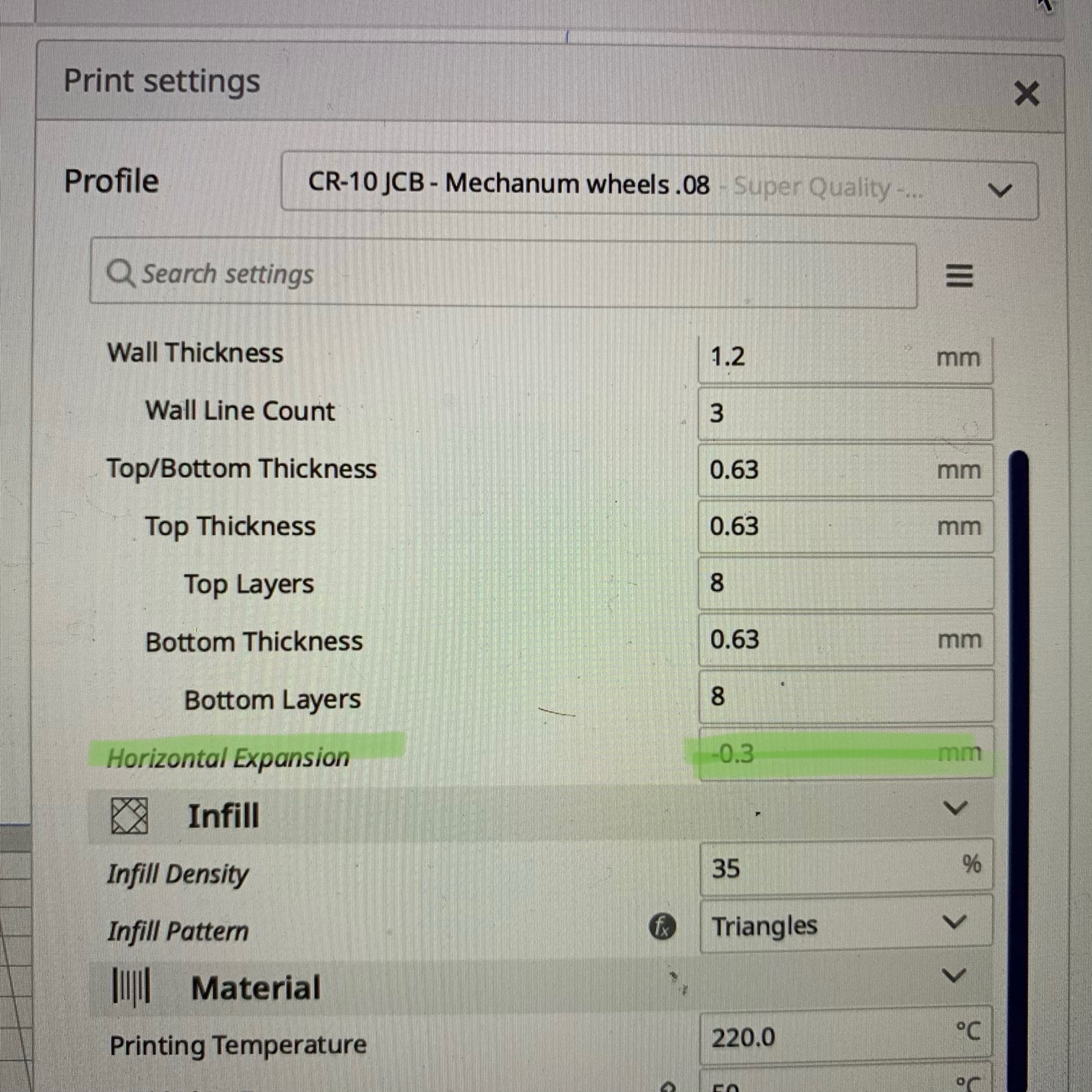

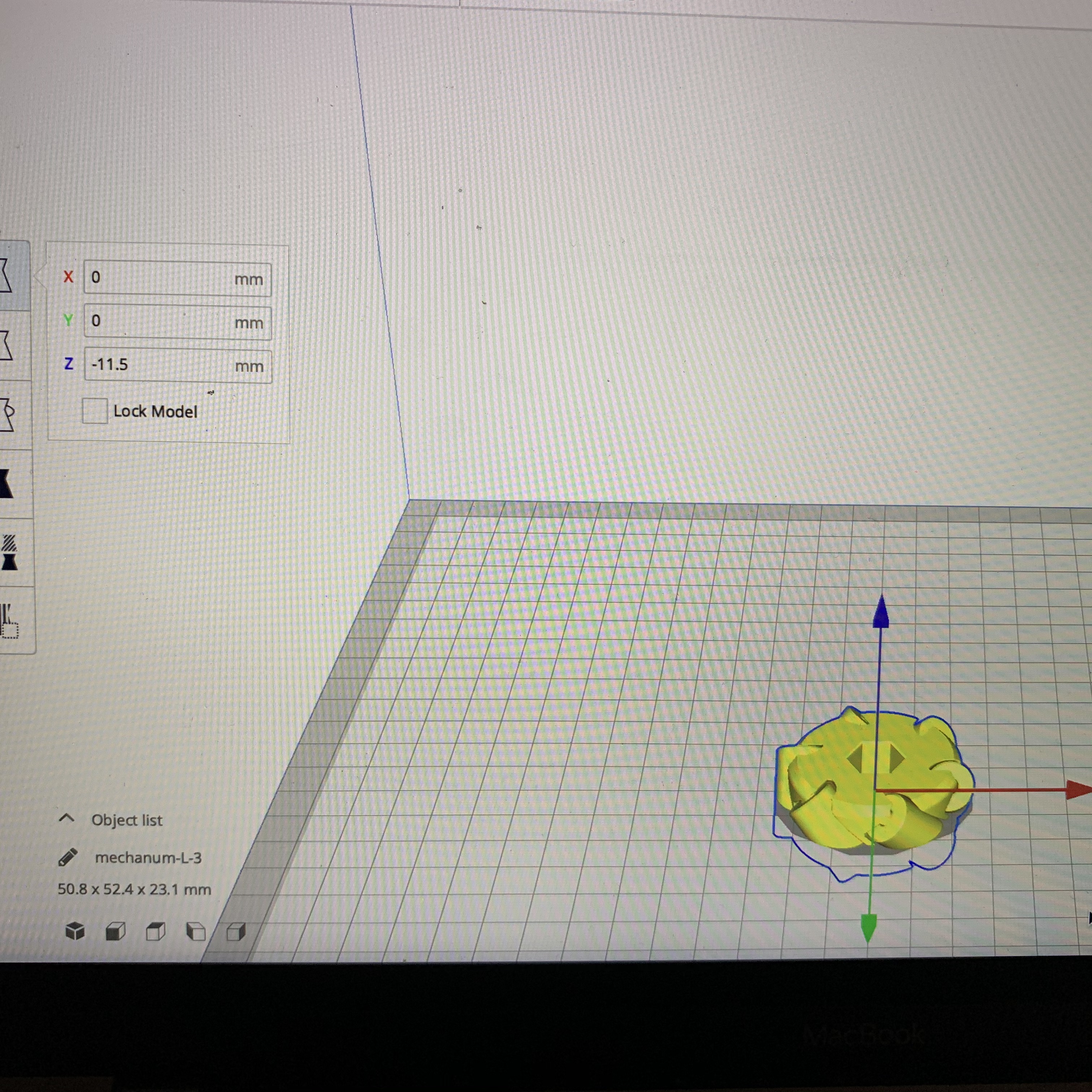

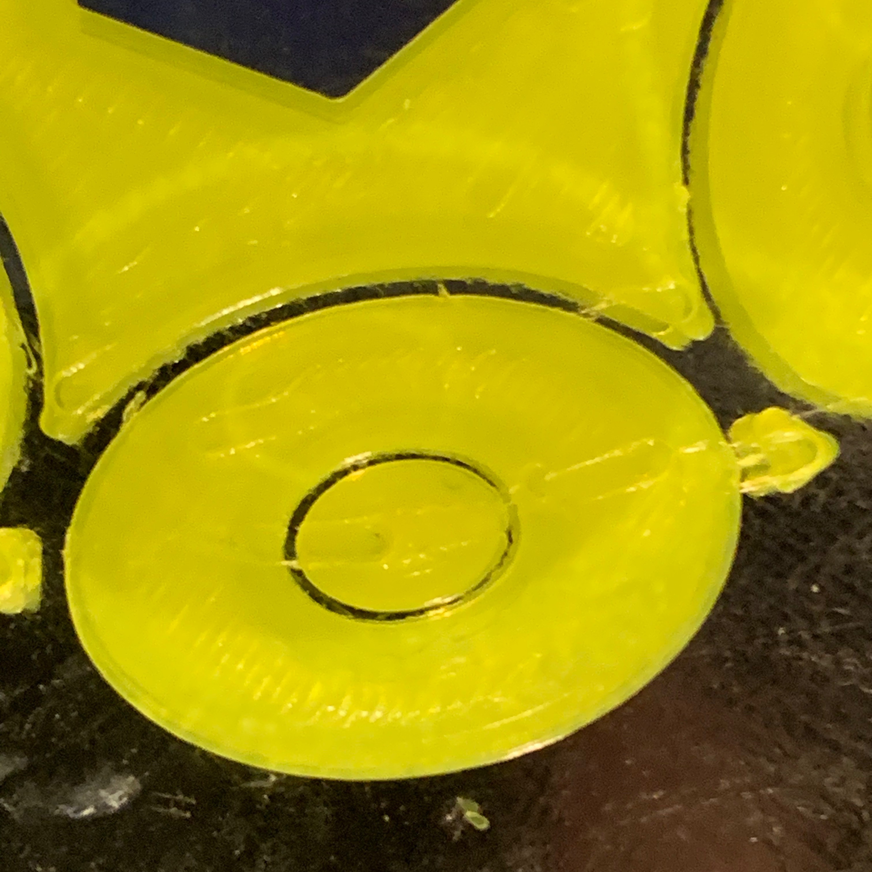

For anyone using Cura to slice, we had success using the Horizontal Expansion setting to reduce the size of the polygons, increasing the clearance. A value of -0.3 gives a fair amount of play and makes it free spinning off the printer. I think that’s about the most I would open it up. It may be a little too loose, even. Some may want them to fit more closely, so values in the range of -0.3 to -0.05 should work, depending on your settings+filament. We also dropped the model below the plate and printed a couple layers from across the middle to check for clearance before committing to a full print. (See photos below.)

I used Cura and Horizontal Expansion of -.1 to print on my Ender 3 and they were pretty much free spinning off the bed. The most difficult part was trying to get the first layers to stick to the bed. I had to lower my nozzle closer to the bed than I originally had it to keep the PLA from warping and popping free after a few layers. I printed a few on Prusa MK3 as well without adjusting settings and they were much harder to get spinning, but eventually did spin. They seem to be working great in limited testing (we just decided to use them last week :frowning: )
