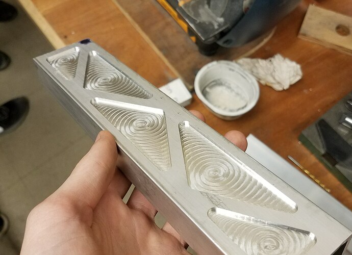

Creating some fixtures for 2" x 1" tubing cuts may be worthwhile. Possibly 1" x 1" tubing as well. Likely as simple as an end-stop at a known reference and some vices. Mostly just drilling holes, butsometimes pocketing as well.
Sheet metal gussets and mounting brackets are popular in FRC design, but the limited build volume of the PCNC 1100 may limit your ability to make larger ones of these. I would still prepare what you can for sheet and thin plate work.
