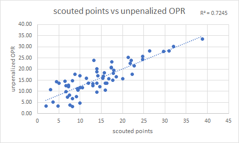

Just to show why this doesn’t work so well, let’s look at unpenalized OPR as a reference point to determine if OPR or your qualitative scouting is a superior methodology. Here are graphs of OPR, holistic rating points, and scouted points plotted against unpenalized OPR:
If you just look at the correlations, it would seem that OPR is a much superior metric than scouted points or your qualitative ratings. Similar to your analysis though, this isn’t a fair comparison, because OPR and unpenalized OPR are not independently derived.
Basically what I’m saying is that in order to effectively compare two datasets to determine which one is superior (in your case, OPR and your team’s qualitative scouting) you need an unbiased third dataset to reference. If another team from mnmi has scouting data that they would be willing to share that would probably be the best source. Without something like that though, you can’t draw many useful conclusions about which methodology is superior.
