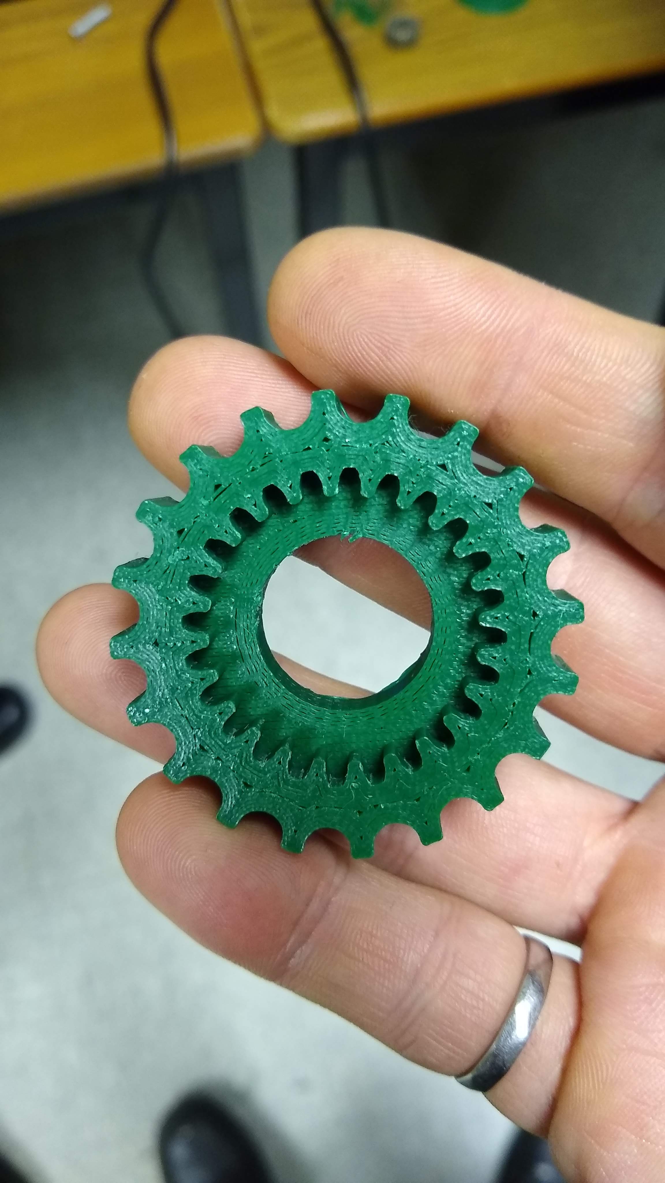

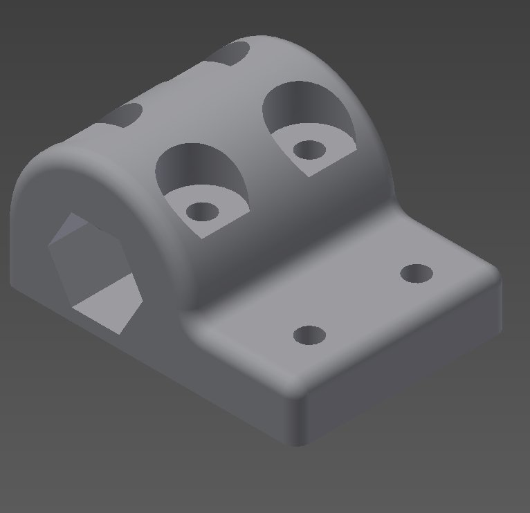

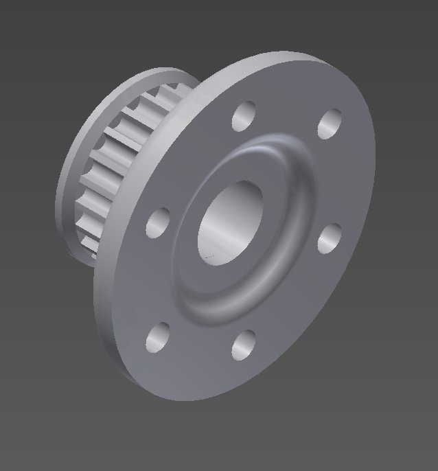

FWIW, we have had good luck using 3D parts in high load situations, as long as the amount of plastic under load is minimized (close to metal supports). For mating to a 1/2 hex, we used a mcmaster tube insert (part 9063T33), and also mating to standard hubs. Pictures of the 3D parts for both attached. Neither failed in competitions.
What is the second part?

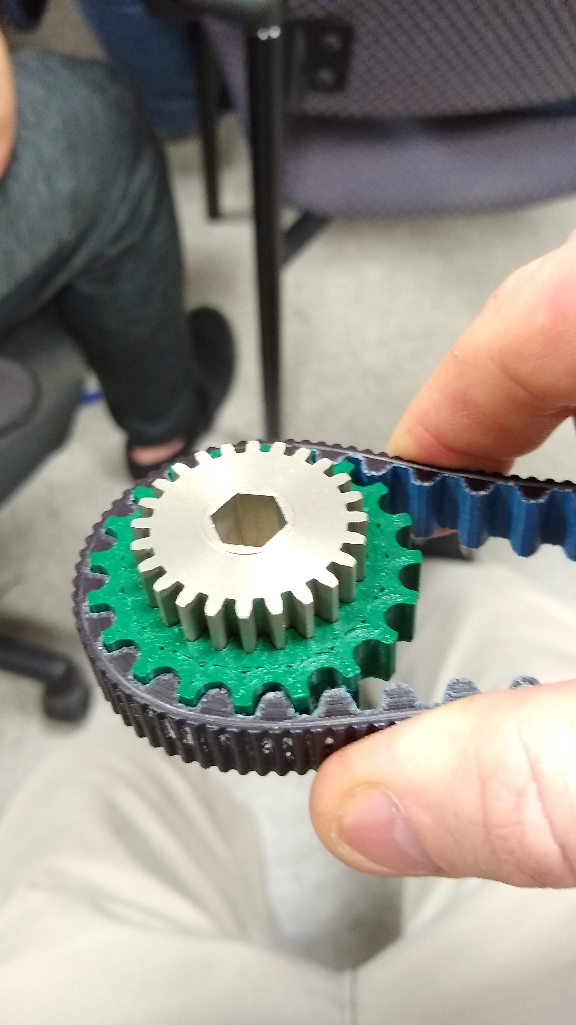

We haven’t used them in competition, but in 2019 we had good prototyping results with 3D printing drive pulleys around a small hex bore gear.
The second part was used to actuate a lever arm. The arm bolted to the 3D part using the 6 mounting points. The mcmaster hex tube was slipped into the bore, and then the whole assembly was slipped over a 1/2 hex bore. An initial 3D part design slipped directly over a 1/2 bore, but it failed (stripped). Using the mcmaster insert fixed that.

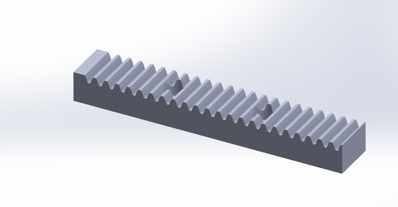

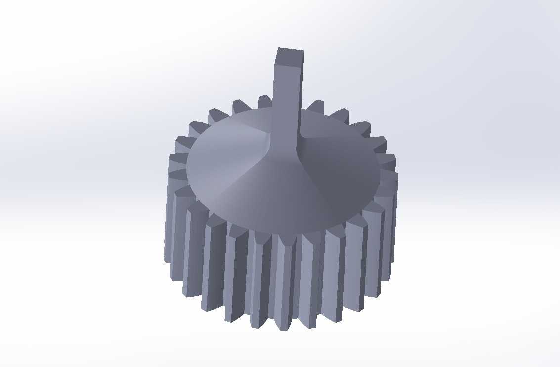

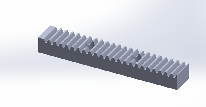

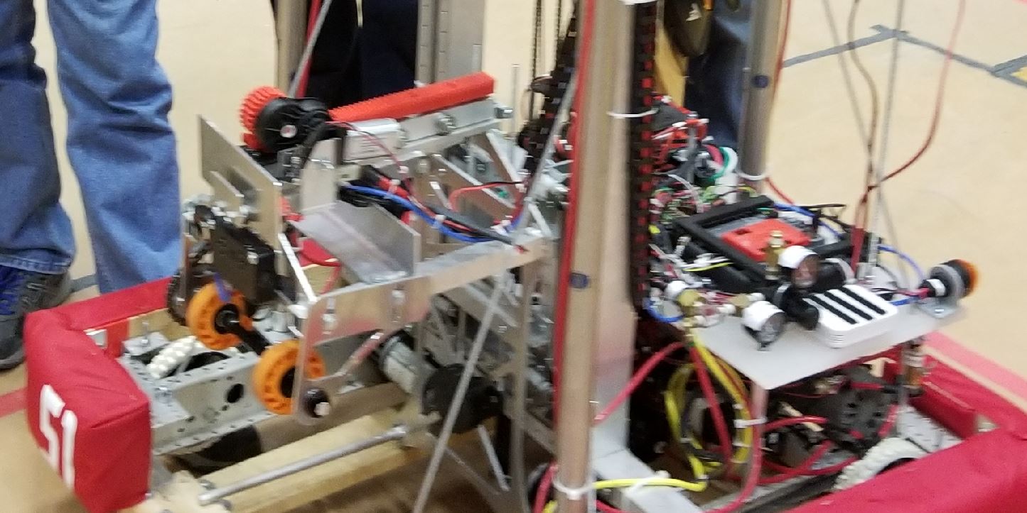

We did this on 5142 for 2019 using the Bosch Seat Motor. We use Marked Forge chopped nylon Onyx now for the gear, but for that season we used PLA at 100% fill it held up very well and was a light load. the shaft would break with PLA when mishandled in shipping but for the contests we never broke one. This drove out hatch device out at various lengths very accurately.
The rack was printed twice and matched end to end to provide stopping on the end point.
We set the encoder to be analog and triggered it in the program that way. We only used one limit switch on the retract to zerorize the encoder, by doing this we had the arm extend accurately each time. We were very satisfied wit the performance of the motor and the gear/rack system
