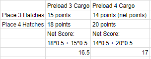

Game Theory and Hatch Panels
If an alliance has a 50% chance of getting 4 hatch panels instead of 3, then should an alliance preload 3 or 4 cargo? We can use game theory to determine this. If we make the following chart:
We see that is seems that there are no downsides to pre-loading another ball, however, this chart does not account for 2 things. The first is that by preloading a cargo and not scoring the hatch devalues a future cycle. Also, assuming that a robot is capable of scoring a cargo ball instead of a Hatch, then 4 cycles can still be valuable. Our table becomes the following:
By adjusting our percentages, we can find using a similar chart that if there is an equal outcome for an alliance able to score the 4th hatch 33% of the time. Thus, if an alliance has a 33% or higher chance, they should go for the 4th cargo piece.
There are definitely different values one can apply to the above algorithm, so do your own analysis and determine what the probabilities are for your own team.
