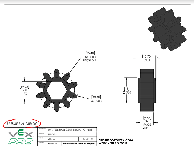

Does anyone know the pressure angle of Vex 10DP gears, specifically # 217-8036?
They list the pressure angle of their 20DP gears (14.5 degrees) and 32 DP (20 degrees) but not the 10 DP.
Pressure angle: 20°. Says so right there on the engineering drawing.
