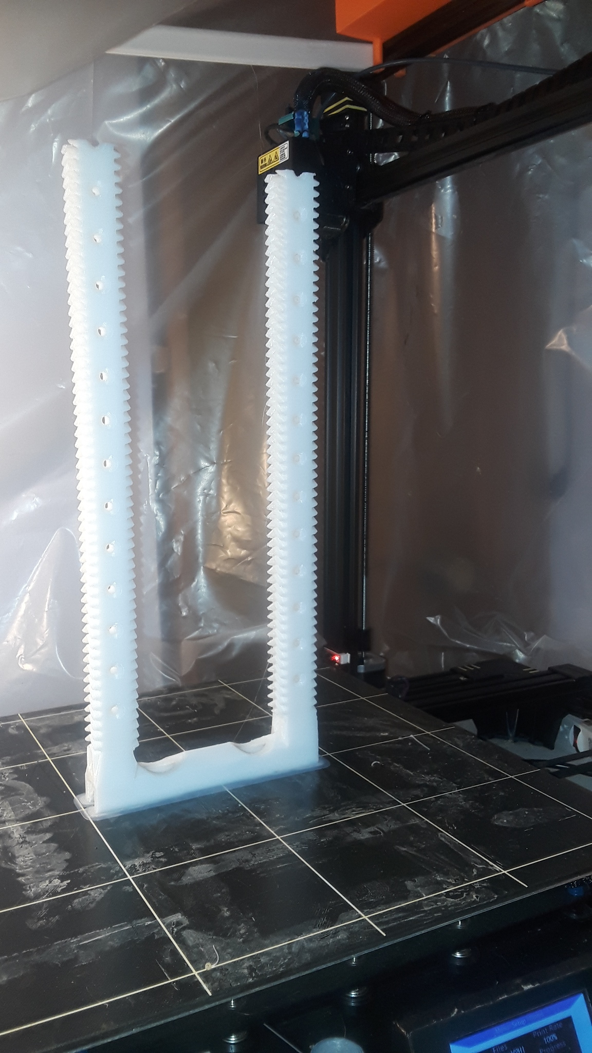

Printing tall
Needed to add a little to the twin double rack so I stood it up about 415mm tall (16.3 in)
very impressive, what material?
HIPS. .8 nozzle .32 layer height .88 outside perimeter width up to 1.5 inside perimeter width governed at 16.5 mm3/sec for max extrusion rate
