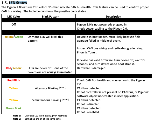

Our Pigeon 2 shows up in the tuner as version 22.6.1.0. Both lights are alternating yellow.

Pigeon 2 status lights are documented here.
