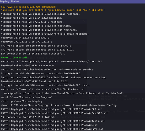

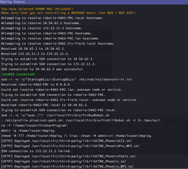

My team is trying to start using PathWeaver, I’m having a problem with the code deployed from the System Id Tool. In the deploy log, it says “SSH connection to 172.22.11.2 failed”. Also, the RioLog in VS Code says:
*********** Robot program starting **********
  • Camera Server Library Not Found
  • NT: could not open persistent file ‘/home/lvuser/networktables.json’: No such file or directory
  • NT: Listening on NT3 port 1735, NT4 port 5810
  • Initializing logger
  • Read JSON
  • Setup motors
  • Setup SPARK MAX (Brushed)
I have already updated my software, Roborio, and SparkMax’s to the latest version (2023). I also tried using a blank template of code on the Roborio, but it made no difference.
Capture2
There’s a known issue using the kickoff release of sysid with Spark Max controllers. It will be fixed in the next release (expected today or tomorrow).
Ok, thank you. Ill try it again then.
